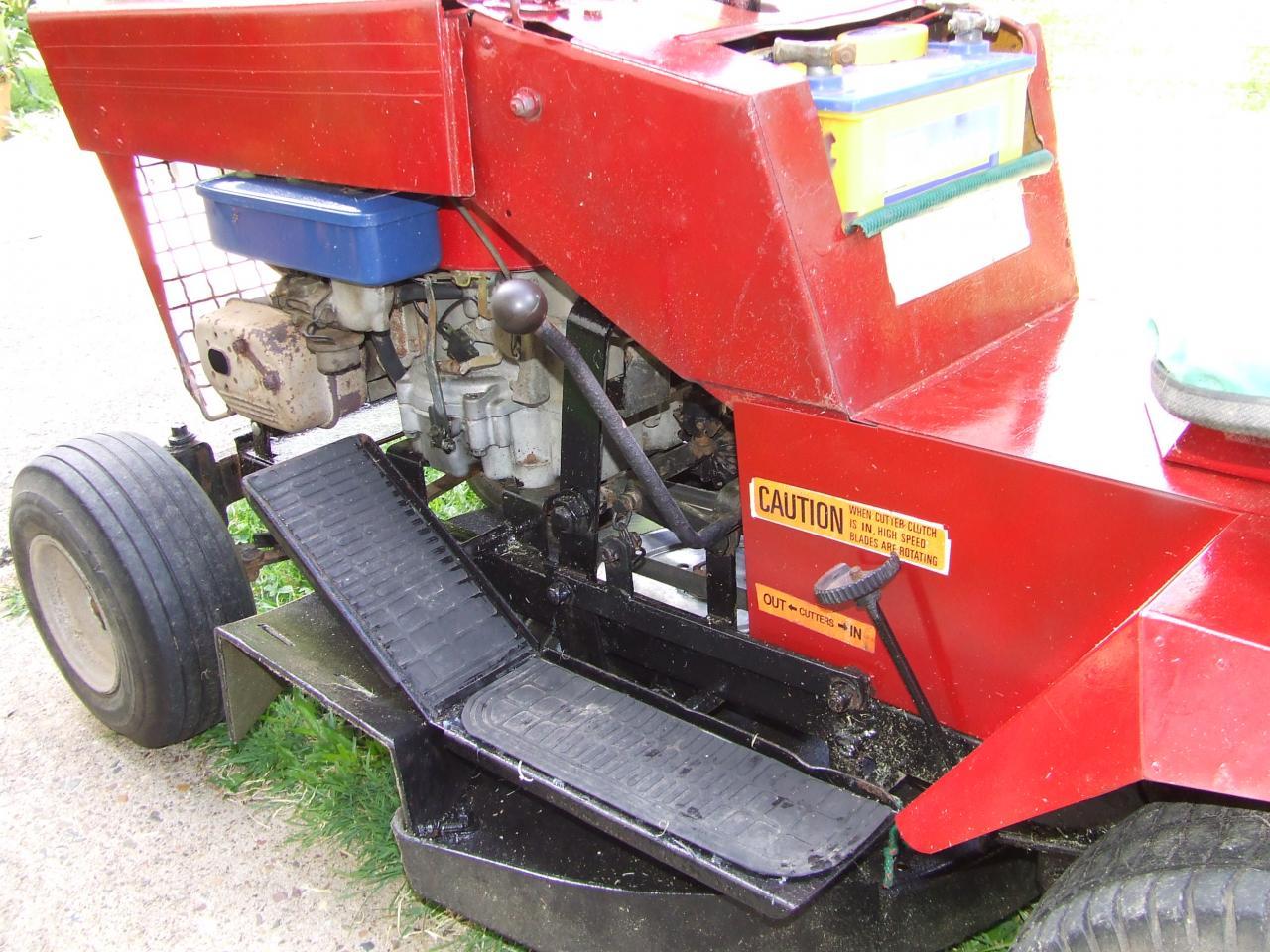

Posts: 6,926 Likes: 11
I've changed the caption Keith, but I'd like to know what model Greenfield it is if you or anyone else can tell me. It appears to have a cutter clutch that works by tightening the cutter belt, and I haven't seen that on a Greenfield before.
Joined: Sep 2003
Posts: 47
Hello Grumpy, I only have one other pic of that Greenfield. Can't actually tell what model it is because it has been painted red, maybe to make it go faster, and it has a Honda engine. It appears to be a later model 11,large battery cowling, later ![[Linked Image]](https://www.outdoorking-forum.com.au/forum/uploads/usergals/2011/10/full-924-3732-park_brake_2.jpg) model seat arrangement. I think at the time the chap said it had a few mods but it was an 11. Cheers Keith.
Thanks Keith. That seems to tidy up the open issues, so I'll close this thread.
