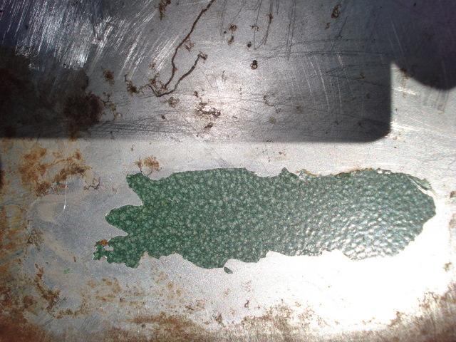

Had the base of my 160cc New Utility in the vat for electric soda cleaning.
Scraping off a top layer of paint revealed a decal at the rear of the deck.
I managed to peel this off and underneath was the original paint which appears to be a dark green Hammertone type stuff. Is this paint available? We do have a couple of paint places in our village here. One, I know, sells White Knight paint.

There has been a fair bit of research into the correct colours,but seeing as there really has been no records of colours kept,and colours were changed from model to model.I have read somewhere that the best hammertone colour match has come from a white king spray can.What most people (myself included) have done is just found a colour that they liked and what they think is close and use that.Unfortunately for me I can't get them in hammertone.I just don't want to use spray cans.

That paint looks like the standard Victa green hammertone.
The closest match is 'Galmet' brand Avocado Green. Which they do not produce anymore but it can be mixed as long as your paint store has the formula.

Hi Stationary, re your paint colour....it looks very much like the Avocado Hammertone Green as is alleged to have been used on the Model 5 Victa 18 Special and most others of that period. wink
Stationary, here is the place in Bundaberg QLD that sells Victa Model 5 Avocado Green Hammertone....
Jeff's Paint Place: Tel: (07) 41516133 or email

However I have managed to get a local supplier,(finally), to source some "Hammerite" Dark Green from Adelaide.
And painting will proceed when it stops raining....... both on the New Utility (Hammerite) and the Thomas Green cylinder mower (John Deere Green).
OH! Nearly forgot. This Hammerite is brushed on,(cant use it with a spray gun).
