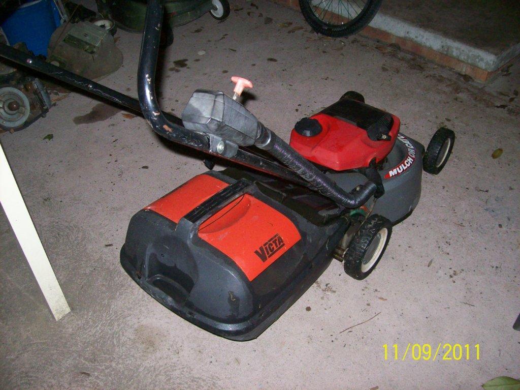

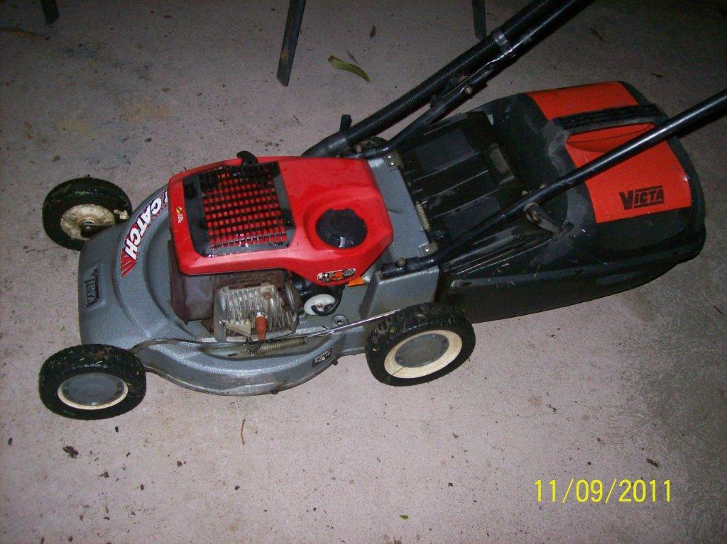

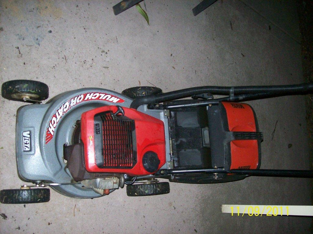

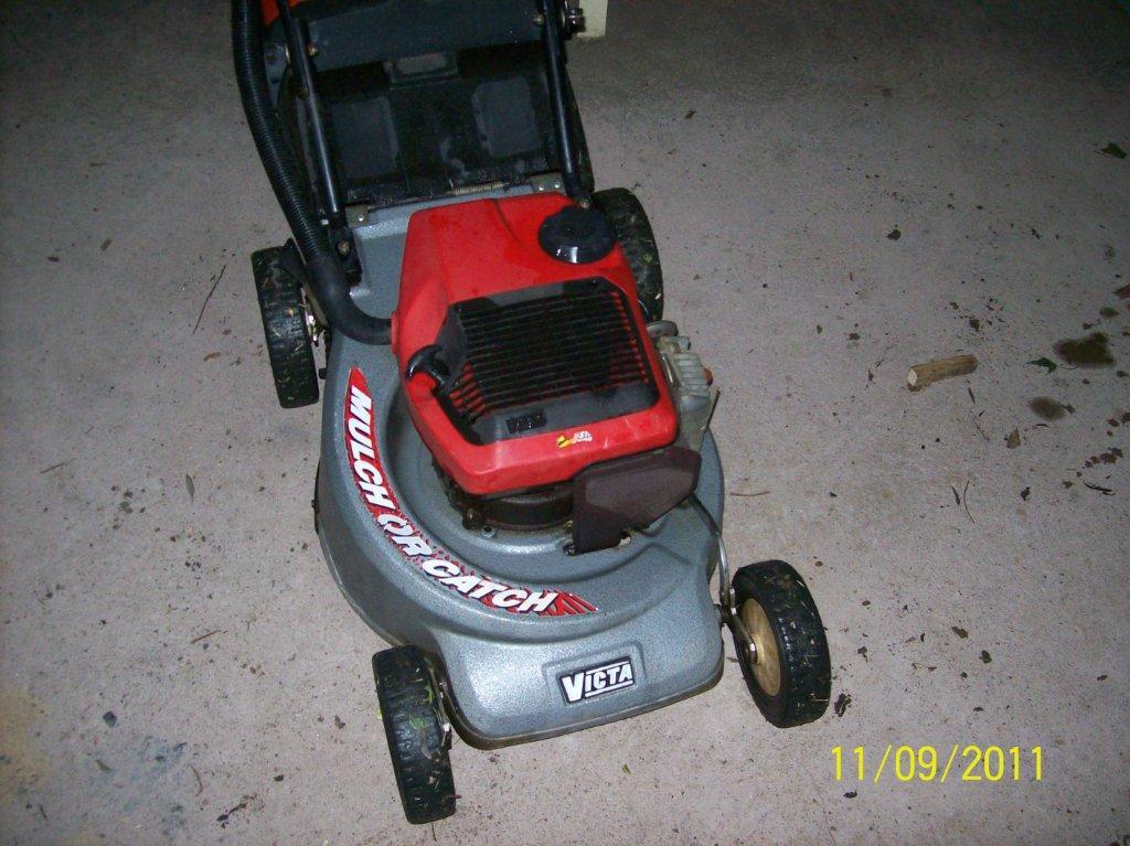

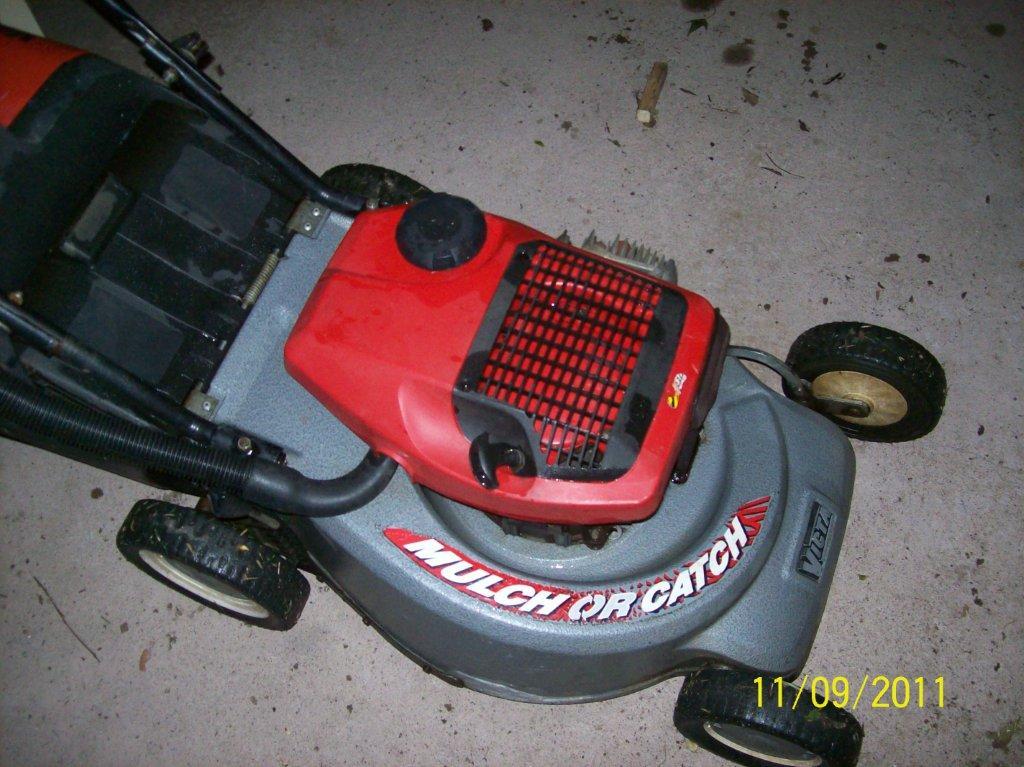

Here we have one of the mowers that I picked up in the hard rubbish collection from Moruya on the coast.All it needed was a carby clean and a fresh batch of fuel.Then with only one pull away it went.Even mowed the back yard with it.Was very happy with it.Now I've decided to keep it.I think it's in better condition than the one I mow the lawns with.I do think that it may need the bottom bearings done.I'll put the you tube link up.Just have a listen when it stops.Sounds like a bearing knock.Let me know what you think.Here are some pictures.
Also would any body know what model it would be called? The engine was made in 1996.

That is a Mulch or Catch, that's what they were called, later they called them Mulch'n'Catch
I cant hear any noise out of the ordinary, Looks good mate smile would have fallen under the commando or corvette category probably.
Thanks guys.Yeah the noise didn't seem to come out as much,maybe when you guys are here I show you with your owns ears.Stands out a little more.
Best way to check if thee is any movement in the blade plate if you hold it and rock it against the crank bearings it will show some sort of play if there is a problem smile

Sound good to me.
Put 4 blades on it and the cut will be far better.

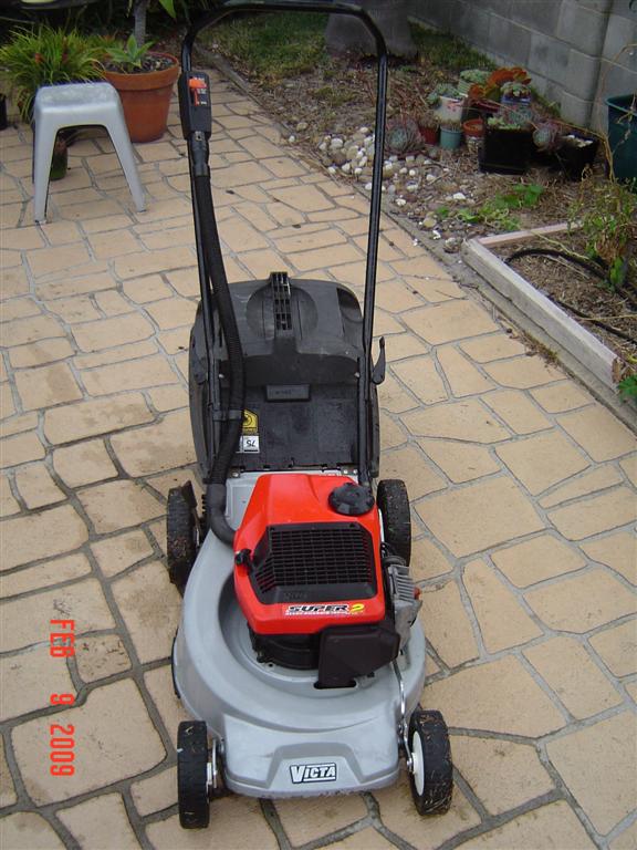

Here is mine that I picked up off ebay 2 years ago for $46.00 with a electric mulcher. I was sold as not going. I cleaned the carby and it started first pull!.
Mine maybe a slightly later model.
I think they are a good thing those models. The alloy base but then the catcher from the steel base which is easy to find/replace.
Easy $180 mowers second hand.
The bottom one is earlier. The ones of them ive seen have had the earlier 'twin grip saftey' catcher. Some even with a steel door.
