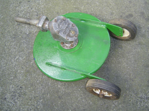

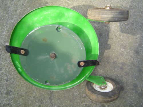

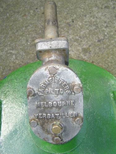

Odd little thing popped up on Ebay, Anyone able to ID it? Here is what it has: VICTA 18 This old lawn mower attachment came to me from a large lot of old parts etc that someone had accumulated. The previous owner did not know exactly what it did or how it attatched, but said he had not seen one before. He told me it was an attachment for a 1950s Victa 18. It has Farmfitters P/Ltd Melbourne Versatiller, on the front . I do not know any more about this item, but I am sure collectors of old Victa 18s etc will know. ![[Linked Image]](https://www.outdoorking-forum.com.au/forum/uploads/usergals/2011/08/full-5013-2503-kgrhqeokjke4ofchnoboulfqio48_12.jpg) ![[Linked Image]](https://www.outdoorking-forum.com.au/forum/uploads/usergals/2011/08/full-5013-2504-kgrhquoki8e5krbyqeboulof_w48_12.jpg) ![[Linked Image]](https://www.outdoorking-forum.com.au/forum/uploads/usergals/2011/08/full-5013-2505-kgrhqyokpue4kq_blwsboulylbdq48_12.jpg) As the seller has also mentioned any info on this would be appriciated, if we can work something out about it here, I'm sure we can pass the info on to help them! Personally, I doubt this is the fabled edger attachment that was never made, the design and wheels seem wrong, but I'm sure somone somwherte must have some idea what this is?

That attachment wouldn't be for a VICTA, the axle plates are off a alex Graham mower that had a villiers mark 3 engine, anyway that attachment would fit on the end of a tiller. Imagine a tiller that had an output shaft that connects to a tiller attachment for ploughing and you can detach it and fit the slasher attachment (the eBay item) and off you go. The only farm equipment VICTA was involved with was stationary 2 stroke engines and insecticide sprayer that was a model 2a converted into a mobile pump.So basically it's an attachment for a Rotary hoe.
Posts: 2,738 Likes: 6
I had a feeling it was more something like that, Especially since the plate also says "Versa Tiller" whitch confirms the idea it was from a rather versatile tiller!

Very similar to the Blitz attachment and also another whose name escapes me for the moment.
Would fit on a machine like the Whirlwind or the Masport with the front long arm...but I have not seen that particular name before
Would fit on a machine like the Whirlwind or the Masport with the front long arm...but I have not seen that particular name before Im tipping thats exactly what it fits. Looks right where the tube goes on the gearbox.

Its 400mm wide, so 16" and its got the square drive down inside the tube which would suggest it fits the early masport and whirlwind. (perhaps the versatiller was made by masport under licence same as the whirlwind)
Im still not sure if i want it Ty. Need it?? definatley not. Should it fit the tiller as i suspect it would be a great show piece. However a great slasher it will never be. I could not imagine pushing the thing about with any great comfort, since there are a couple of bigbobs and a Deutcher there to use i doubt it would ever be used. We allready have an old Whirlwind in the shed, its got a 5.5hp horizontal shaft honda on it and ergonomically its the worst thing in the world to push. Have since found out why, its meant to have a Mk10 or 12 Villers on it and a 2 speed gearbox. Walking along behind it would probably be Ok, but pusing it is like hell on earth.

Yes the item fits onto a garden tiller,pull tynes off put mower attachment on. I have the tiller will upload photo when i work out how to.

Yep, a Farmfitters' Versatiller rotary attachment. Quite rare. ![[Linked Image]](https://www.outdoorking-forum.com.au/forum/uploads/usergals/2016/02/full-7392-26935-1958_2015_ebay_uk.jpg)
