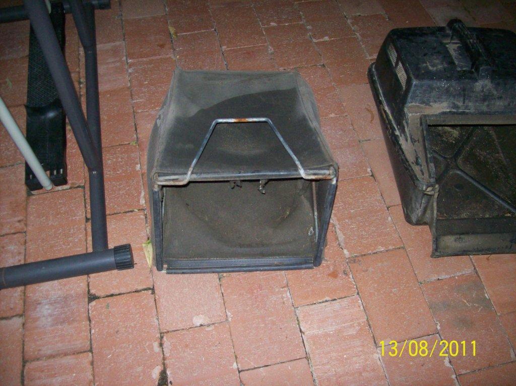

This is for a Honda, catcher bag thingie.Does anybody need one? I have no use at all for this.I don't have a Honda.
