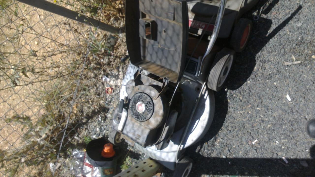

Just to add a little more detail, I recently spotted one with the cover, I have not bought it, but I might yet.
The brackets will need dome repairs, but it's all there, A little newer than my widecut I believe.
