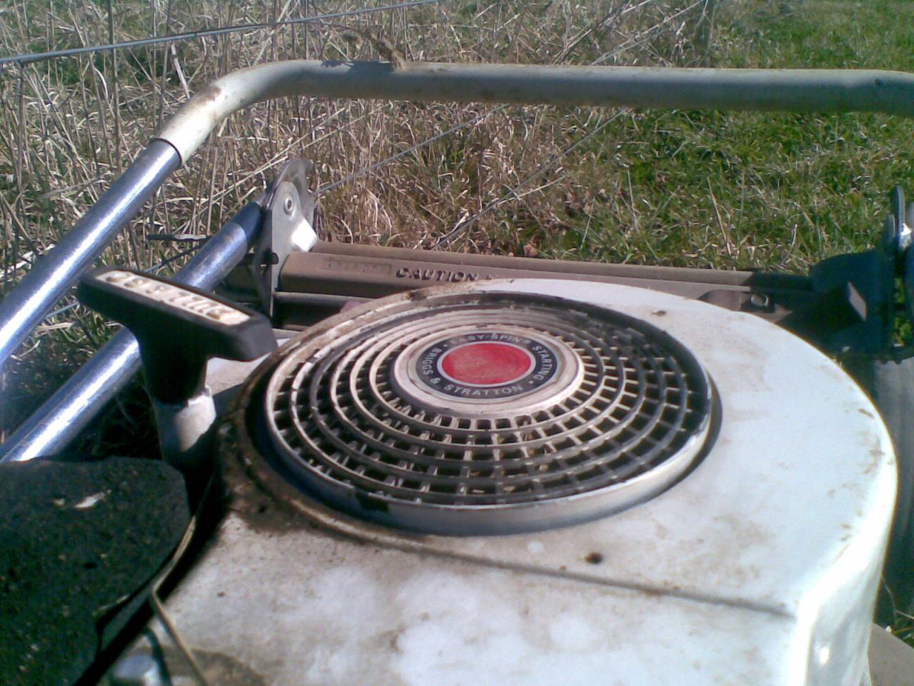

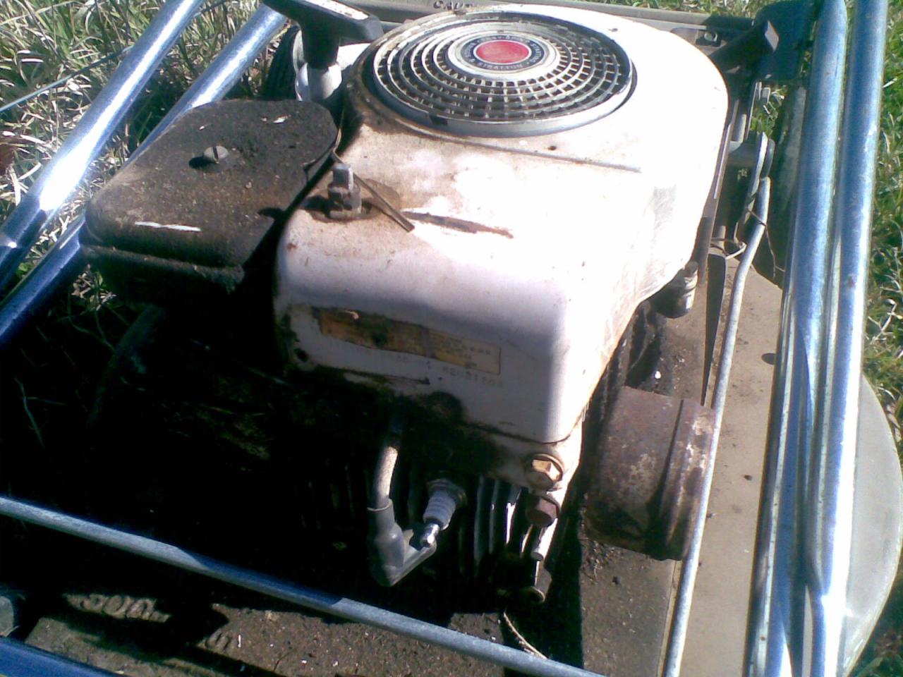

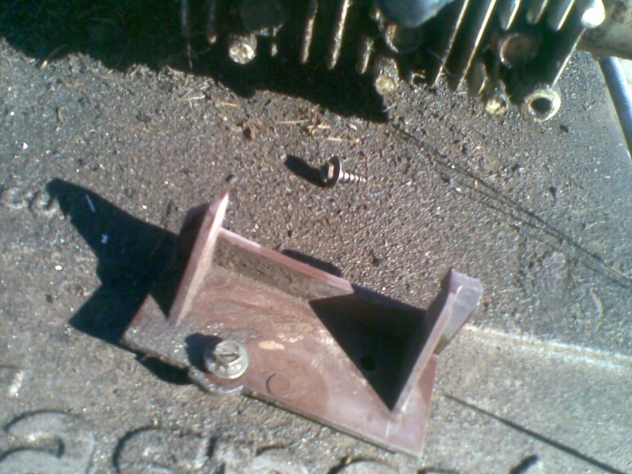

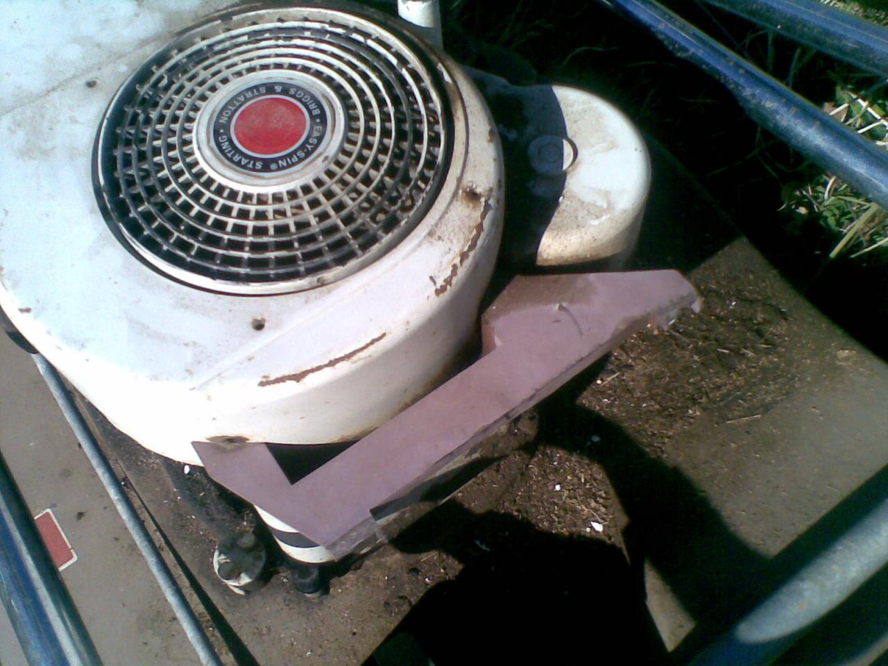

I Picked up this masport recently, It caught my eye due to the more unusual engine. The engine looks quite small, and a little different around the cowl, it also has a plastic, slightly domed spinning grid on top. After emoving a bracket that covered up most of the number i found: 110908 0538-01 82031204 ![[Linked Image]](https://www.outdoorking-forum.com.au/forum/uploads/usergals/2011/07/full-5013-2137-30072011001.jpg) ![[Linked Image]](https://www.outdoorking-forum.com.au/forum/uploads/usergals/2011/07/full-5013-2138-30072011002.jpg) ![[Linked Image]](https://www.outdoorking-forum.com.au/forum/uploads/usergals/2011/07/full-5013-2139-30072011003.jpg) ![[Linked Image]](https://www.outdoorking-forum.com.au/forum/uploads/usergals/2011/07/full-5013-2140-01082011002.jpg) ![[Linked Image]](https://www.outdoorking-forum.com.au/forum/uploads/usergals/2011/07/full-5013-2141-01082011001.jpg) ![[Linked Image]](https://www.outdoorking-forum.com.au/forum/uploads/usergals/2011/07/full-5013-2142-30072011.jpg) ![[Linked Image]](https://www.outdoorking-forum.com.au/forum/uploads/usergals/2011/07/full-5013-2143-01082011.jpg) Quite an interesting little one, Anyone know what the odd brackets on the back, and front (removed to read number) of the engine are for?

I have had a look at the engines manual for this one, on the Briggs site, and I cant see those brackets in there, so they must have been added by Maspoort, or the previos owner

I know that the bolt protruding up through the lower left corner of the cowl is where a knob should go for the throttle, these early Masports had the throttle contrill on the engine, not on the handles.

It is 11 cubic inch, where the usual size for mower engines at that time was 9 cubic inch, so it would have been 3.5 to 4 hp. It had the automatic choke version of the PulsaJet, and the normal (for March 1982) vertical pull starter. I can't tell whether it had points or Magnetron ignition - that was just about the time Briggs changed over.
Those little brackets seem to be injection moulded zinc, so they were made by a serious manufacturer, they aren't "the tenant's improvements", but they are horribly ugly and the installation is very crude. I don't believe Briggs would ever have screwed such a crappy bracket on with self-tappers right across the identification number. They wouldn't have been pleased with Masport doing it either, but I don't suppose they could have stopped them from doing it. Alternatively they may have been parts of some aftermarket kit - perhaps they were part of a device that would make it manufacture its own fuel from water and dog turds, while increasing its power by 600 percent.

The brackets felt plastic, But i didnt pay them all that much attention, I will see if i can work that out tonight.
Whatever they were made to do, they are not doing it now, plus they are broken in plces, so i will remove them, and try to find a way to make the holes less noticeable.
I Will check the ignition on it, I supoect it may be mechanical, as from what i have noticed, Briggs advertised the early electronic ignitions on the centre of the spin-frid, while this one has the ols Easy Spin sticker.

The brackets could as easily be plastic mouldings as zinc mouldings Ty, I just noticed that they were injection moulded. Maybe they used to hold up an ornamental hat that sat up above the center of the mower - I'm visualising a Carmen Miranda type chapeau with lots and lots of pieces of fruit, maybe 18" high? It would look a lot better than that monstrosity mower with the tailfins that keeps turning up here.

Not sure what the plastic brackets were for. I had one here with the remanants of the bracket on it.
The 11ci was a 4HP. Pretty much everything except the coil is different to the 9ci. Tank and carb ar the same but the jet is different. It steel, the 3.5 and 3 hp have a brass one. The control on the engine was because of the way the handle folds i would say. have seen a few 9 series motors with a similar type thing.

Those mowers use to have a plastic cover that went over the top of the mower engine. Those brackets on the rear of the motor are the remains of the cover, they use to tilt back to allow access to the motor. They had brown plastic covers on those brown 460 series mowers and black plastic covers on the earlier blue 8-04 model mowers. I will see if I can upload a picture of one of them. Over here in NZ all of the 1970's - 1980's mowers with those 3.5hp and 4hp motors had the engine control on the motor - it was standard. Also a company called lawmnmaster here in NZ had a similar cover over the engine with controls on the motor.

Hi Ty Here is a pic of a Lawnmaster mower that I have with the plastic cover over then engine the masports are pretty much the same. They had the covers as part of the top of the rage additions to make them look better as far I know there was no benefits in the covers other than making the mowers look good. I will try to get some better pics when I can. Cheers ![[Linked Image]](https://www.outdoorking-forum.com.au/forum/uploads/usergals/2011/08/full-2975-2268-mower1.jpg)
