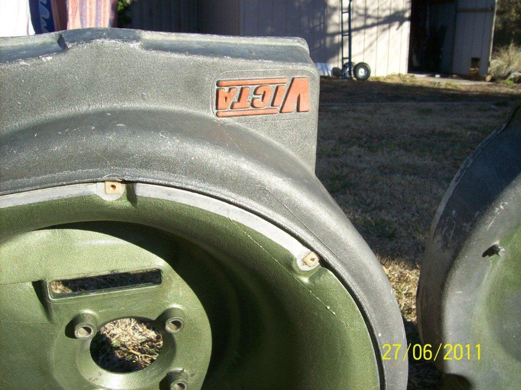

Hi all picked up another VC today I believe it maybe the model before the one I have now that I'm restoring.Catcher is better than the last one,only the bottom edge is missing.If somebody has a catcher that they are throwing out and has the front piece that is a similar shape.Could be interested in a cut out of the bit.Also does any know where I could get the the proper starter for this mower.I have put some pictures up.It's not the pull starter.Not sure what they call them.Very new to restoring these ones.Also planning to restore this one as well.Engine turns over on this one.Might be in the need for a cowl for this two,it does have some damage.

Seen this one there a few times, needs a fair bit of TLC, i can help with some parts, but that starter is the issue. It uses the Impulse starter, whitch, in itself is not to hard to get hold of, the one you want is the Trigger-Type Impulse Starter, Without the square bracket for mounting a cover.
Looks Like This on ots own:
The hard part is the cover that goes around this, time did not treat these covers well, and they are not easy to come by. Unlike older Victa's with the Impulse starter, the cover did not fit onto the starter itself, but the dress cowl of the mower, Looks like this:
I will see what conditions my cowls are in, the badge on this one is correct. also, with this mower, you should find it has the Series 70 MKI engine (Unless somone has fiddled) this has no decompression valve at all.
I can see your carby will need some attention, there is a guide on them in the manuals section, from here i can see the little plastic plug that goes in the end of the hole for the throttle shaft is missing, aside form that, she seems fairly sound.
I have an engine and the cowl lugs for you, Engine is $10 as discussed, ligs are free, if i do have a good cowl, I would like $5 for it, as they can be hard to come by without breaks (Dont know if i have a good white one though) i will see what else i can spare, i may have some more of the screws and so forth, witch you can have.
With the catcher, check if the broken one from the other VC-160 has the fill indicator intact, if so, put it in this one.
I will get that lot together for you, and i will see if i have a spare starter, however i know for sure i dont have a spare cover for the starter, as this just screws on top, i would sugest doing everything else, getting it running, and then fitting the cover when you can track one down.

Ok, so i have indeed a good base, it may need the catch flap swaped over, but the axles are sound, and the base is good.
I have also checked the engines, and i am very happy with one that is here, right make and generation, and holds good top and bottom compression, also has spark.
I will let you know when i have got what else i can together, and drop by some time this week.

OK, well i have just had a look around, there is certainly a good engine and base to match what you need.
The base will need the flap lifter handle and strap from your old base, and the lock lever from your handle bars, it has all axles, wheels etc. intact.
The engine will need to be cleaned up, and have a carby, decompression valve and muffler fitted.
I also have found a cowl, it is not perfect, but is better than the one on there. it has a small crack under the badge, though this is closed, and no parts are open or missing, and it has some damage around the first screw hole, as it does have some damage, it will not cost.
I also have the black cap for your air filter, and i am working on gathering the cowl screws, and any other useful little bits i can find.
Your mower was seen with either a black filter and handle lever, or the white set like the other mower, either is acceptable as original, if you want white, i will happily put the white set together and swap for your black set.
I have been digging around for impulse starters, but at this point i can only find the one with the brackets, it is possible to trim this one to fit under the cover, and it would be hard to spot the difference, so i will bring it by, and you can see what you think, and decide then.
I have a pair of damaged VC-160 catchers you can have to work with if you like, they need some definite repairs, but with these and what you have, you may be able to make something.
I will keep my eyes out for that surround for the starter as well, however with this one, you will need to be patient, as i said, these green surrounds are rare to find at all, let alone complete.
If you wanted to i can give you what you would need to convert it to a MKII or MKIII in the meantime, so it is complete, then it could be converted back later if you wanted.
To do this, it would need the cylinder changed to accept a decompression valve, deco valve fitted, and the zip starter put on top. you can then swap the cylinder back if you find the original starter set. this option would be acceptable for originality, as this was the only change made to the unit when they released the new model at the factory, and it would count as a true MKII.
To go all the way to MKIII, it is the same as above, however you would also need to change the height adjuster, rear axle, cowl, lock levers & lower handle bars.
