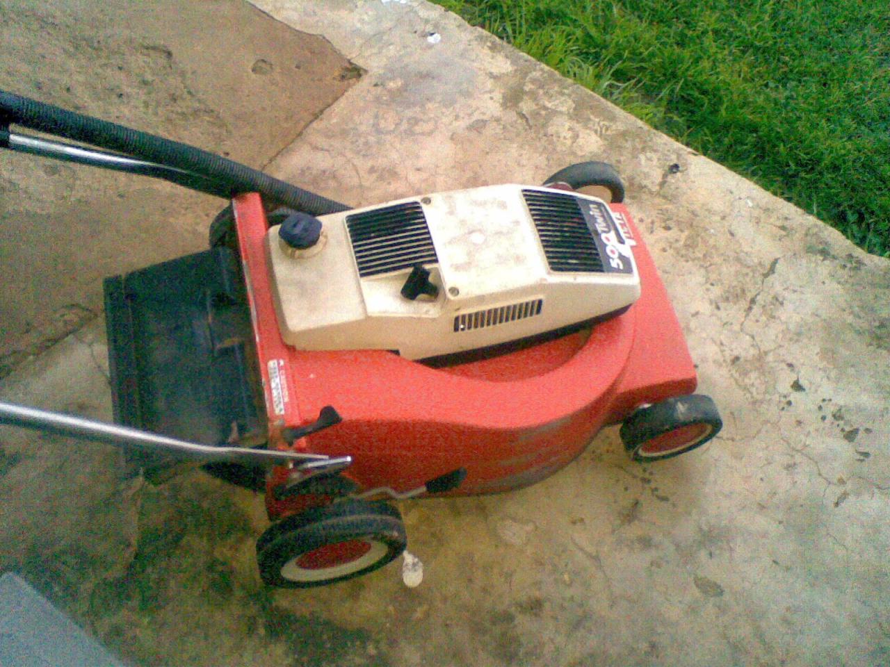

Hey guys,
i saw this mower in the classifieds so decided to grab it. All that was needed was a new carby primer section to get it running.
Checked the flywheel and pistons before i bought it and both are in great nick.
Now, a question, for most part the engine runs fine but now and then i might get an intermittent backfiring and a puff of smoke (this might happen every 3-4 seconds), would anyone have a clue as to what this may be, or is this part of the Twin normal running procedure?
(note, i have not really replaced the spark plugs/ reconditioned the carby but i will eventually get there just in case you guys think this might be the cause of the problem).
also, what kind of catcher am i looking for here as the mower has come without one.
[Linked Image from img101.imageshack.us]
Hi Johno, and congrats on a good score there mate. It looks in very good nick. You may find that Joe Carroll will advise you on a suitable catcher.
I have one catcher here for mine, they are oretty big for the size of the mower, I do belive however a catcher from a self proppeled silver streak may fit... I can confirm this later.
Joined: Jan 2010
Posts: 234
thanks mate, any ideas about the backfiring?
no such luck with the catcher, seems like a twin catcher is only used on a twin.
As with the backfiring I would begin with fully cleaning the carb out, as I have had a few with water in them give the sames symptoms.
Joined: Jan 2010
Posts: 234
ill do some maintenance and will let you know how it goes, thank Joe!
Joined: Jan 2010
Posts: 234
fully cleaned the carby and replaced the spark plugs ( i think both plugs have been there since the mower was new) and now she purrs away! ill try and take a vid of how she goes and post it up later.

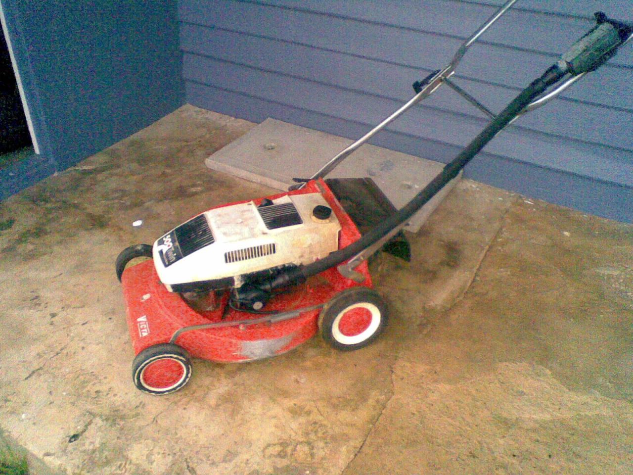

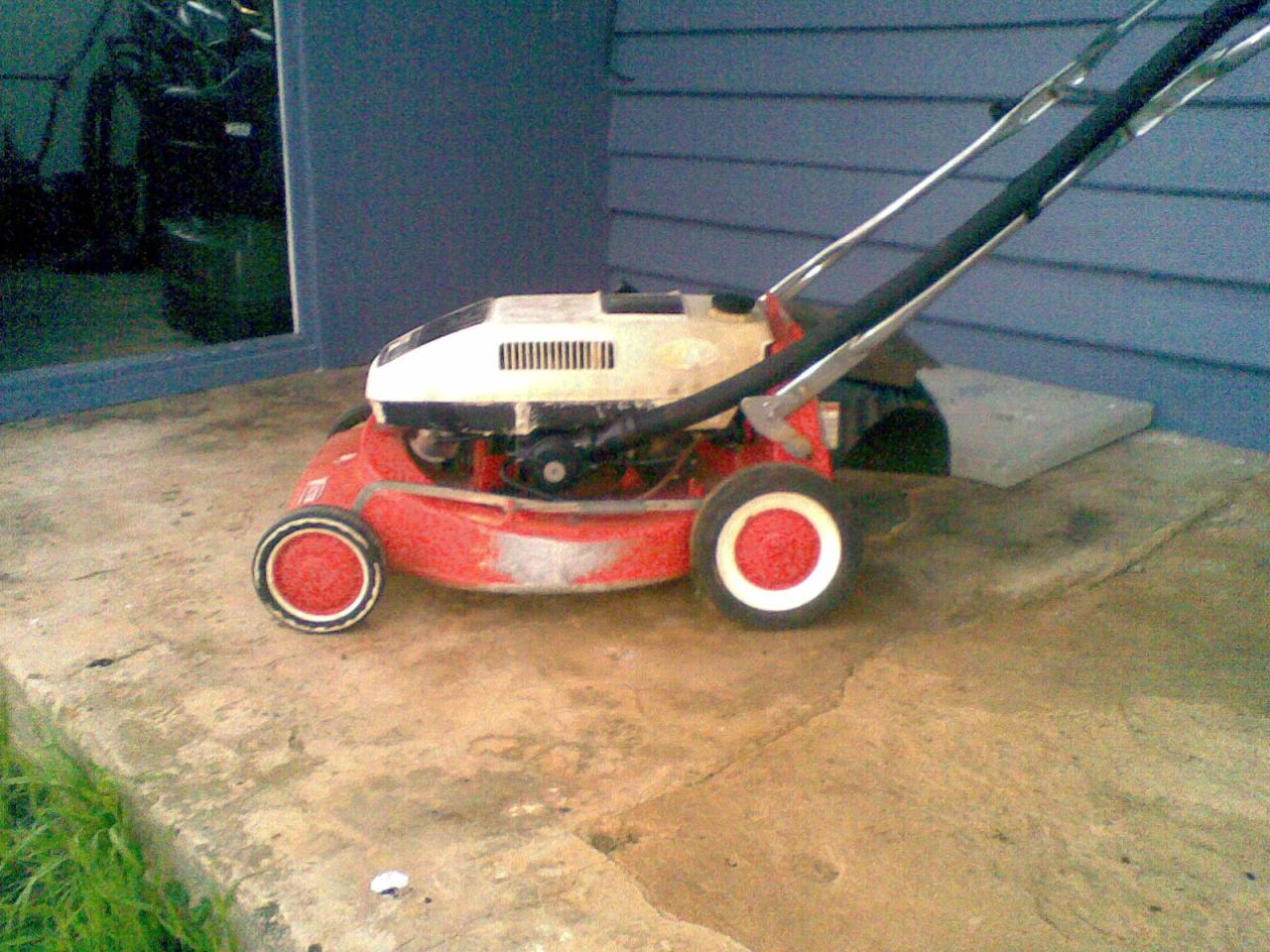

Hi Rodeobob, the back of these (and the whole base) is wider, while the flap is the usual size, the space to the side of the flap is greater, i have a couple of pics here that may help, i will try and get some better ones up soon if you like.[Linked Image]
It is a little hard to spot the difference in these pics, but i hope they help (i can also post a few pics of the catcher if you like.
