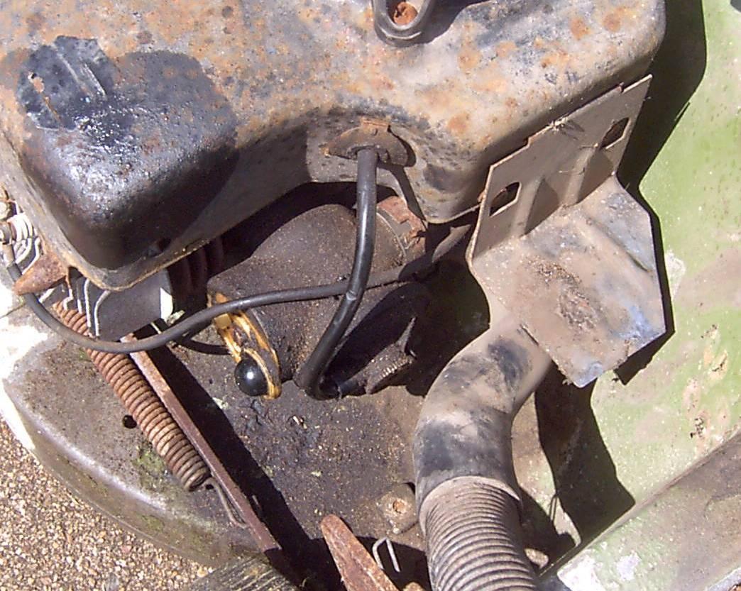

Hi to everyone ,i have a old mustang victa,im in need of how to adjust the throttle ,it runs almost full throttle ,have got manuals from library and can not figure out how to adjust throttle speed is it a L4 plastic carby?i have been on you tube but can not seem to find anything have aattached 2 photos of mower ,any ideas any body please[Linked Image]

gray #23247 27/04/11 08:39 AM
the big kink in the snorkel wont be helping matters. originally this would have had a primerless cap and had the carby mounted the other way around with the snorkel facing out to the left side.
you could try moving the throttle lever to the other side of the handle bar and cut a new hole in the cowling for the snorkel to run through.
if it turns out the cable is damaged one from a newer victa should fit.
gray #23465 11/05/11 10:17 AM
Yeah theres something wrong with that snorkle and the way the intake is setup.
They had them two ways.
The carb that way and the intake when along under the side of the motor then stepped up over the body and out the other side.
Or they had just the 90deg bend on the end with the carb facing the other way. (these rub on the tyre if left to hang and wear through and the engine sucks dirt/grass)
So i would suggest that you need a new snorkel and throttle cable off something else.
Or you could pull the carb etc off and flip it over. You will need to take the primer cap/face off and put it on upside down. Then see if you can sort out the throttle cable, if it is not damaged.
Only other issue would be the vacuum lines and the stop wires if they are the correct lengths to work the opposite way around.
