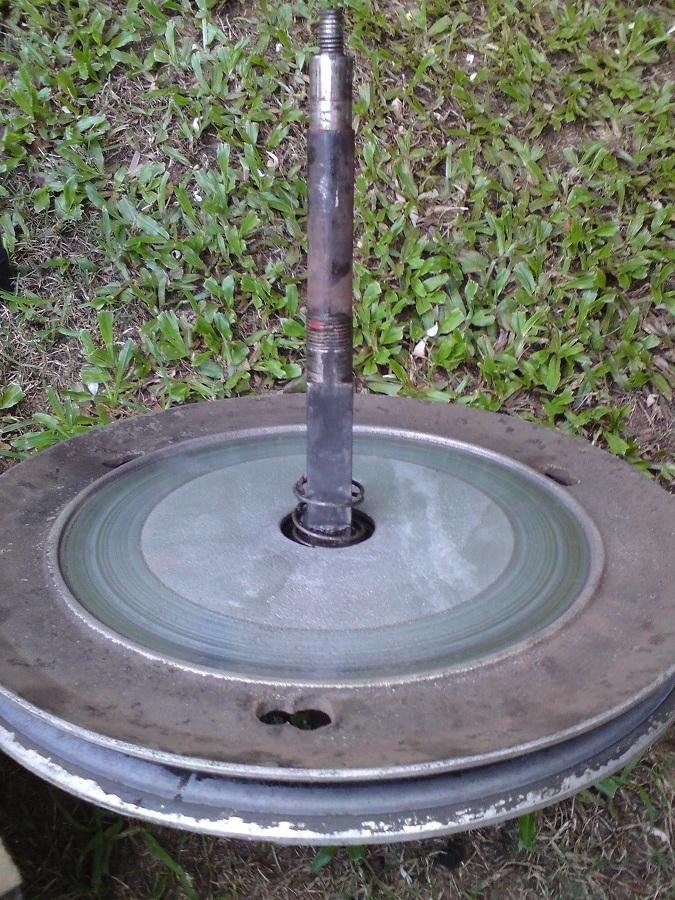

Hurcules stripped back

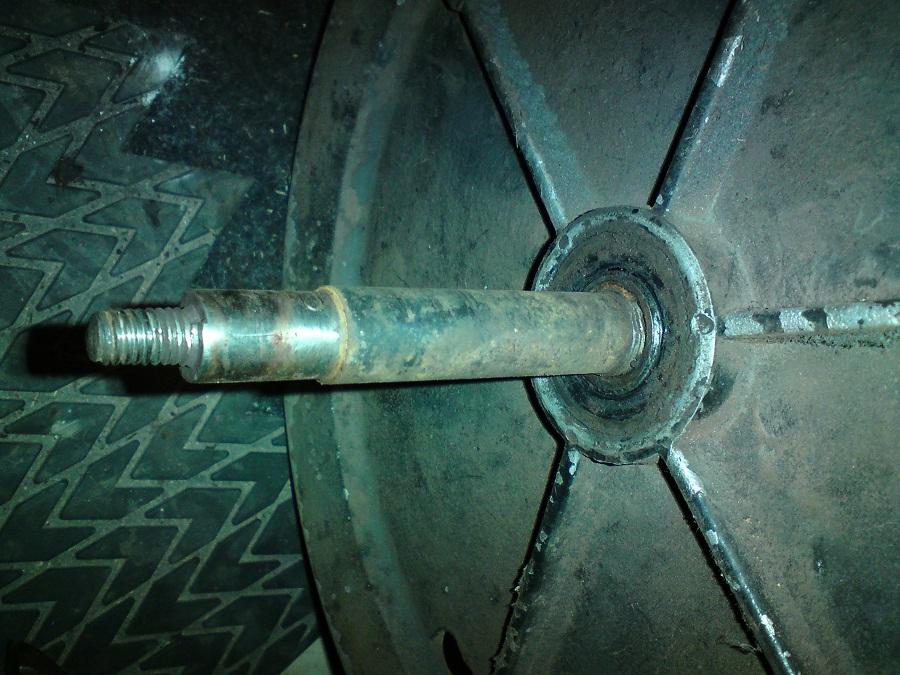

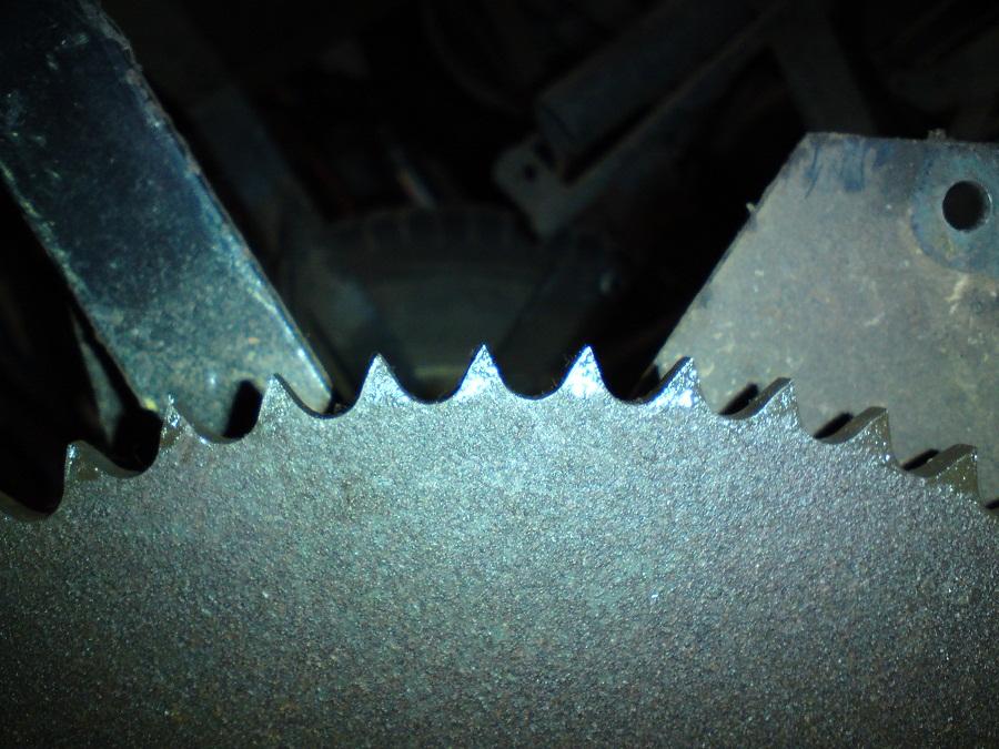

Just a quick picture of the rear sprocket with the slightly swept over teeth from wear

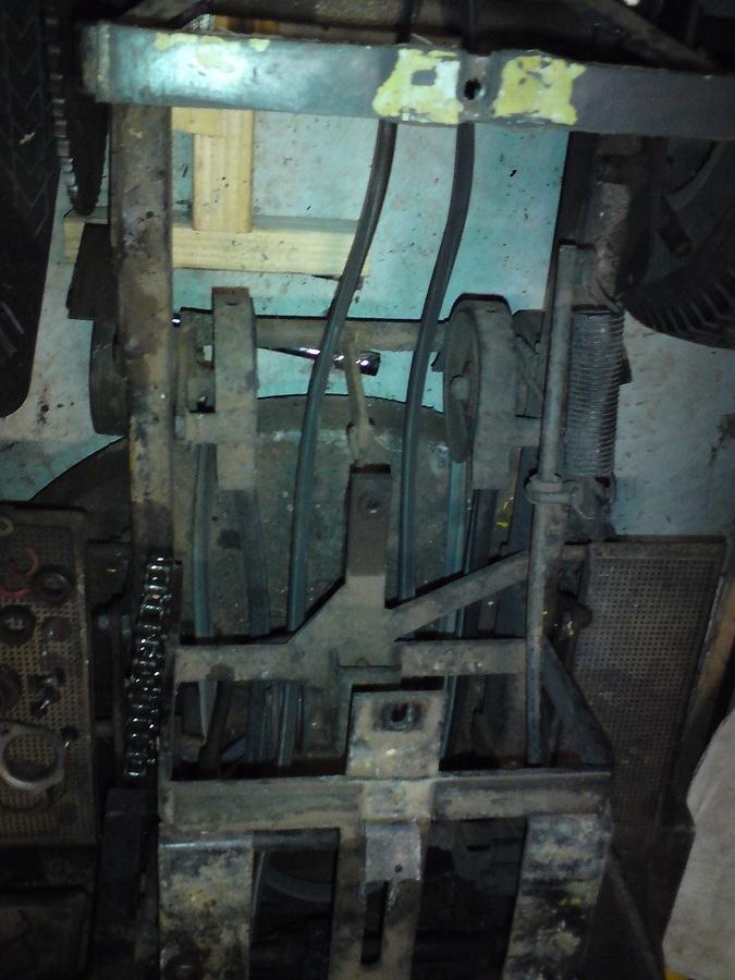

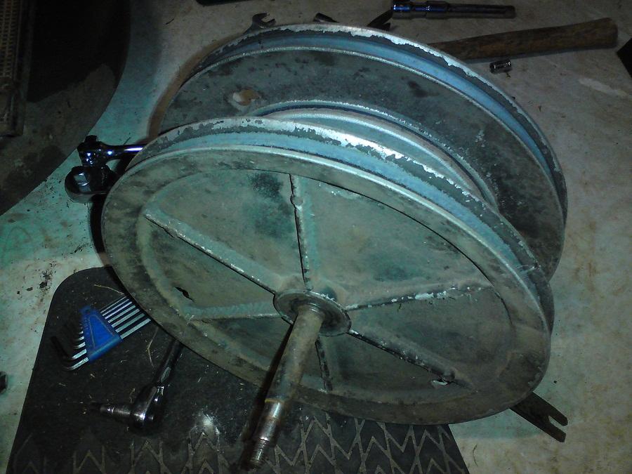

The rear drive assembley with all bolts removed. Can't figure if that drive pulley needs a bit of heavy handed action to be removed. I don't think it screws on in any way??
A bit closer
close up with the thread in view

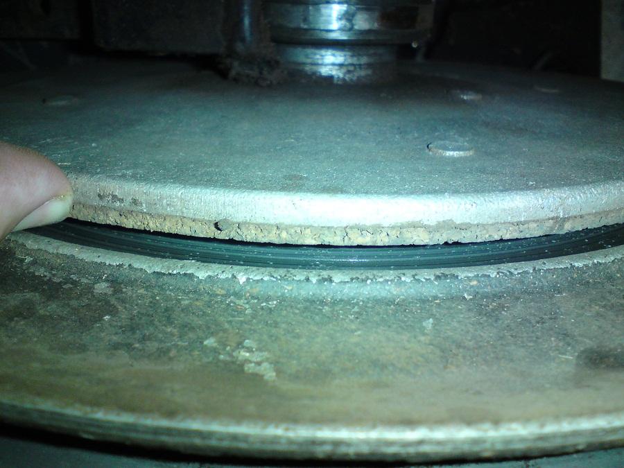

Just a close up of the cork clutch. Still seems to have a bit of beef left but haven't obviously seen the full face.

My guess is it works the same way as Deadly Dave's, aldot: you need to unscrew that lock ring, then the two drive plates and clutches can slide sideways off the square that is driving them. I think your shaft is probably similar to Dave's, but they used lock rings instead of hexagonal nuts to retain the clutches. Is there a thread protruding slightly on the other side of the clutches as well as the one you have shown? That would make it even more likely your shaft design is the same as Dave's. If so, you might be able to use nuts when you reassemble it.

Grumpy I have removed the bolt from that side. It has the same bolt as Daves has but I cannot get that wheel off. Do I need to force it or use a puller etc? Perhaps there is some corrosion in there holding it on?

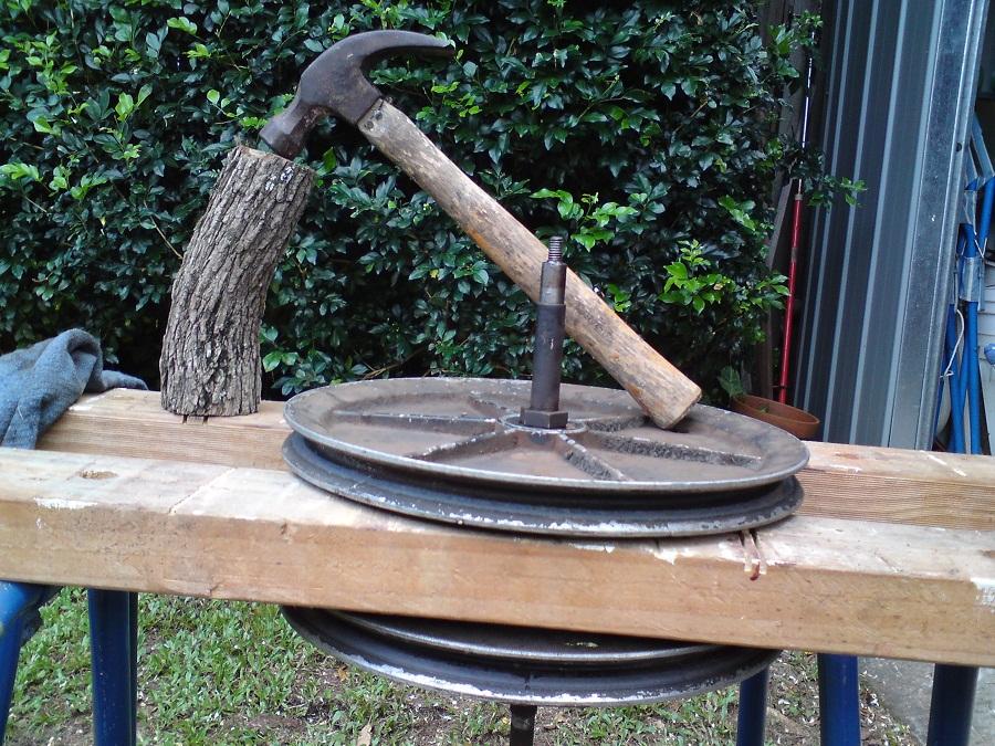

Hi Grumpy. After a long inspection and a touch of marine Inox I realised there was no locking tab of any sort. The gentlest of taps when set up in this fashion saw the thing come apart very nicely. Just a hammer and a block of wood set up in my saw horses, I wasn't fussed on using a vice for alloy pieces. (the nut on top was obviously removed!!)
The whole assembly came apart nicely revealing the cork pads in a still serviceable condition.

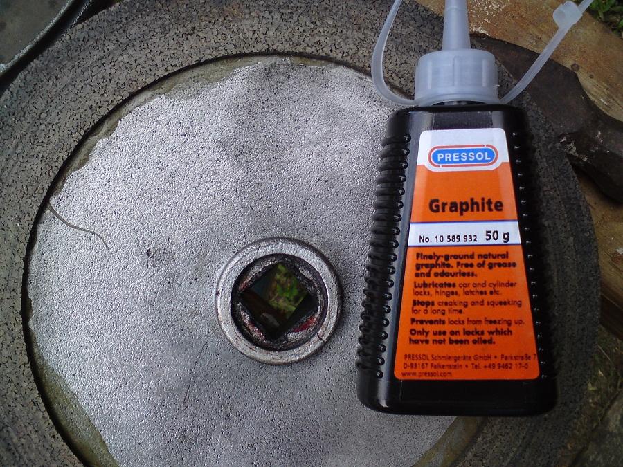

I inspected the square drive that the centre hubs drives on and it was completely free of any burs or wear as was the internals of the drive wheels. Pretty happy with that.
Just a smidge of graphite powder applied to the cork pads as recommended by the service guys at a the local Greenfield agent to stop the small amount of squealing that you sometimes get.

Are you going to put graphite on the square, to keep the clutch members from binding to the shaft? Do not put oil or grease there, but I think graphite would be OK - it won't form an abrasive slurry with dirt, the way liquid-based lubricants do.

The graphite powder was applied to the face of the cork pad. The initial reason I inspected the cork pad was due to a bit of squealing. I right they were home and I had alloy to alloy. The fellow from the service centre said a touch of graphite powder solves that.

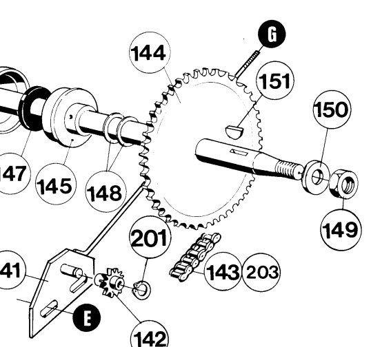

I had a look at the Greenfield Anniversary 8 & 11 Manual.
Here is a picture from the manual of the rear axle assmebly.
Is it the same as yours?
If it is, as in my last post, some gentle heat on the wheel hub and some gentle persuasion will aid to get it off.
Cheers, Murray

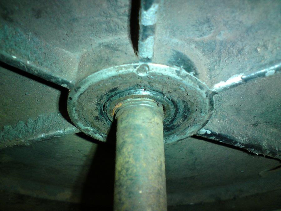

Serious corrusion indeed. I have put heaps of inox on it and still no budging it. I have applied some heat around the rim near the axle but am a bit hesitant. I will continue the task after i control the grass.
The photo of the disc says it all.
I suspect the previous owner was a bit of a shall we say a careless driver and has collected something...
There are no cracks in the metal...I would shutter to think what a new blade plate would cost. I am in rough terrain so i only use 2 blades, i will try and straighten 2 and see how it cuts. There is still heaps of meat on the metal so blades won't come off.

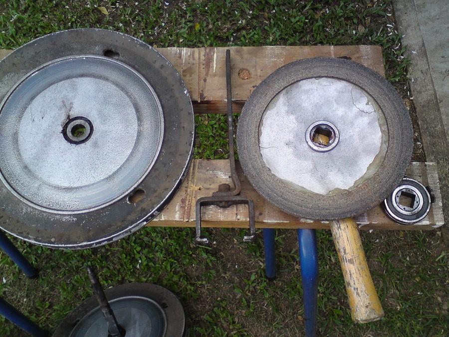

My wheel is as you say single centre nut. With a keyway hidden inside.
I actually do have 2 holes in the rim but being an alloy i am very tentative about using a pulley on it??????? I did think of it but for once I decided it may not be such a good idea...
Everything on this mower has been a task, i don't need to get the rim off it is more of a maintenance thing while it is in the shed, BUT it has taken on more of a meaning now and it is my mission in life to get it off....
The one in Murray's diagram is quite different from the 12-32 I was describing. It appears yours does not have detachable wheels - the one in the manual on this site does have detachable wheels, and I was telling you how to get the hub off after you took the wheel off. Yours seems to be like Aldot's, shown earlier in this thread.
Your hub is on a short taper, as Murray's diagram shows. I do not see a way to use a puller on it - certainly not a leg-type puller. I suggest asking a Greenfield dealer how he/she gets them off. Heat is not especially effective with tapers, especially when you are likely to cook your tyre and tube. It needs an axial force combined with an impact. Because the taper is short and steep, it is probably quite easy to remove with the right technique, but without seeing the available space behind the wheel, I can't guess what that is.

If there are holes in the wheels, opposite each other and close in near the hubs, I think we can make a very good guess at how people pull them off. I'd rather have four holes to reduce the risk of deforming the wheels, but obviously it is much easier to make a two bolt flat plate puller than a four bolt one. You just need a piece of 2.5"x0.5" steel long enough to span the two holes in the wheel, drill holes in it to match the ones in the wheel, grab a couple of bolts or pieces of threaded rod, and it's all over. However if the holes in the wheel are far, far apart (more than 6") you would need to reconsider the dimensions of the flat plate. Remember, thicker is far more effective than wider.
Joined: Jan 2011
Posts: 301
My concern about using a puller would be if the key on the axle has worn a grove in the wheel from the constant forward and reversing action of general usage. That would mean there is some slop in the wheel on the shaft causing slight forward and backward play. This would then mean you would have to hope the wheel is jammed on and by coincidence the keyway is aligned in its original position to allow easy removal with a puller otherwise you'll do some serious damage. Sounds confusing.
Joined: May 2010
Posts: 11
The key is about 2" long and the LH wheel has no shows of wear so i am guessing nothing to sinister in there apart from corrosion.
Serious damage is a definite possibility but i am going to make up a 2 leg pulley as Grumpy sugested and give it a crack tonight. If that doesn't work out comes the angle grinder.....ha ha
