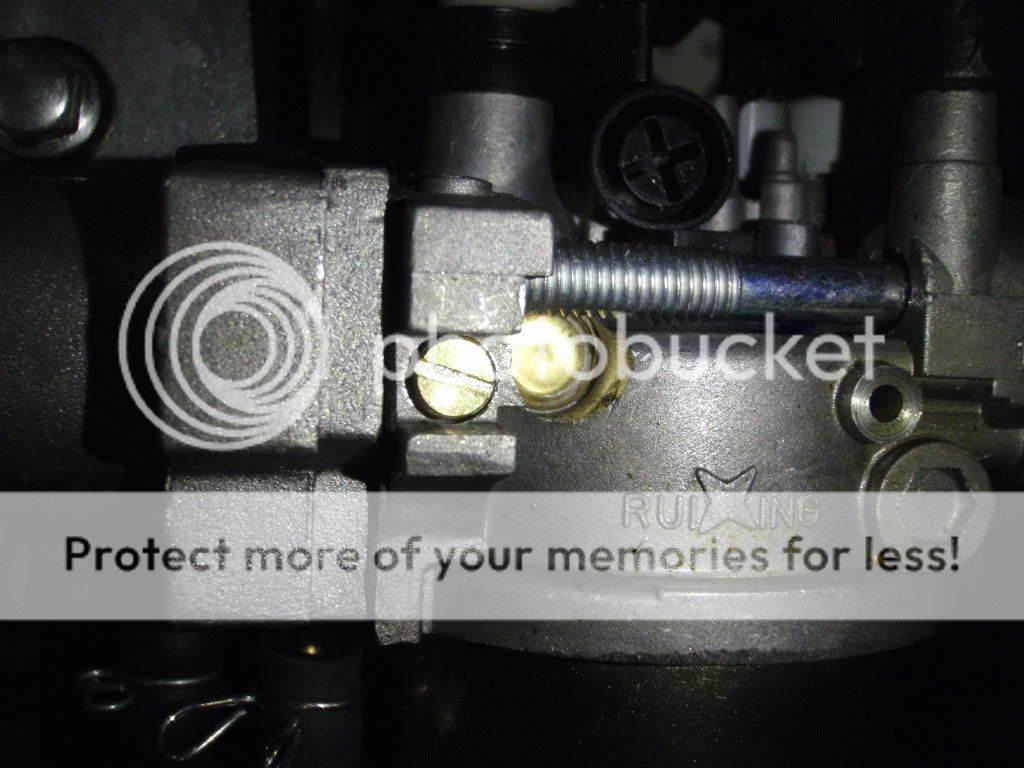

Gday everyone,
Just an update on the genny. I have dismantled the fuel pump and as advised I have smoothed out the mated surfaces with 1200 wet and dry (on the new benchtop with water,and lived to tell the tale)( just had to do it when the minister for war was at work).They were in a very poor state with cast marks and burrs. After I reinstalled it does seem to prime up better.
I think now the problem is in the carby. It will only start now if I pump the prime about 20 times (instead of the previous 70)and advance,or open, the throttle slightly. So I am thinking the set up may be wrong.
There seems to be only 2 adjustments,one for idle speed and another which I am not sure about. It is a brass screw which I don't think I should play with too much.It is very loose so If it is an important adjustment,there is nothing stopping it rattling to where it likes. I have taken some close up photo's, I hope they will appear.http://i810.photobucket.com/albums/zz22/chapconn/P8120546.jpg http://i810.photobucket.com/albums/zz22/chapconn/P8120547.jpg
Any thoughts are always greatly appreciated, Cheers Greg
gac #18487 14/08/10 02:33 AM
Two small points, Greg. First, you need a space between the full stop after "appear" and "http", to make your first picture accessible. Second, you have said that the generator runs well after it starts. Jet adjustments are a bad idea as long as that is the case.
It sounds to me as if you probably still have at least one air leak upstream of your primer. It may be that you haven't yet got the pump completely fixed. Alternatively - and less likely - there may be a second problem with the fuel lines.

Joined: Jun 2007
Posts: 46
gac
Offline
[Linked Image from i810.photobucket.com]
