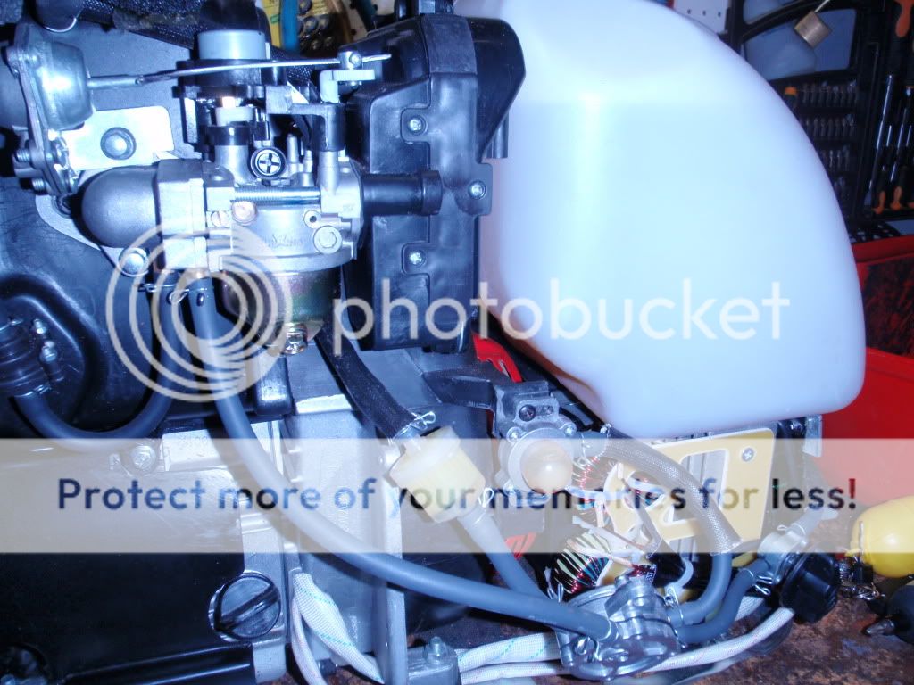

[Linked Image from i810.photobucket.com]
dj,Hope these links work.cheers GAC

Can anyone give some hints as to how to improve this fuel system (if at all possible). I changed the primer bulb today which was kindly posted by the guy I bought it from on Ebay.It still took about 60-70 pumps to get the fuel up and again once it starts it will start all day. This ,as I think i posted earlier, is unlike when I first primed and started it when I could come back the next day and kick it over with no priming. So to summaries it is basically loosing prime overnight. Any thoughts?? Cheers GAC
gac #18207 26/07/10 04:38 AM
If you have replaced the entire primer bulb/pump, there seem to be two generic possibilities remaining: an air lock downstream of the primer bulb/pump, or an air leak or liquid lock upstream of the primer bulb/pump. If there were a downstream air lock, the pump would be unable to pump out the air inside the bulb and replace it with fuel because there was nowhere for the air to go. You would probably know if that were happening because the bulb would become difficul to pump after a few strokes. If there were an upstream air leak, air would be getting into the fuel hose when you applied suction with the primer bulb/pump. An upstream liquid lock would be something like a sticky valve in that round device you are holding in the photo. You would need to check the fuel hose connections for leaks, and examine that strange round device, which might be a fuel pump. If one of its connections or its diaphragm leaks air, or its intake valve is a bit sticky, all may be explained. We'd need a proper diagram and explanation of that rather complex fuel system to be much more helpful, I think. My guess is a serviceman would replace the priming bulb/pump, and if that didn't fix it, replace the fuel pump (if that's what the round thing is). Most likely it would be one or the other, and he'd have fixed it within ten minutes.

Thanks guys for your quick responses.You guys are definately on the money, The "round thing"is definately a fuel pump of the daiphragm type pumped by crancase vacuum.You can see the line comming from the crancase in the first photo. I have very carefully pulled this apart to check for damage,and apart from being fairly basic in construction, it appears ok.When I pump the primer bulb there are air bubbles in both the bulb and the fuel filter after the fuel pump.If there was an air leak wouldn't that translate to a fuel leak at some point??
gac #18221 27/07/10 02:14 AM
Bubbles in the fuel line means either a suction air leak, or a blocked fuel tank air vent. If it was the fuel tank air vent it would not run properly after starting, so a fuel line air leak is more likely - but check the tank vent anyway, because a high enough vacuum in the tank can cause the fuel pump to misbehave.
Check for air bubbles in the primer bulb when the engine is running - air may be entering the system steadily, but once the fuel pump starts operating, it has enough capacity to pump air and fuel simultaneously.
You would not necessarily get a fuel leak if there is an air leak upstream of the fuel pump or primer pump. Liquids are much easier to seal than air - a pinhole air leak will stop the primer from working but may not leak fuel at all.
If you are sure that there is no air leak into the fuel pump (which is under suction when you operate the primer, remember) or a malfunctioning fuel pump valve, then check the joints in the various hoses attached to the fuel pump and the primer pump.

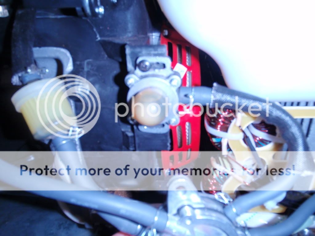

Just an update on the genny. I have dismantled the fuel pump and as advised I have smoothed out the mated surfaces with 1200 wet and dry (on the new benchtop with water,and lived to tell the tale)( just had to do it when the minister for war was at work).They were in a very poor state with cast marks and burrs. After I reinstalled it does seem to prime up better.
I think now the problem is in the carby. It will only start now if I pump the prime about 20 times (instead of the previous 70)and advance,or open, the throttle slightly. So I am thinking the set up may be wrong.
There seems to be only 2 adjustments,one for idle speed and another which I am not sure about. It is a brass screw which I don't think I should play with too much.It is very loose so If it is an important adjustment,there is nothing stopping it rattling to where it likes. I have taken some close up photo's, I hope they will appear.http://i810.photobucket.com/albums/zz22/chapconn/P8120546.jpg http://i810.photobucket.com/albums/zz22/chapconn/P8120547.jpg
Any thoughts are always greatly appreciated, Cheers Greg
gac #18487 14/08/10 02:33 AM
Two small points, Greg. First, you need a space between the full stop after "appear" and "http", to make your first picture accessible. Second, you have said that the generator runs well after it starts. Jet adjustments are a bad idea as long as that is the case.
It sounds to me as if you probably still have at least one air leak upstream of your primer. It may be that you haven't yet got the pump completely fixed. Alternatively - and less likely - there may be a second problem with the fuel lines.
