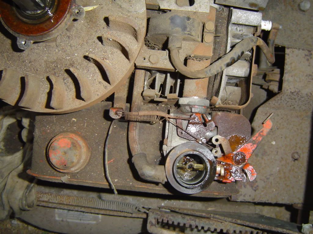

Hello Bruce
Can you still buy a carby gasket set, etc for this carby?
Thanks

Hi mvc,
I did one of these carbys the other day, although I acquired the parts thought a bulk buy from a deceased estate the diaphragms were dated 6/08.
I love these engines, and the mower itself is a perfect example of Australia ingenuity
Regards Jay

MVC,
This should be the diaphragm you need [Linked Image] which is available HERE cheers2

Thanks Bruce, I will be working on the mower this weekend. It is 3 hours drive away, so i will bring the carby and tank home with me to make sure of the bits I need.
Good to see you can still get them.
This mower goes fine when I pour some fuel down the carby, so she will go again.

MVC I would be checking your valve seats first. cheers2

Yeah I know Bruce, I should have mentioned, this mower must have been sitting around for about 10 or more years before I got it, so as normal there is some unusual looking fuel (sludge) through out the carby and tank. I have cleaned the carby but the tank will need something done to it. HAHHAHA the joys of old mowers!!!

Ok, I have managed to clean out the carby and tank on this old beast and I reckon it will be ok. I know it goes ok, (valve seats good, because it did start if I poured some fuel down the inlet).
There was some serious bad crap the came out of all the galleries etc in the carby! They all seem to blow out fine now. I will also check the dates etc on the cowl.

Got this beast going over the Xmas break. Starts first pull, but will not keep running unless I give it a bit of choke manually, I will have to source the two governor springs and give it another go. I was testing it with the air cleaner off, but I would assume the air cleaner would not restrict the air flow that much.

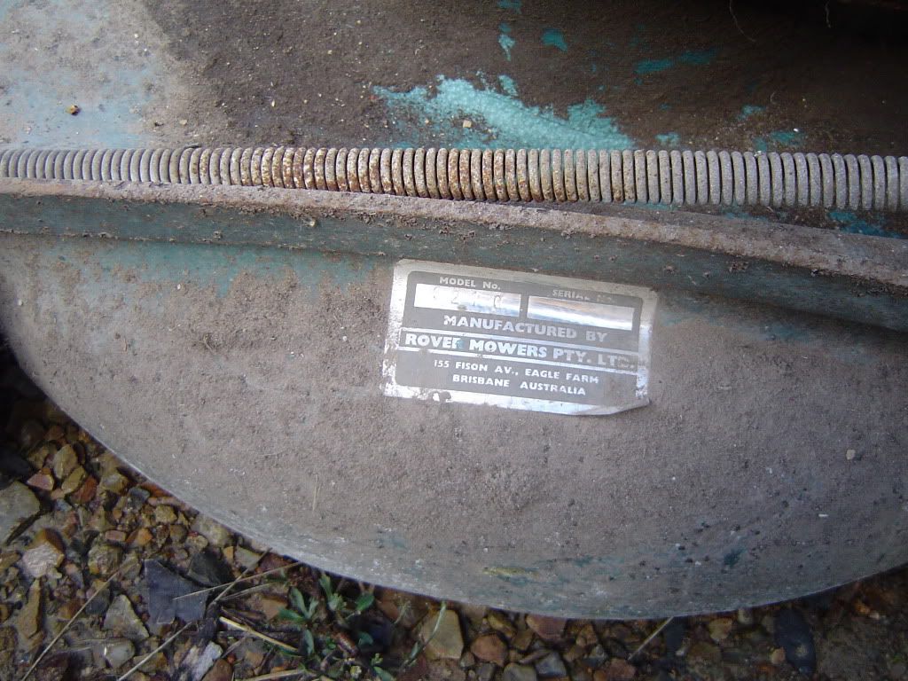

The Code is 68-05027 so that makes it a 1968 model.
