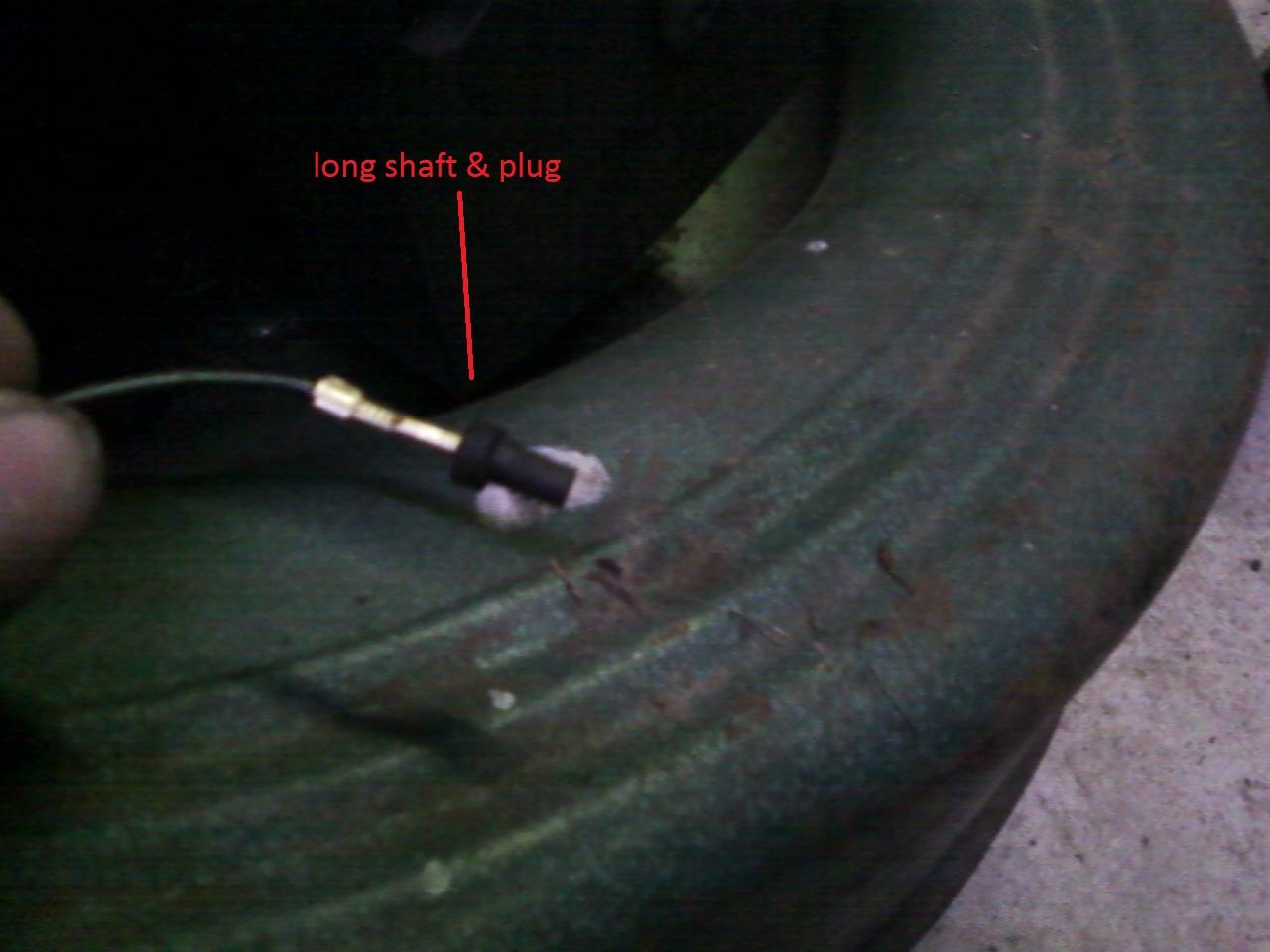

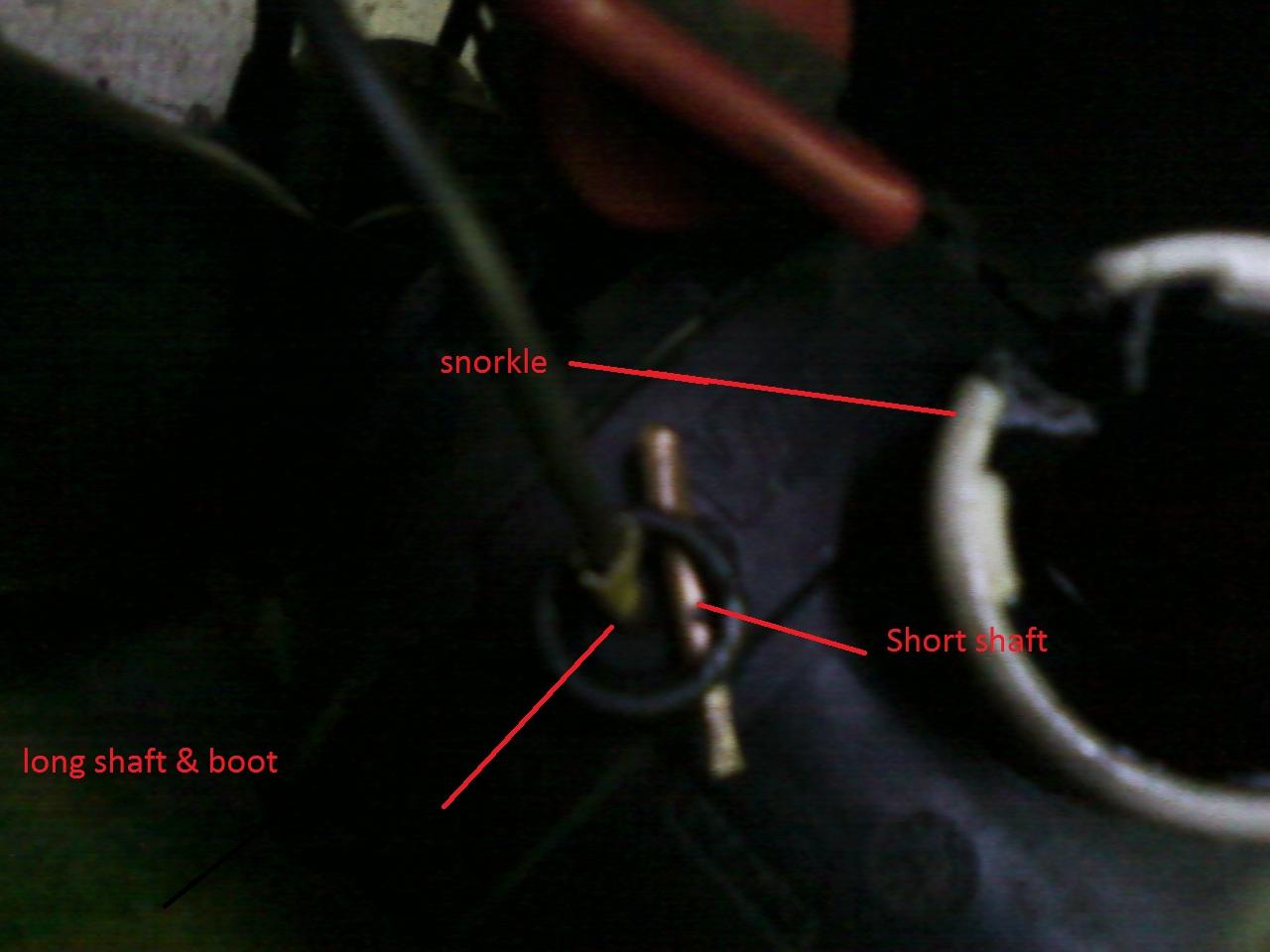

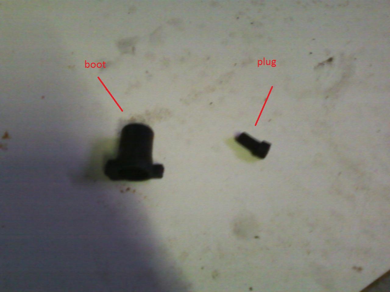

the fuel tap does unscrew from the tank, also its best to use the kill switch set up to stop your engine as turning off the fuel makes it lean out and can cause premature wear to the bore piston and rings. here are some photos of the kill switch set up , just make sure your engine is set to run to assemble or the probe wont go in. cheers, mitch
