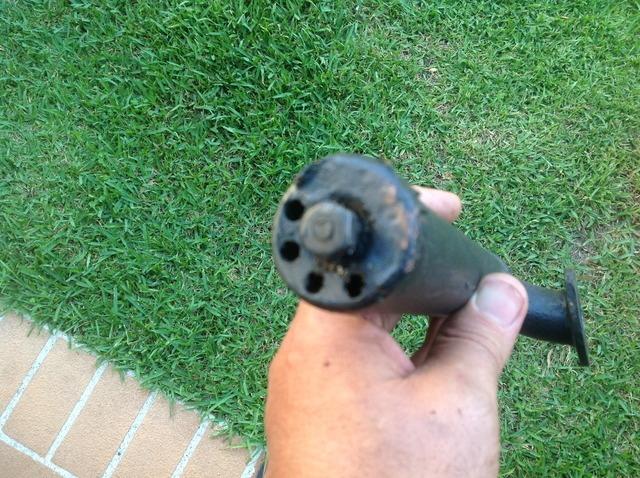

I also found another exhaust that the previous owner must have struck the same issue of oil splatter and made a very easy modification to the outlet
It looks like a piece of copper blocking off a few holes and held in place by the end nut, may even quieten it down a little as well.
