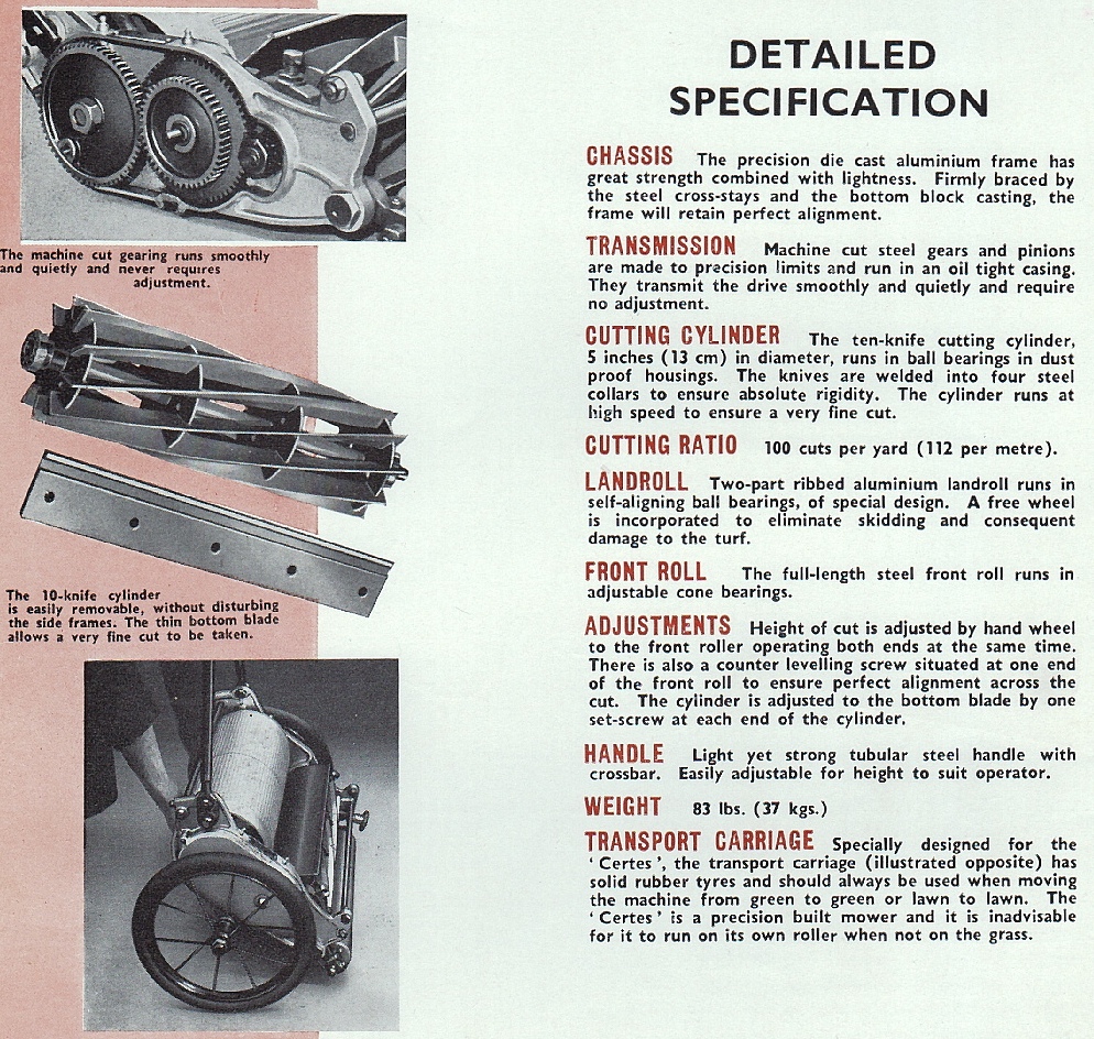

PART TWO � Specification and 1950s Brochure
The Certes was certainly a new generation of design. The new thinking was that precision mowers should be lighter �
and that the old idea that mowers should combine cutting and heavy roller functions was abandoned for them.
The Certes made extensive use of new materials and precision manufacturing processes � with die cast
aluminium side frames and landroll, and precision cut gears. The 10-blade reel ran on self-aligning bearings
and cuts per metre was well over the hundred mark.
Note that the front roller was not only micro-adjustable, but had a �counter levelling screw� for perfect alignment.
Note that a transport carriage was recommended (but optional).
1950s BROCHURE
This brochure comes from my collection. It is in mint condition.
By this time, the Certes was at its MK12 design stage and offered in one size - 16 inch.
Ransomes Certes c1950 brochure 01
Ransomes Certes c1950 brochure 02
1950s Ransomes Certes Brochure as a pdf

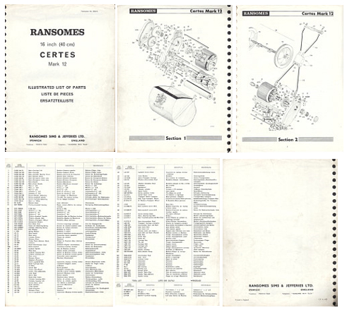

PART THREE - Parts List
Here is a parts list for a Certes Mk12, c1970s, from my collection.
This is the modern, post-war Certes with cross-over tubular handle bars.
What a beautiful design. This was a precision lawnmower par excellence.
RANSOMES CERTES MK12 PARTS LIST
