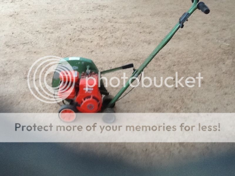

I have noticed a SB 38 edger for sale locally, and would like to know it they are worth buying? It looks in good original condition and the seller said the engine is good and it works fine, but they are asking $150. I think it is a bit of the expensive side.
What things should be checked before making an offer? Are there common faults or items that give trouble on the 38? Also are the SB 38 edger reliable and easy to use?
Or has this type of edger been made redundant by the modern line trimmers, which can be used for more tasks than just edging.

Some images would help as well if you can post them. As to the pricing I agree with Millzy555 but we can get a better idea if you post images. cheers2
Joined: Jul 2017
Posts: 30
Here are some photos of the edger.
[Linked Image from i1163.photobucket.com]
I also think the value of the edger is below the $100 mark.
I would mainly like to know if the edger a good piece of kit and worth having? Also what are the common faults and problems with this model of edger? Or should I just stick to a line trimmer for my edging?

This is an example why we do not want photobucket used on the site as you will need to pay around $400.00US a year to allow your images to be seen on any website. I have sent a PM so that others can see what you are talking about.
The correct way to upload images is by using this method CLICK HERE

Thanks for the link on how to upload the images correctly. Also sorry for the poor quality photos.
I'm not good at some of this, but ...
We have received no negative comment from users about the design.
It's a simple, reliable design, and easy to use.
The other good thing is that the Model 38 may be fitted with blades or wire brushes.
Blades are good for straight edges, wire brushes for curvy pathways.
Hope this helps

I am very tempted with the edger at the right price, as I have a couple of paved paths that split my front lawn. Getting these edges looking good is hard with the line trimmer, as one slip and the edge has been chunked.
I am hoping to see the edger in the next few days, so will give it a good look over and test, then go from there. I was just interested if these edgers have any common issues like cracking which the twin frame Scott Bonnar 45 series can have. But like you say there is very little negative information circulating regarding the 38 model.
Hi beantin
Many thanks.
Yes, these path edgers come into their own with these gadgets.
I will add - we have no issues on record with design problems.
The friction washers [item 47] need watching. These can be made by you.
Apart from that, the usual engine checks - no engine smoking and good filter.
Here is a schematic of the Model 38 chassis.
These edgers are held in high regard.
They were amongst the top players - Scott Bonnar, Rover, Victa.
If you have the application, this will do the job.
