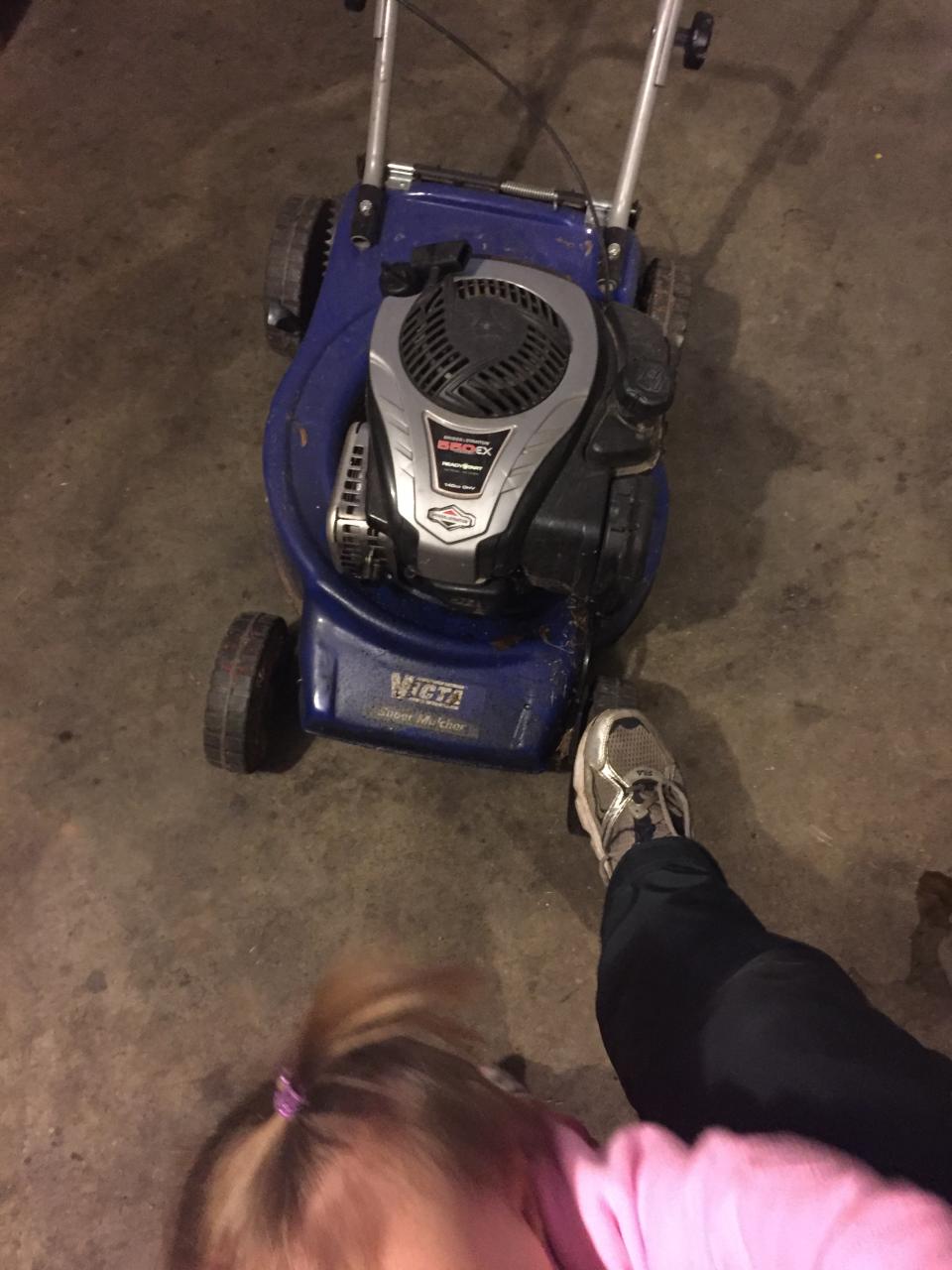

Just after some thoughts on mower I picked up a couple of weeks ago. It�s a fairly new Ready Start no prime no choke Briggs Engine that�s done very little work.

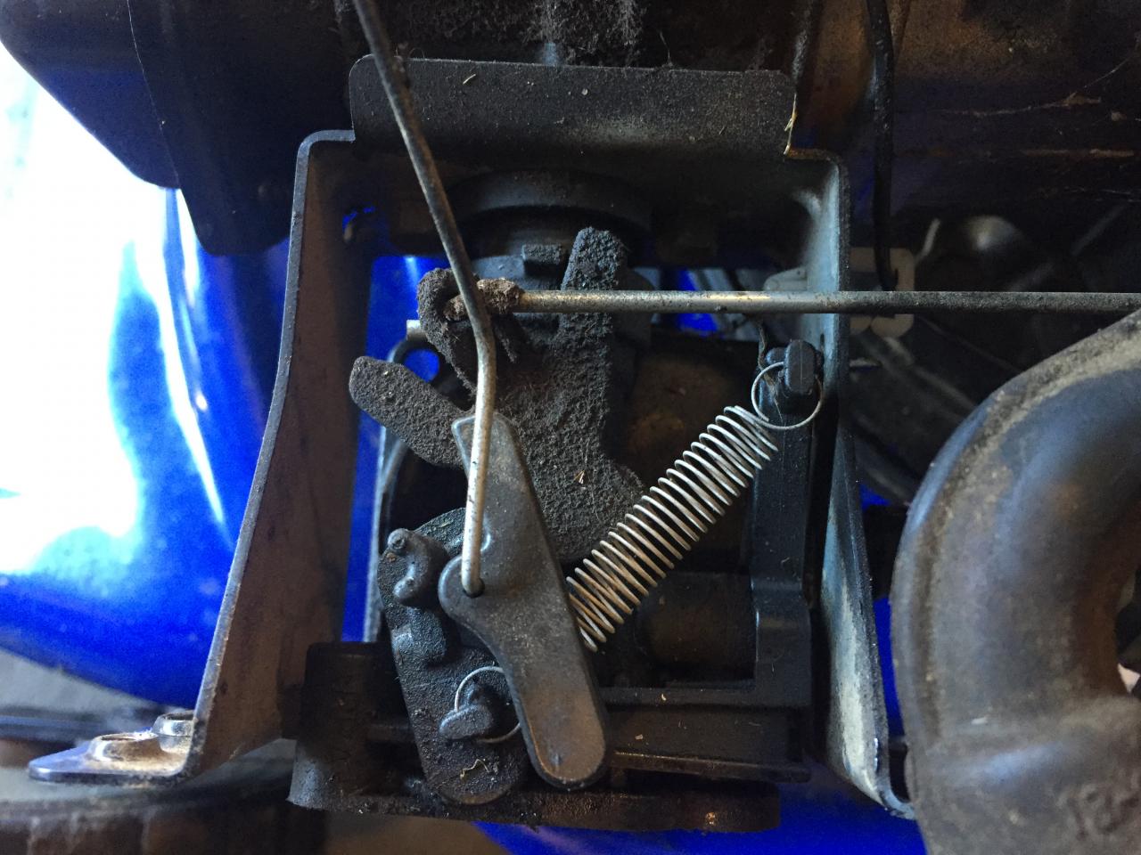

The linkages appear to be all hooked up correctly. When the engine is cold the choke is closed and then it appears to open up as it should once warm.

Sorry I don�t have the model type and code at the moment however I will get it tonight. Apologies for the photo with my daughters head. She is always trying to hijack my photos.

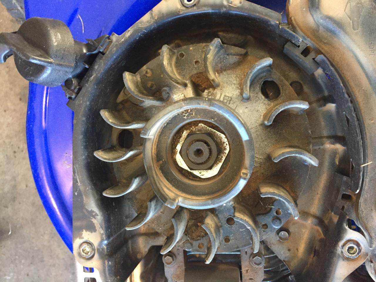

Yes it sounds like it is a head gasket. The other thing to check would be the breather. From memory the flywheel has to come off to get to it.
