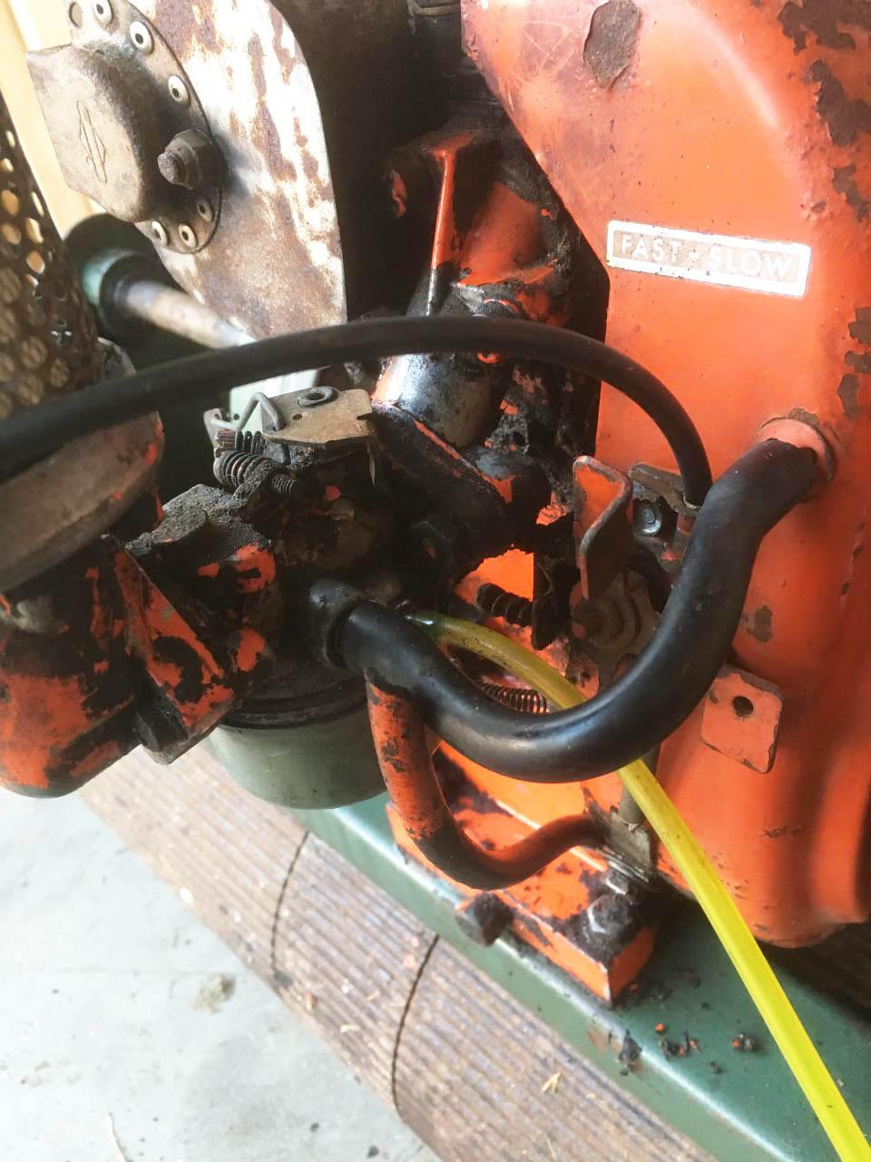

I've managed to get the Engine started with the aid of the spay, the engine itself runs very rough and won't keep a constant idle, when I move the throttle to full it nearly conks out, is there any adjustment screw I need to adjust.
I have also noticed there is a drain line of some sort broken off, I should note I'm still waiting for a new Prima bulb, don't know if that has anything to do with it.
Joined: May 2017
Posts: 131
Two screws right in the middle of the pic. I suggest reading up on them and understand what they do. Idle adjustment screw is there. Make sure the springs are working properly/ allowing full travel. Again just seach and theres a heap of threads

Will do. Do you know what the hose hat is broken goes onto. It look like a drain line,as it clips to the bottom on the engine and just runs to the ground.
Joined: May 2017
Posts: 131
Overflow possibly from the carb?

I think the broken one is your crankcase breather, it is sometimes fed back into the air filter or just vented to air.
Joined: Aug 2015
Posts: 26
Thanks Paul. So I doesn't matter if it is broken, as it was only a breather tube. Yeah.

Hi all,
I've just had a look at the photo which I've corrected and notice that the broken piece of orange painted hose is merely a breather hose that is normally connected to the underside of the air filter housing and as such is nothing too much to concern yourself with. It's a sort of Positive Crankcase Ventilation set up to feed fumes from the engine back into the air intake
The carby requires a good degreasing and then I would like you to feel how much slop there is in that shaft that has the linkage attached to it at the top of the carby body.
