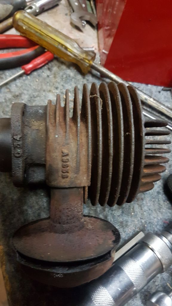

Beauty! thanks Jack, other question: Is the bore the same size with the midget engines? I have a few spare i was going to pillage the rings from
I believe, NO - 43mm G series; 50mm Midgets

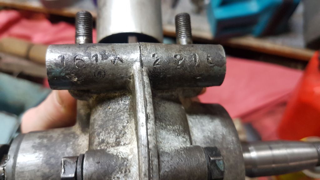

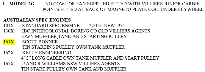

p.s. also, confirmation 161X was a Scott Bonnar spec...

Good work Jack, I have found it best to ring Steve in the evening rather than email. Make sure you hone the bore before fitting the new rings, probably will take standard rings.
