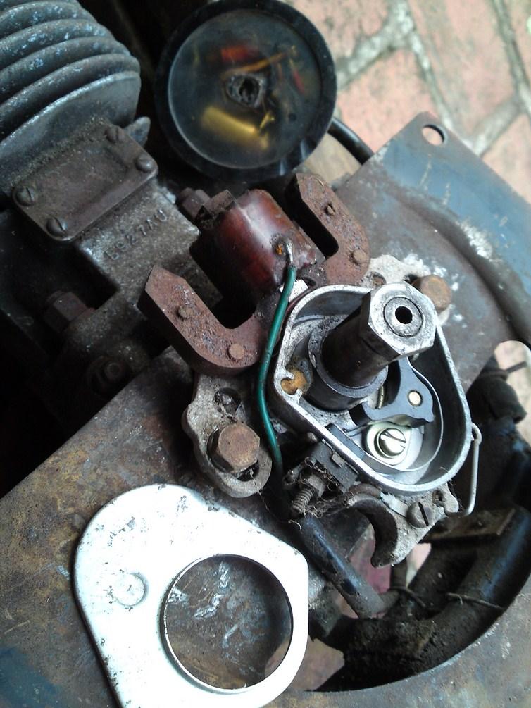

Just so that there's no confusion created, that bakelite CDI unit houses the step-up transformer, the capacitor and the rectifier diode components of the Magister ignition.
I have done a brief summary of how it actually works in that main Magister reference thread; https://www.outdoorking-forum.com.au/forum/u..._Magister_Condenser_Disch.html#Post59840
The main Magister patent doesn't really show the use of this 'module' approach clearly.

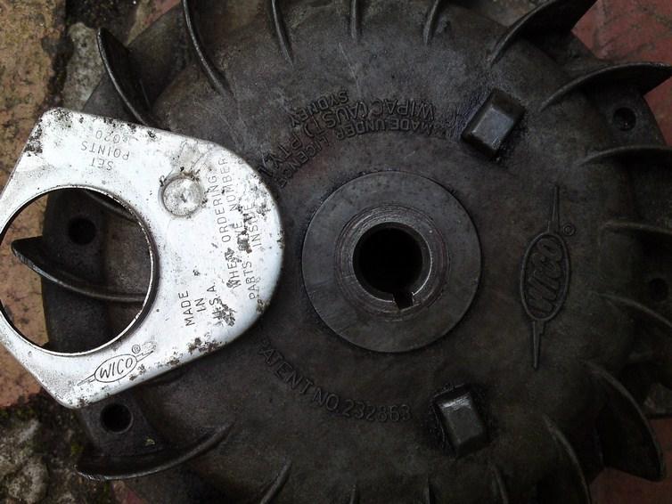

I am interested to see the Wico ignition plate. The little H. G. Palmer that I am currently restoring has a similar ignition system and is also Wico branded. Made in the good ol' US of A.
The same H. G. Palmer also has a Zenith carby, being AH914 (Mark B), fitted in parallel with the manifold and air filter.
I don't think I can help with your ignition system, as I only have a few Bosch ignition parts here for the Southern Cross KXD-2.

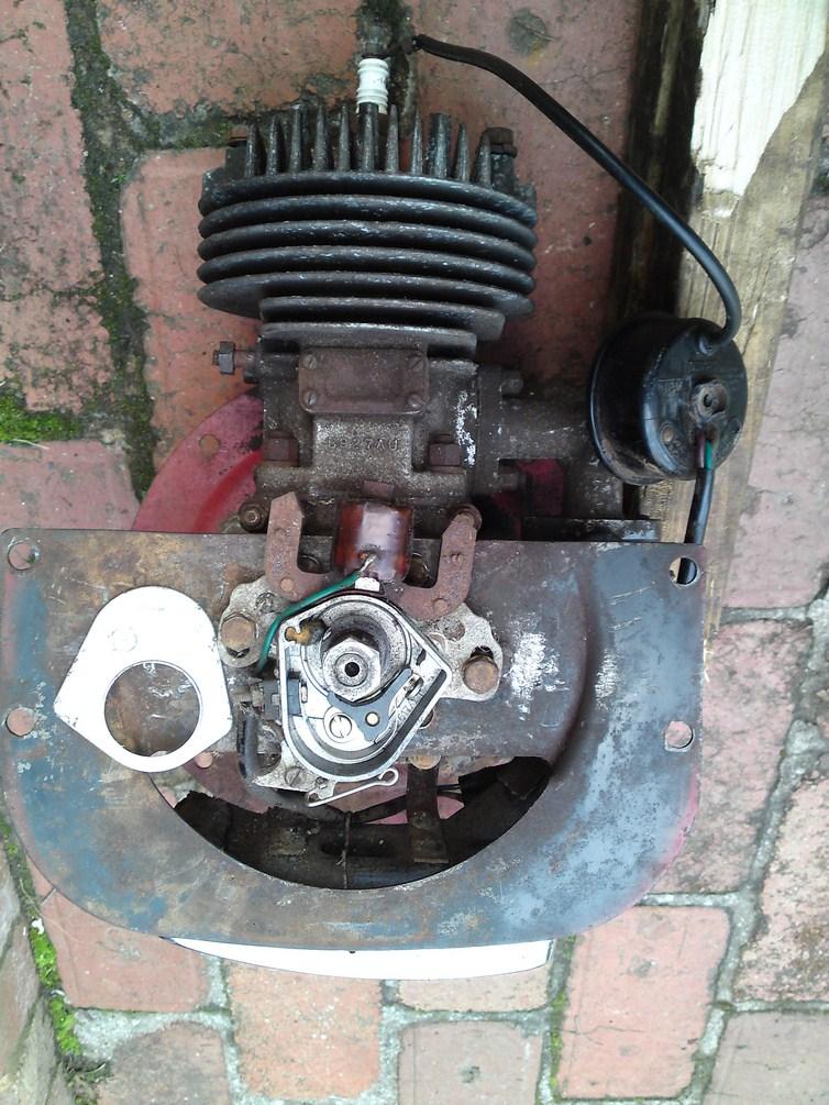

Hi vint_mow and Mowerfreak,
I have sorted the electrics and now have spark, the Amal carb is soaking in cleaner at the moment but is looking good.
