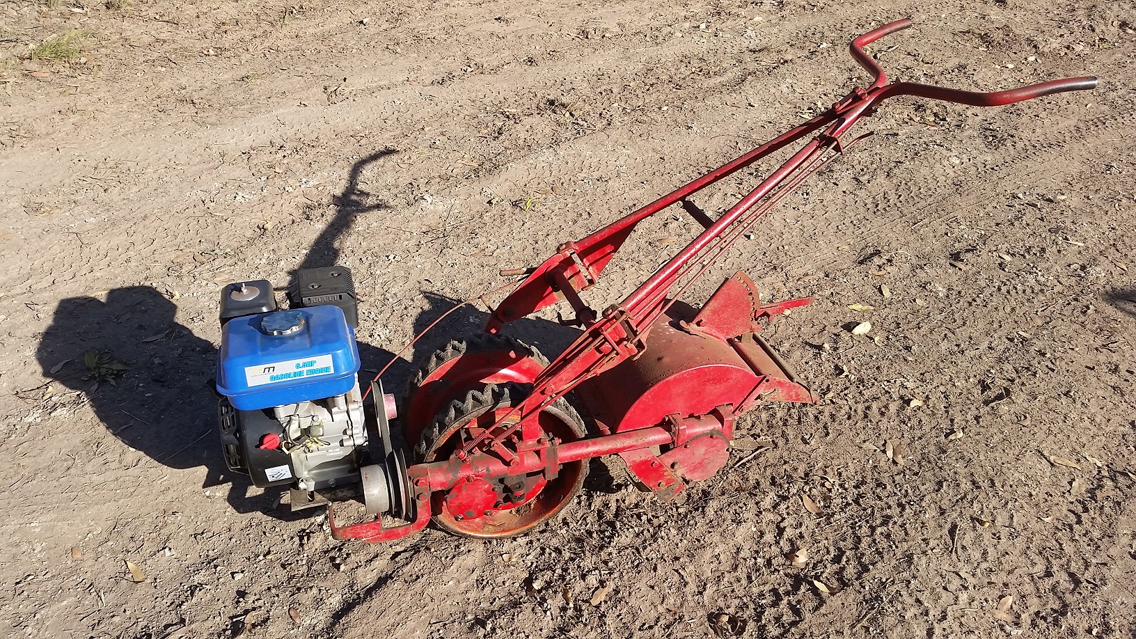

Hi guys,
I was wondering if I could get some opinions on the below tiller. I'm in desperate need of a tiller and was planning on hiring one however I would much prefer to try and snag an older model unit for not much more than a days hire. Only issue being, I'm on a very fixed income/budget however if I don't improve this soil I'm not going to be able to start growing anything!
I've found this one for $250 (not bought it yet), it's a 170mm cut apparently, 2 forward gears, new engine. I think it's a Howard Bantam?
It's going to get used for mainly tilling in cover crops and organic material (compost etc) into our wallum soil.
Thoughts? Opinions?
Much appreciated.

Joined: Sep 2016
Posts: 159
Hi Feleix, The tiller in the picture looks pretty good as long as it all works you wouldn't want a bigger tiller as they are to heavy to turn
and $250 is a fare price Go for it
Joined: May 2017
Posts: 14
Thanks guys.
Took a drive and went and had a look. Was impressed with how well it went and how solid the build was. Snapped it up for $250.
Couple of issues that are not big deals, the replacement engine (for the original Villiers) is fixed so you can't engage and disengage the belt (or change the pulley to hi/lo) so you need to start it with the rotor in gear, it shifts fine while running between drive gears though. I might look at getting a idler pulley made, but I think I can safely work around it.
The other thing, that I'll deal with sooner rather than later (with the help of the next door neighbor), is where the height adjuster connects to the rear rotor shroud it's cracked so it'll need welding soon.
Apart from that, I whacked some lubricating oil on all the joints, points and pivots and gave it another run once home. I'll give the engine a service (cheap Chinese Briggs knockoff) and I think i'll look into how the gearboxes work and what maintenance they need, I think there are two but no idea how to drain/fill and check them or what oil to use.
Weighing up this buy vs a 2 stroke ebay special vs hiring a larger model for $135/day I think it was a good purchase.
Hi Felix,
This webpage is the motherlode for Howard Rotavator manuals and parts lists; http://www.allotment-garden.org/rotavator-manuals-free/
Looks like yours is indeed a Bantam model.

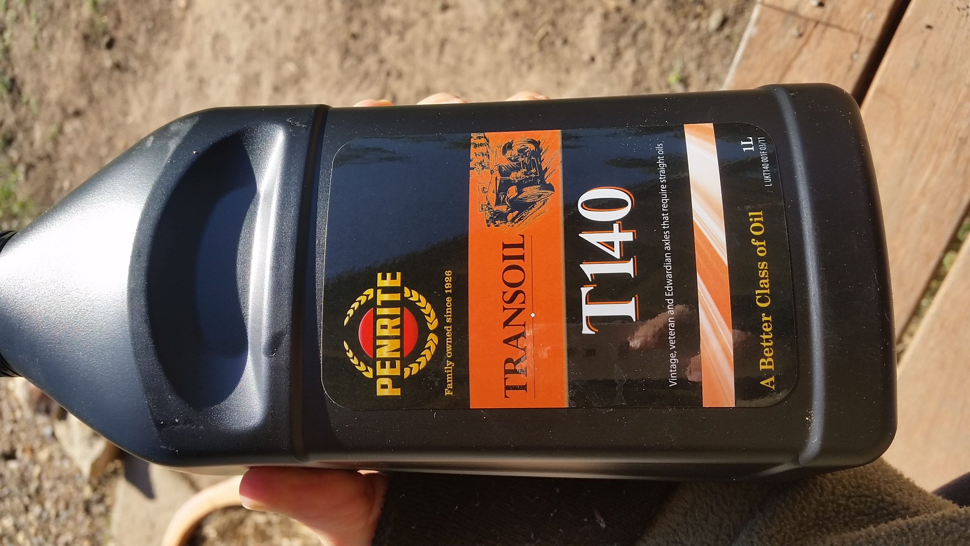

One thing to note; Howard recommend SAE140 gear oil, but do not use an EP type, as most readily available gear oil types are. The sulphur-based EP additives are corrosive to 'yellow metal' gears and bushings, which abound in these older machines.
The spec needed is API GL-1; which is most readily available in the Penrite brand, as their vintage car product 'Transoil SAE 140', in 1L packs.

Cheers Gadge!
I'd found that it was SAE140, but didn't know about being GL-1. I happened to be in town yesterday and went to Autobahn, that was funny, they looked at me blankly. Might be a challenge hunting it down!
Joined: May 2017
Posts: 14
Cheers Gadge, found this at a local oil mob. Now to decipher the manual on how to drain and refill!
