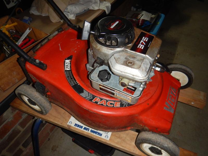

Just got given a Victa-Pace with a Briggs and Stratton 375 Sprint engine smile
Bloke who gave it to me said it was dead, couldn't be fixed - at least not for a doable price.
Poor thing was terribly neglected - almost no oil - only about 50mls came out - and that looked like it had been in since new - spark plug was rusty!! Broken throttle cable.
He said it worked until about 1 month ago when it just stopped - took it to mower shop who said it wasn't worth fixing and promptly sold him a new mower!!
So he gave this one to me because he knows I like to play with them.
"This one should give you a bit of a challenge" he said - "The bloke at the mower shop said it would be a lot of work and a lot of money!"
As I bet you are all predicting - changed the Carby Diaphragm and Gasket and she fired up straight away smile
The "donor" was pretty pissed off seeing me spend all of 20 minutes and $9.90 to fix his unfixable mower!!
It was running, but a bit rough - it was OK, but I wasn't satisfied.
Checked it - the spark was mediocre, and seemed to be inconsistent.
Checked the coil - good.
Had a look at the magnets on the flywheel - quite a lot of rust covering the surface - sanded away all the rust on the magnets snd fired her up - beeeeeudiful!!!!
Running like a clock! And only takes a half hearted tug on the pull start to get it going. My girlfriend is my "tester" - if she can pull start a mower then it passes my "Easy Starting" quality control test - (poor thing - I make her test all my mowers smile ...and even she said - "Oooooo this one is nice - so easy to start" which pissed off the donor even more smile
Which pissed off the "donor" even more - Last I saw him he was heading off down to the mower shop with s garden knome and evil intent.
So:
1: New Diaphragm/Gasket
2: New Oil
3: New Spark Plug
4: Clean and Oil Air Filter element
Running really well - even the governor is behaving well.
I will put on a new throttle cable tomorrow.
I must confess to being a little confused as to why sanding the rust off the magnets made such a big difference. The rust shouldn't have really affected the magnetic field in any significant way. I've gotta have a little bit of a think about this.
Anyway...... now to my real question.
I'd like to give this fella a coat of paint.
What colour red did Victa use - check out the photos.
Is the White Knight Rust Guard "Fire Red" a reasonable match?? Or is there a better (ie: closer match) colour to use.
Once again - thanks for your thoughts.

You did well resurrecting this easy fixer. Are you sure you want to pull it all apart just to paint the base? It looks quite good to me. A clean would suffice I reckon. There is some rust visible so it may be worth it I'd you are wanting to eliminate all the rust spots.

The red on that mower is pretty hard to match(god knows i've tried). If you must paint it pick csomething you think is suitable and go for it.

You could probably get the paint coulor matched, and that would give a pretty good result.
