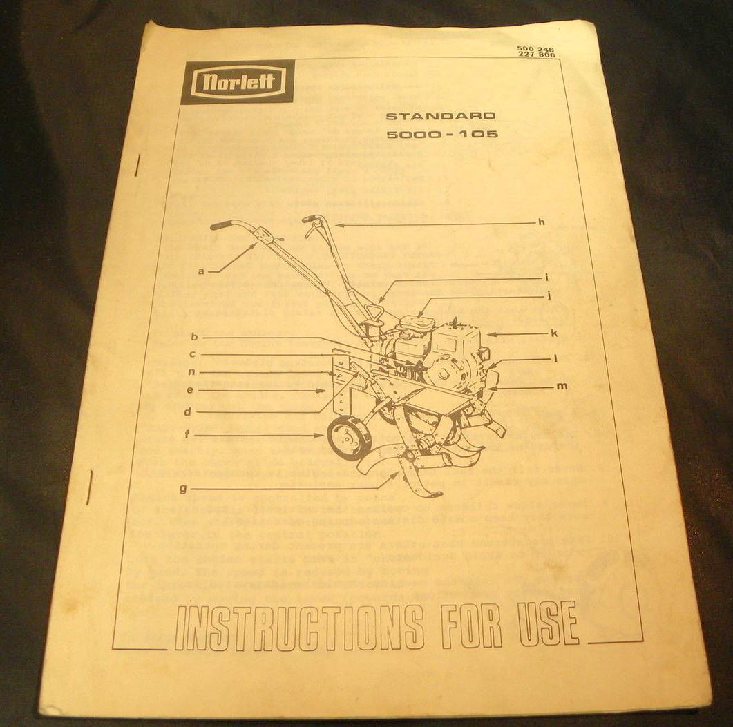

Yep, the 5000-105 variant, I'd say, going by this pic of the cover of the Instructions;
Pic pinched from eBay UK. This booklet is currently for sale there; it's probably worth buying it, @ �4.99 posted.

Yep. Looks right. Well done.

The problem with Norlett is knowing whether they made this tiller.
They seem to have been a marketing company, re-branding local and
imported products for UK consumption under their name.
It may be this was an imported USA tiller?
Who knows?
