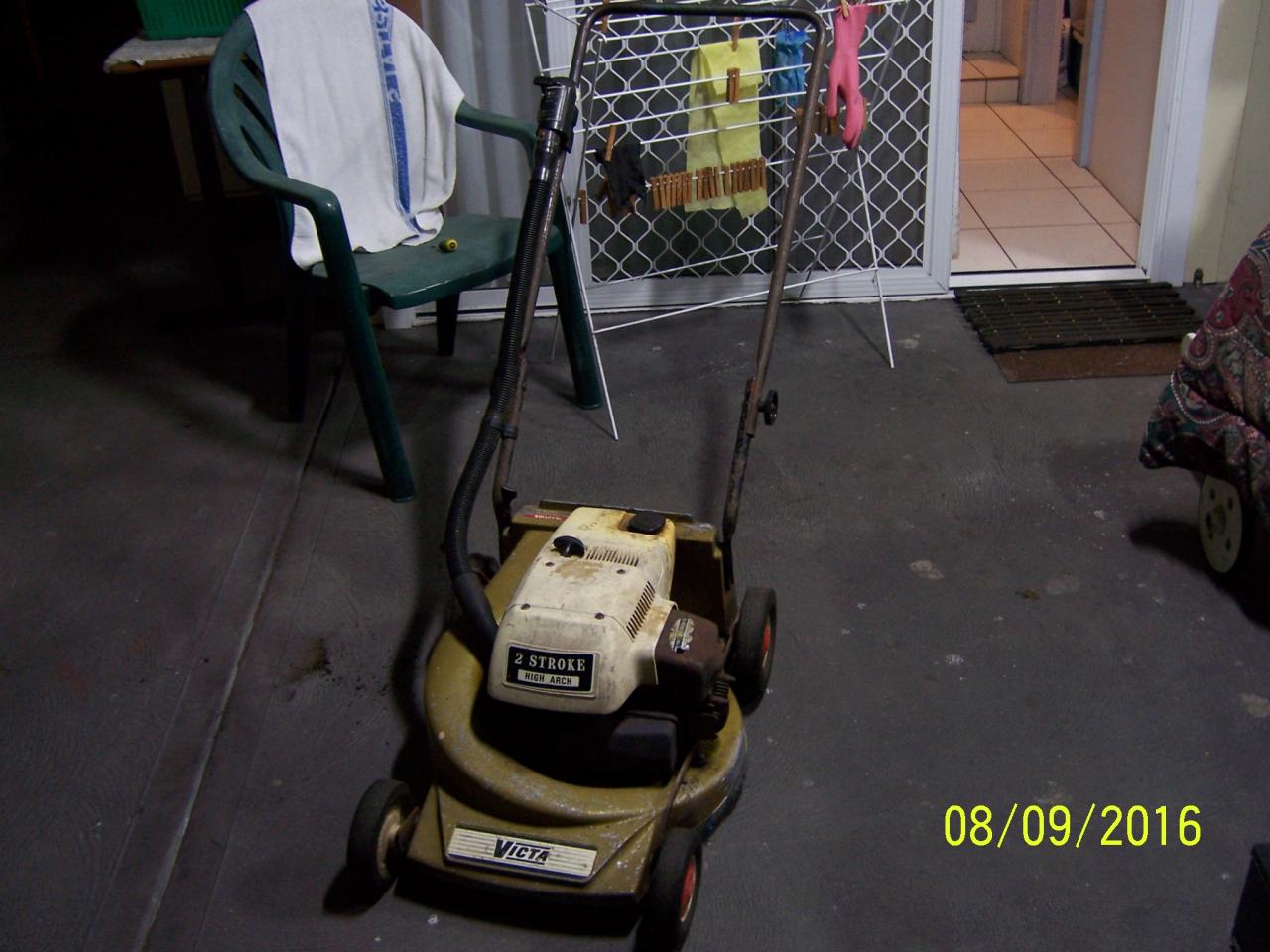

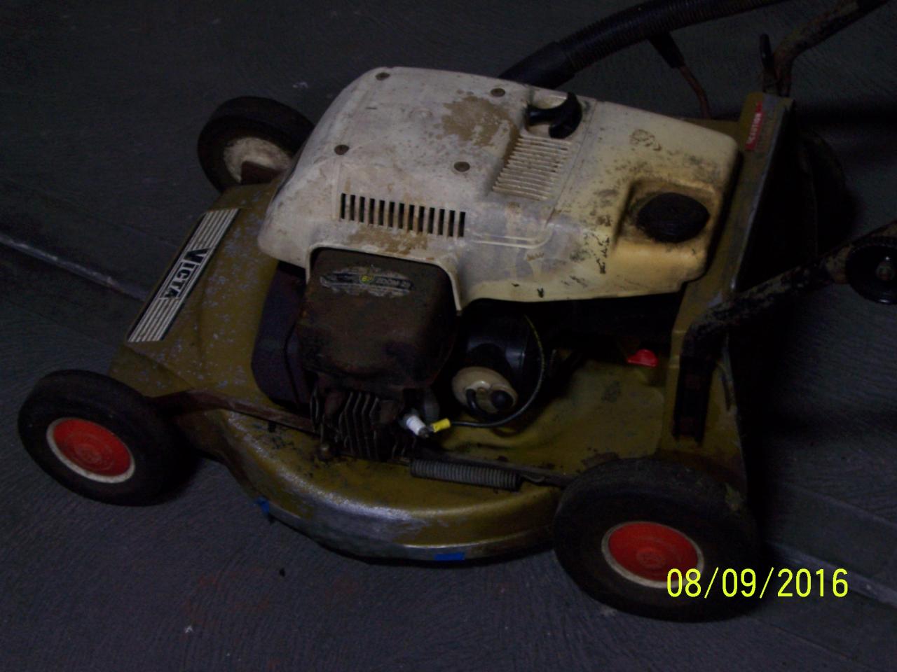

Hi. Recently got this now quite rare Victa hi arch to do up. Was originally aiming to make it a showroom special, but that would mean I could never use it and I won't have that, so I intend on a refresh to make it presentable again after years of mowing duty.
I have become stuck on sourcing an acceptably close match to the yellow gold hammertone finish and the only one I have found so far is a company called Vernici in ITALY that has what seems a very good match, but alas, on contact (via email) they replied they don't sell to Australia, EU only. I may try calling them to see if they make an exception upon speaking with me.
I would much rather exhaust all possible local solutions first, before trying my luck that way.
Also, can you still get nos axles for this frame, as the stubs on front and back have become loose on the right side(!)?
Any leads would be appreciated immensely.
Here is the mower, a budget model hi arch series with 125cc and a pic showing the repair I have done to the badly worn edge of the aluminium deck.

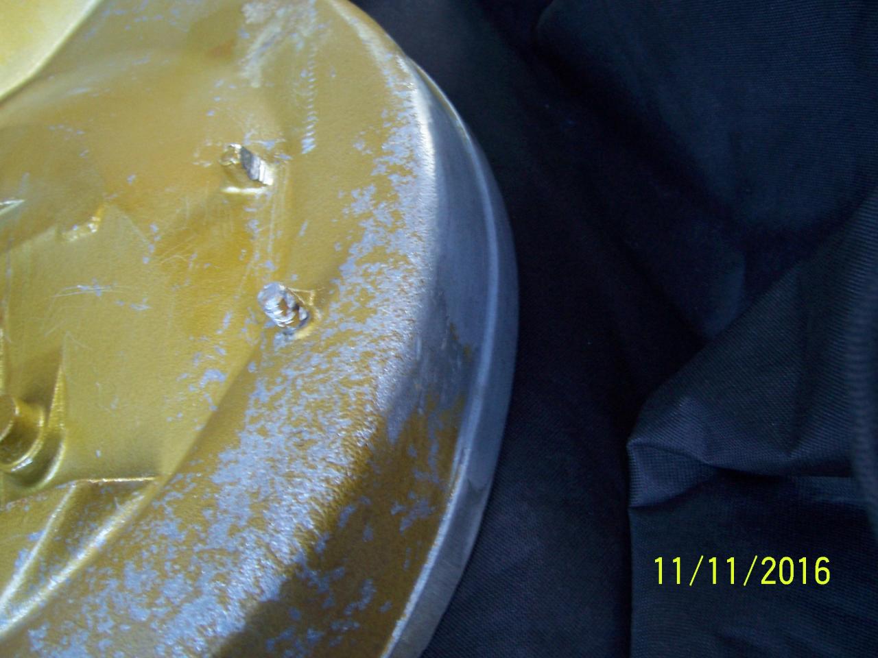

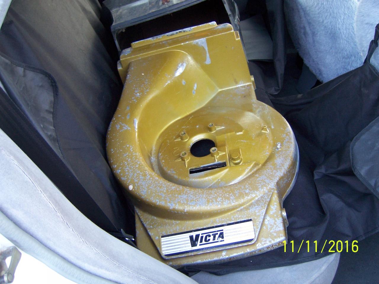

A few more pics showing the filling jobs I did with epoxy filler ready for paint.
All four axle locations were worn away and so I applied Selleys Knead It Steel. The brighter aluminium in contrast to the dark grey epoxy filler shows how worn they were.
