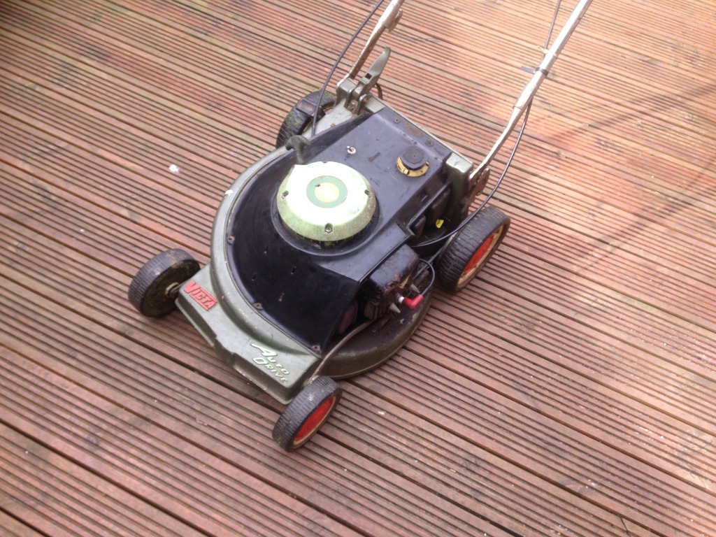

Hi All,
For a while now I have been looking for one of these, I don�t know how common they are in Australia nowadays but I cant recall seeing any for sale here in the UK for the last few years... anyway, I found one..!! (sorry I cant figure out how to link pics to the post)
It has the original green catcher but it is going brittle and has cracked in a couple of places. Is there anything that can be done to repair/treat them or is it just a case of shutting it away in the dark for the rest of its days?
It�s obviously had a few parts replaced over the years, the throttle lever and engine cowl are not original. The air filter snorkel is split in several places where it joins the filter housing and the filter housing itself is broken off its mountings but I have the cap with the "V109" code on it. I really like the retro �Auto Drive� lettering on the base; it would be great to find these parts including that original lime green engine cowl and get it back to somewhere near how it should be.
The engines piston, rings and barrel look fine through the exhaust port, it has good compression and no signs of scoring. The engine number is: 20720 71 92 (does that make it 1971 or 1972?)
I am starting to wonder if this will be too expensive to restore back to near factory condition? I found what I think is a 1982 Victa Power Plus last year that needed a bit of work, mainly a good clean up, new handle bars, carby overhaul some paint and a new drive cable. I love it and use this mower regularly now. I don�t think I will put this one back into service though, maybe just start it up now and again. Is there an alternative catcher I can get for it? Also, does anyone have that lime green engine cowl for sale?

Hello Alan
A warm welcome from us here in OZ [even as we approach our Winter].
Victa made a huge impact in the UK at this time.
... And I feel they showed the world what a good rotary would look like.
Linking pics is easy-peasy HERE.
I hope someone has an answer to that - but some plastics seem to be time-limited.
I don't think so, but I am not a collector or restorer.
I hope our experts will comment.
These are not common machines nowadays, and this was a great model
that consolidated Victa's reputation.
I feel this is a project that would require some dedication though.
We appreciate you reminding us that Victa had a significant presence
in the UK in the 1970s.
Great to hear from a UK enthusiast.

The catcher is a model 27 and I am not sure but I could have a new old stock one available but the freight would be more than what the catcher is worth as they cube the box.

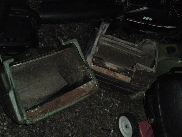

Hi All,just thought I would show an image of the black model 27 catcher,the
green one is a model 22.
The Autodrive catcher has clearance on one side so it does not contact the self propelled gearbox.
With out this clearance the catcher will not fit on. These catchers are not in new condition.
