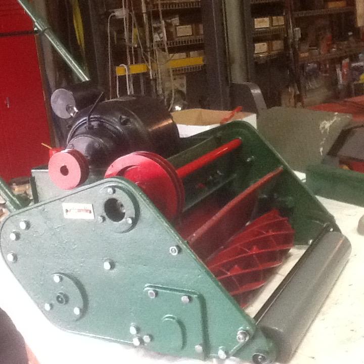

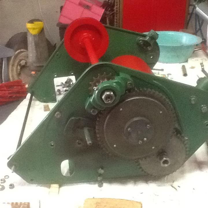

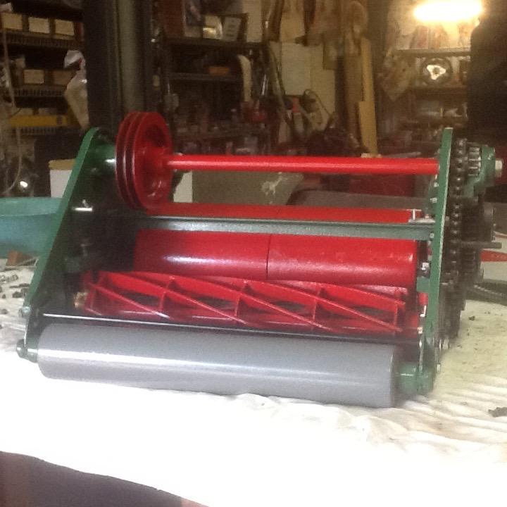

Being a lovely day when I should have been doing other things, I am somewhat excited to report that my memory returned enough to allow me to recall where most of the parts to this thing belong.
Although a good way off being finished, the photos below show today's effort.
New engine cover yet to be painted so that I can do justice to Grant's excellent stickers.
Wiring not yet started as I am having trouble locating fabric covered wire of similar heavy duty as the original (the old car wire is simply too light gauge).

Hello John nice work there. Keep us posted.

Thanks for your interest in this guys. Aussietrev, I had a electrical friend look at the mower when it first arrived in my yard and he gave it the all clear at that stage, but since the recon exercise, no-one has looked at it.
You're quite correct BB, nothing is original once the first bolt & nut are replaced and when I think about it, the wiring runs down the handle, through conduit under the motor and then it's attached under the engine cover, so it can't be seen anyway.
I've had it apart and together 4 times this weekend because of silly little things so I intend to give it a wide berth this coming week.
Thanks for your tip Gadge. I don't know much about gauges etc, but the cloth covered wire that came out of this old girl is very much like choke wire, its that heavy. I've had to rebuild the 3 pin plug connector as the Bakerlite was broken away in places, so I will get my mate to check her out electrically prior to any tests.
