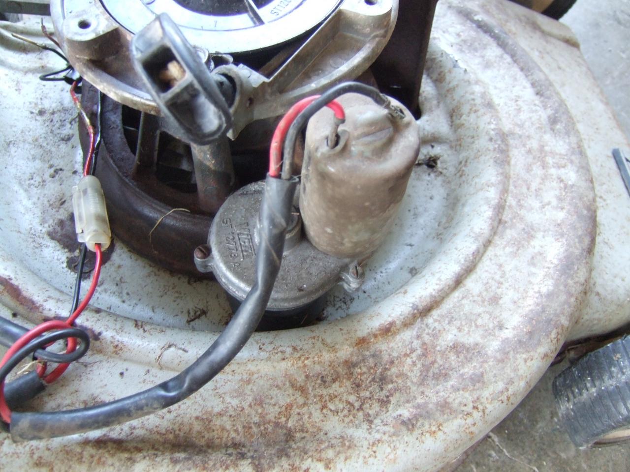

This electric start looks like it wold fit any PT , as they have gap in the plastic fairing and lower flywheel cover...

Maybe get the engine off the other one. Does that go? You can test the starter motor by connecting the terminals to a car battery via jumper leads.
That's how I tested out my Mustang key start before spending on another battery.
Posts: 960
Hi Speedy, nice pickup, the starter will fit others but you'll have to drill the block and tap the threads to mount the starter and change the flywheel and coil wiring loom also.

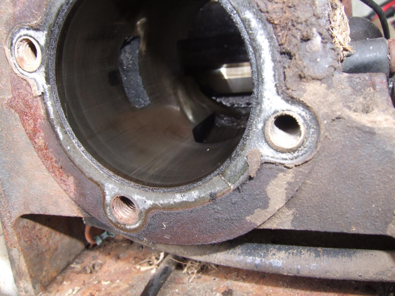

Took the head off, starter, need a new big o ring of course. rings were not worn thin.... a bit of blow past and burn on the piston. No oil ring n the lower ring....
Fitted the piston to barrel, no gap , or no piston slap... good bore.
Took the rings off the piston and cleaned the grooves, and rings, rings look like new. scrape carbon off.

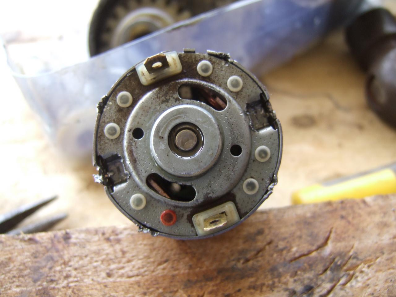

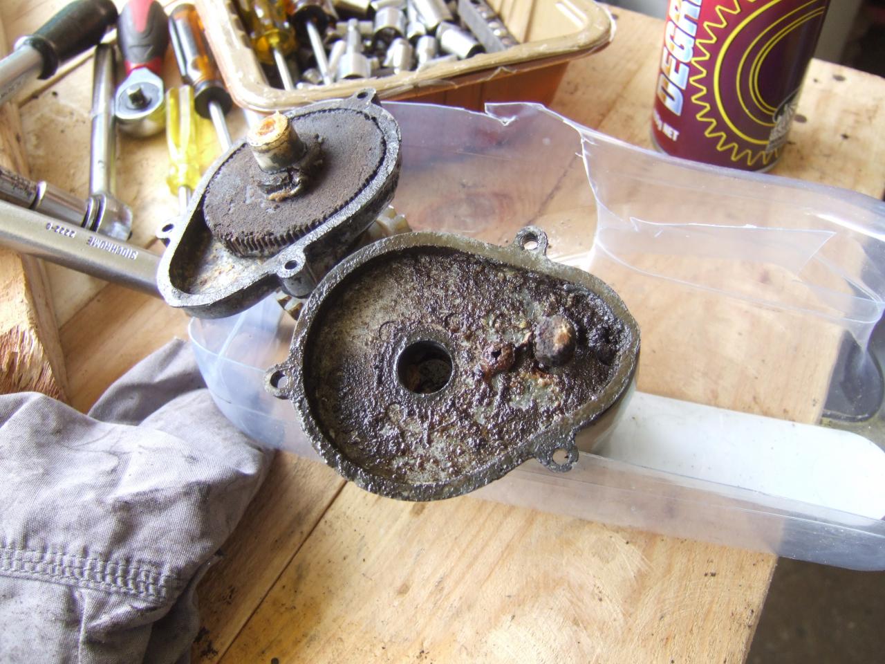

Now I can take the motor off and take off the electric start. Took it apart, full of gunk..... all gears in tact, but the motor is frozen. Sprayed it blew it out and put some wd40 in to soak it .....
I want to free the rotor in the starter motor...... it will probbaly be OK, just needs a big cleanup.
Only problem it is a throwaway motor, with pressed down lugs to hold it together. I am going to have to prize them open......... I hate getting beaten by modern technology................. If I can't fix the motor, it will be a pull start......... but it will work.........

I was playing with motor today and cut two slices down the middle of those two lugs. It made them easier ti lift uo, and lifted the other pressed in pieces. Got the end off with the brushes, perfect, put some wd40 on again...... ttwisted the armiture and it moved, then freed up. Blew it out with air and some more wd40, put the end plated and bushes in place and applied 12V, motor is sweet, so I tapped down the lugs and oiled the shatf. Looking good so far....

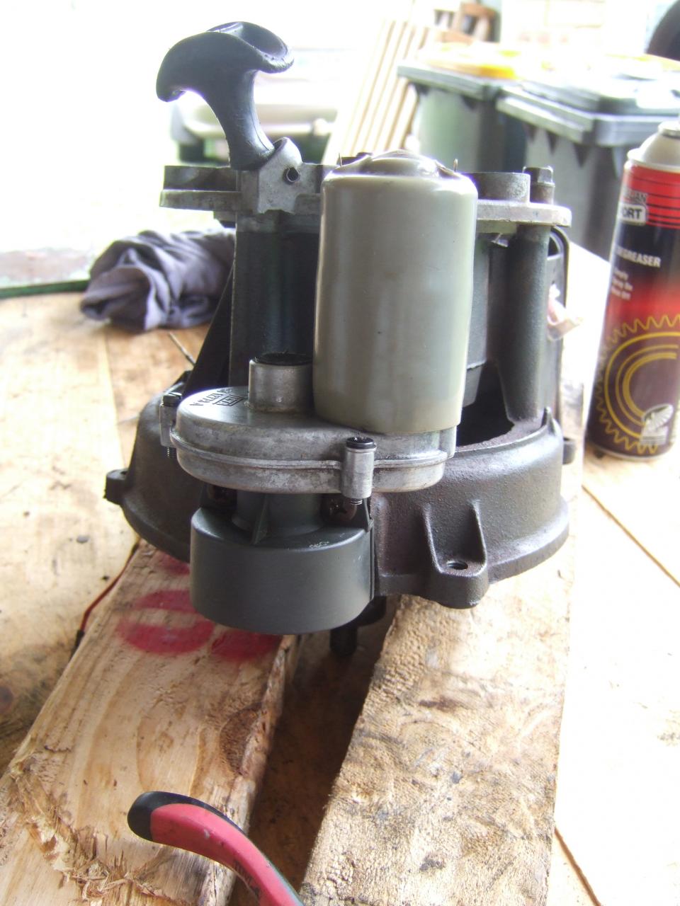

Put the starter back together the proper way.....
Just need a module and have to make a pine prame for my molasses bath and soak a few bits for 3 weeks............. got some Aldi metal paint $9.95.....
I have a good Deepriver 12 V blue battery which moved the motor. It was off a electric pushbike but should do the jub, just have to adapt a carrier for it.....
See you in a few weeks.
The rains are here in Bundy and with a bit of [Linked Image]
heat, GRASS...... to mow.
speedy
