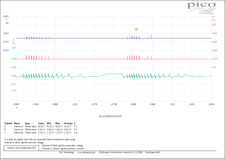

I also have spent countless hours trying to diagnose a very weak spark on a full crank Victa 160 engine.
It would only spark intermittently with a clean and perfectly dry spark plug with the gap reduced to 2 thou. Even then, it would only spark if it was rotated rapidly with an electric drill.
The coil and module all worked when swapped over to a replacement Victa 160 engine that Norm kindly rebuilt for me so I could get the mower back to the customer.
The engine does have a bent crankshaft on the flywheel side, which I think must be the problem, as the very weak spark when rotated at high speed indicates there is a not enough magnetic induction to allow the coil to produce a spark at the proper voltage.
I have got an oscilloscope reading of the coil output that I'll locate and post.
At the moment, I've had to put it aside due to many other jobs that still require attention, but I hope to try at some stage straightening the crank and fitting another flywheel to see if that fixes the weak spark.
Joined: Jun 2013
Posts: 407
LRT Offline
Here is the oscilloscope waveform of the Victa 160 ignition coil:
The secondary voltage is only producing a maximum of 2.4kV and isn't producing a proper voltage spike.
Generally, the operating output voltage of a small engine coil is up to 6kV, depending on resistance in the HT lead, plug gap etc.
The blue trace is the ignition primary voltage.
The red trace is the ignition secondary voltage.
The green trace is the ignition primary current.
In another post I'll illustrate what the ignition secondary waveform should look like.

Joined: Jan 2017
Posts: 349
Hi, Is that Victa waveform from the motor that will not go? It sure looks odd, the B&S one is what you would expect.If it is from the crook one it would good to know what it is from an engine that runs.
