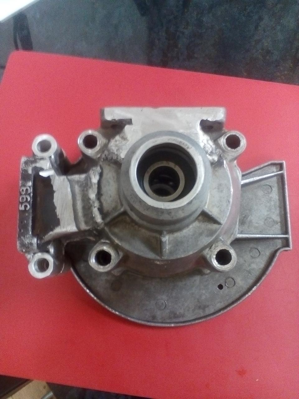

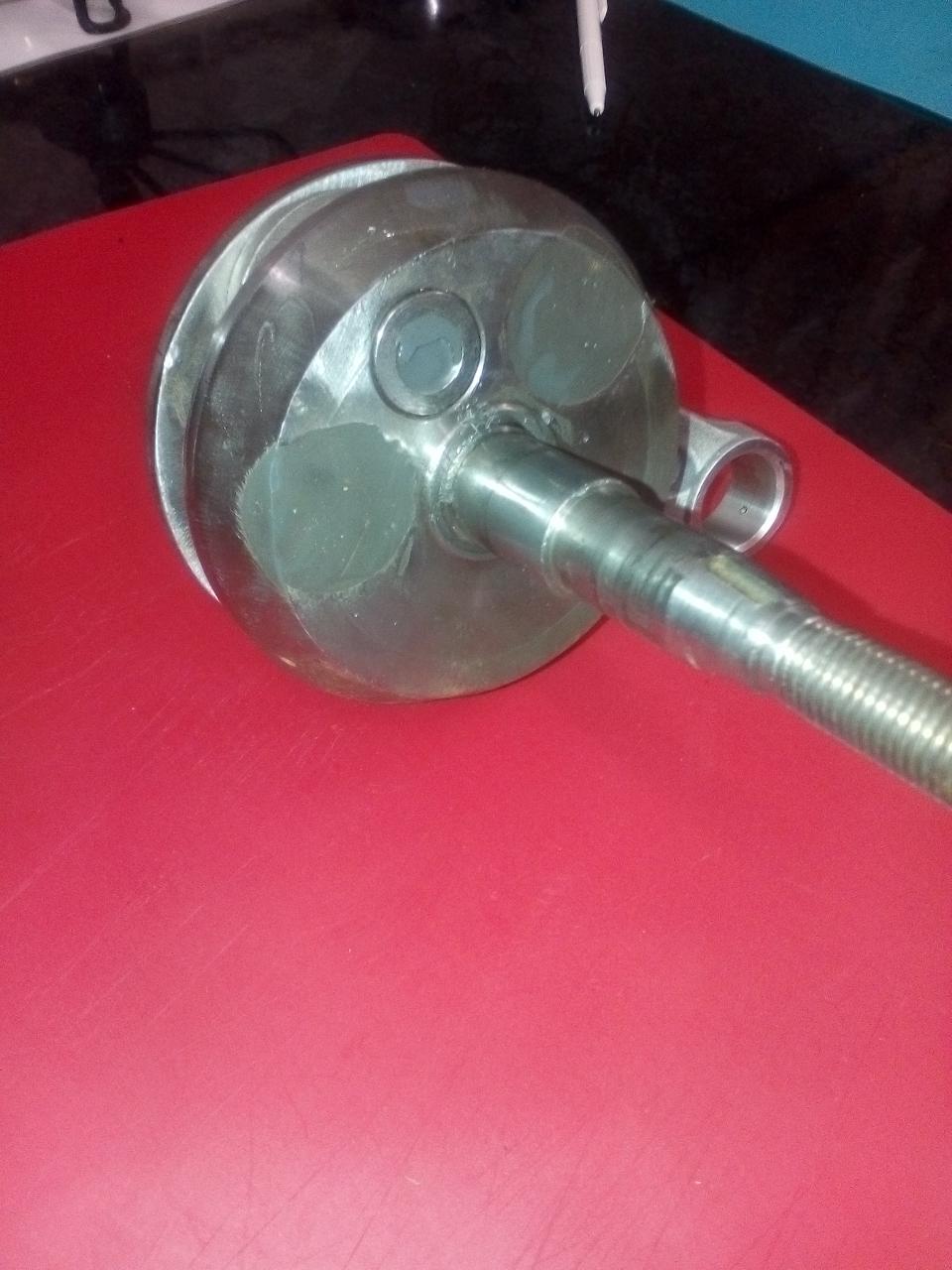

Hey guys, I'm Casey and I'm New to outdoor king. I'm a massive victa enthusiast and for the past couple of years I've gutted plenty of mowers, 160's and early and late 125's but been modifying primarily victa 160's, trying different things as I've gone along, had failures and triumphs to varying degrees.so far my best setups have been a 5400 rpm twin g3 carbyd full crank 160, a 7600rpm full crank side start 160 with 25mm tillotson and a 6000/6500rpm 160 with full circle crank,reed valve and 25mm tillotson. Currently working on a crankcase reed valved full circle 160 with squish band head and expansion chamber setup. If anyone's done performance mods with victas and wants to exchange ideas and go into more details as to the stuff I've done then I'd love to hear from you. I wish I could upload pics on here of the different things I've done but I'm not that computer savy, but I'm able to email pics of some stuff if anyone wants. Anyway, hope to be talking soon to any of you guys who share a likeminded interest in squeezing more grunt outa these old victas. Cheers

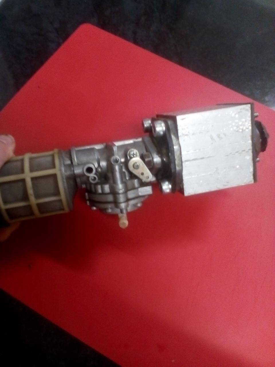

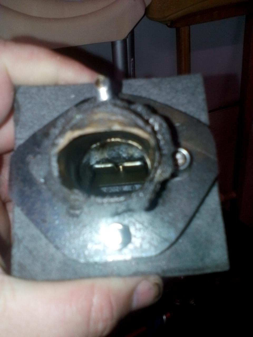

Yeah that thing goes pretty good hey. That carby is a mikuni. I've got a 24mm mikuni I'm gonna try on my crankcase reed valved 160 with an expansion chamber off a 125 or 157 2stroke dirt bike, I'll also try my 25mm hl tillotson, and maybe try a twin walbro setup. It'll also have a squish band head off a Suzuki ts 100. Along with opened up transfer ports that flow into the crankcase, enlarged exhaust port and crankcase stuffing, hopefully it'll go real good. If it works well then I'll look at casting my own reed block crankcases which will be able to be used on not just 160's but victa 125's as well. As the later 125 victa crankcases are interchangeable with 160's I can cover both sizes. The only differences between the 2 really are the cylinders which have the same bolt pattern at the base, and the come of and crank pin. Happy days eh?

Finally figured out how to upload pics. Happy days! Lok

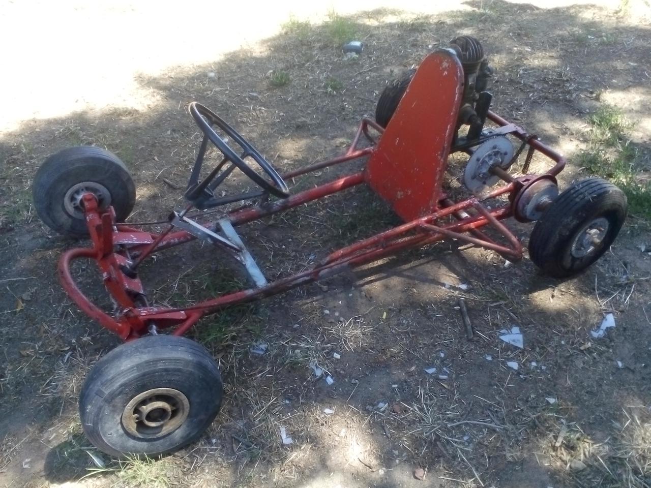

G'day folks,
Over the years, the go-karters have tried just about everything imaginable, to hot up Victa engines.
Just plug the search term 'Victa go-kart' into the Google Custom Search window above...

This type of go kart would be the type your talking about gadge. This is a 1960 vintage kart that I'm going to end up racing or "demonstrating" as the vintage Keating boys put it. Lol. It'll have a hotty reed valved methanol burning victa 125 powering it. From what the vintage kart guys tell me, it's the 125's that they really get screaming. Apparently the 160's aren't quite as good to get power out of as the 125's and therefore not many people have bothered spending the time modifying them. Seeing as how 160's are more abundant at this point in time, I want to see just what kind of power I can get out of one without completely having to re invent the wheel. As Martian Luther king said "I have a dream" but mine is more simple and fun, consisting of go karts, drift trikes and motorised bikes powered by hotty modified victas.
