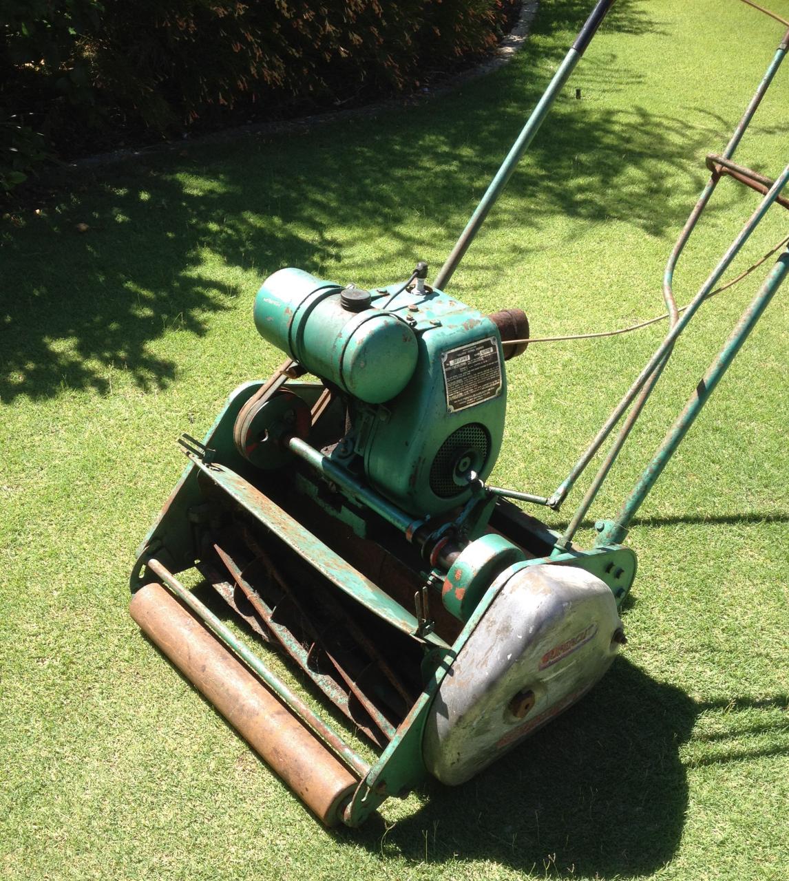

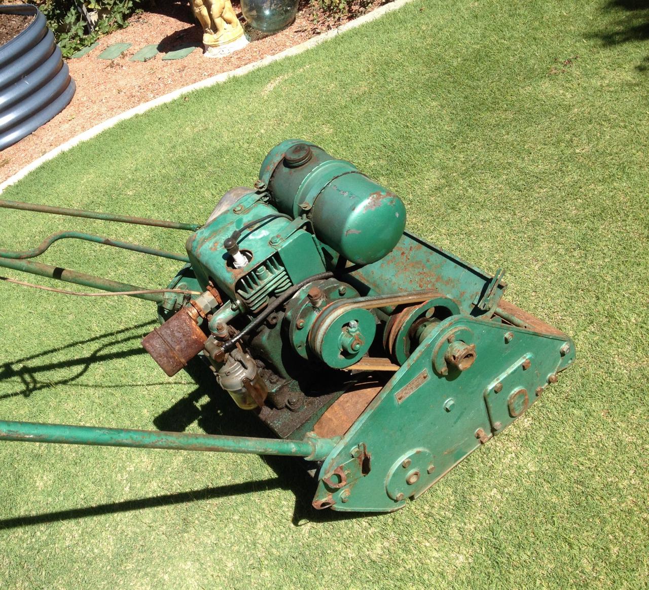

Just acquired a Supercut 20" will have to put in shed for now until ready to restore lol ![[Linked Image]](https://www.outdoorking-forum.com.au/forum/uploads/usergals/2017/03/full-10568-33286-img_1217.jpg) ![[Linked Image]](https://www.outdoorking-forum.com.au/forum/uploads/usergals/2017/03/full-10568-33287-img_1214.jpg)

That is a nice mower there Ken. Is that a Villiers mark 12-2 on it? I have that motor on a compressor that I made up. I look forward to seeing photos of it restored. Good luck with it.

Hi Ken & Hermosil,
Still quite a few of these later Model 17's out there sitting around not being used. Yes that's a Villiers 412 RD fitted as it runs in reverse with the belts being on the outer and not the inner section of the shaft.
Honestly that one doesn't require restoration, just tidy it up and put it back to work. It's a Survivor !
Cheers, BB.

I got the engine to run ok but the mower has a seized clutch. I will look into that after I restore the 18" two stroke

Hi Ken,
Those clutches can be easily freed up. I have one that was so badly rusted and I still managed to get that to operate.

Hi BB, Have put plenty of Penetrene on the shaft to soak when maybe some heat

Hi Ken,
They respond well to a bit of a gentle tapping with a copper or brass soft blow hammer after they've been well soaked with Penetrene as you are currently using.
