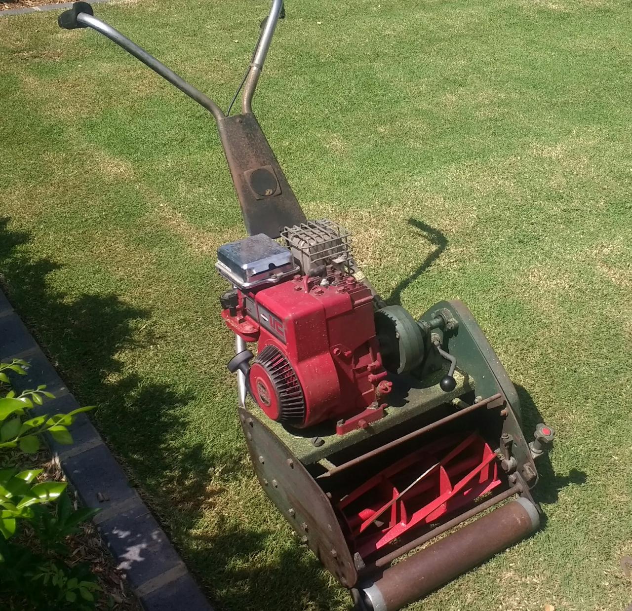

These forums have inspired me to restore a 14 inch scott bonnar 45.
I plan to pretty it up a little bit and chuck a honda gx120 on it.

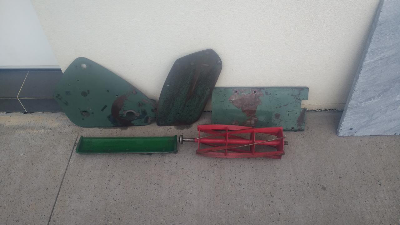

So far I have pulled apart my machine and sent my frame off to get it back to bare metal.
I came stuck with a couple of issues though and would be appreciative if anyone could help me out.

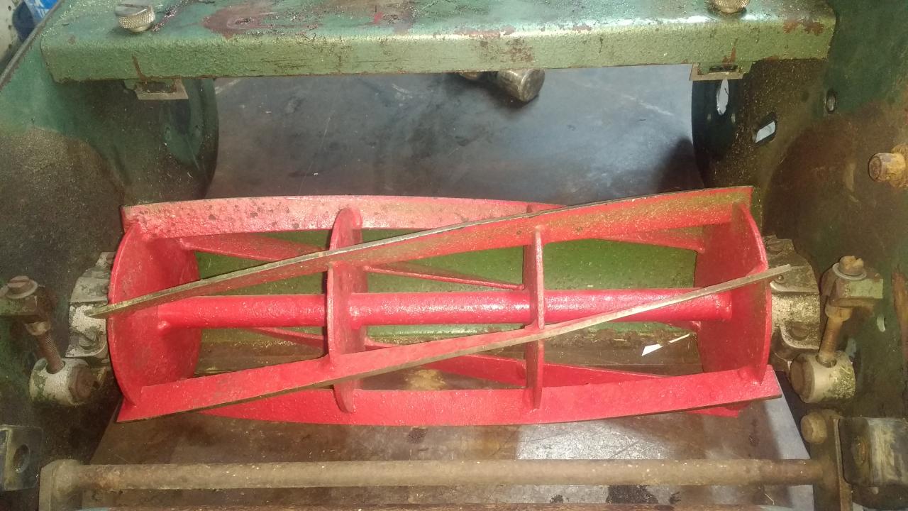

1. My cutter chain adjuster slide is worn and needs replacing but I cant seem to find one anywhere. Is there any alternative solution?

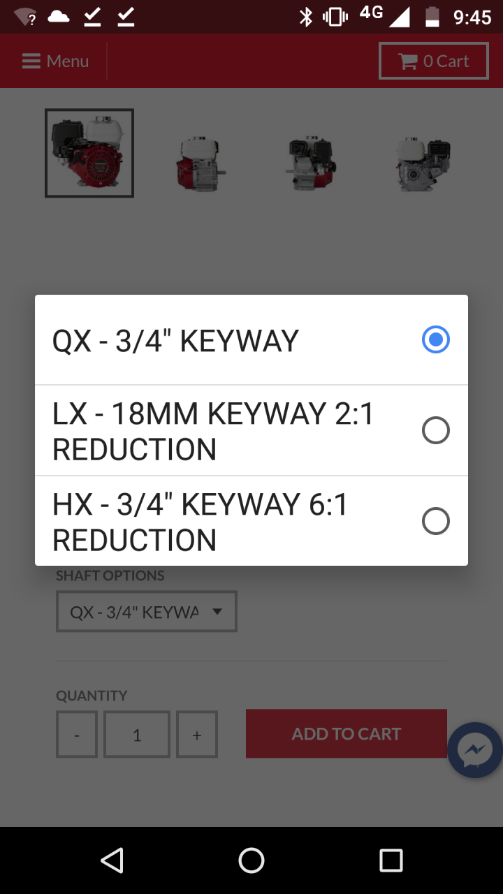

2. I'm about to order my GX 120 but i'm not sure which option to select for drive shaft length. I have a 3/4 Clutch.
Any help is appreciated.

Hi "I hope not",
That'll be a massive engine on a 14 inch machine, actually overkill. It would be more suited to a 17 or 20 inch Scotty.
What's wrong with the current Briggs that's sitting on it ?
BTW that cutter chain adjuster is no longer available and can only be substituted with the series 2 black plastic unit that will require the slot filing out so that it fits in place with a washer and the original nut back on the stud.

Hi ICMFO,
Just seems to be a huge overkill on a machine of that smaller size. When you think that SB used a 2 Hp powered Briggs on the 14 inch machine the engine you've selected is just way over the top. If you had a 20 inch Scotty I'd say OK, anyway your call.
BTW, you might find that the engine will not physically fit onto the machine due to its sloper design and thus clashing with the handlebar. You would require a set of handle adaptor plates to space the handlebar out from the chassis.
That's a better-than-average Briggs, too - I/C means that it has a cast iron sleeved bore, not plain alloy.
