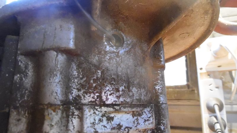

Joined: Jan 2017
Posts: 50
" Don't worry, if it ain't broke, I'll fix it for ya"
Posts: 1,842 Likes: 14
That's the kill switch wire. The HT lead is gooone!
You will need to pull the coil off, to see where the HT lead fits. Straighten out that wee brass tab, and disconnect the coil LT wires from the points/stator plate.
Pull the coil outwards off the stator post. In the boss that's on the side of the coil, there's a deep hole - which should have the pointy end of a self-tapping screw visible down inside it.
Cheers, Gadge

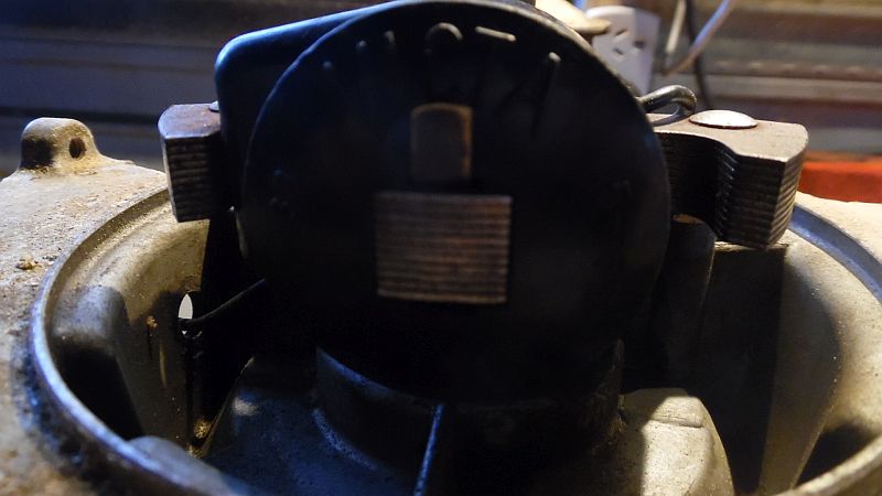

Posts: 8,214 Likes: 234
Gazza, if you remove the points plate and turn it over you will see where the plug lead screws into the coil
Norm, I was avoiding removing the stator plate, so as to avoid having to re-set the timing!

Ok then....mission accomplished, no broken tab and a nice clean hole with a shiny visible 'self tapper' threaded spike pointing back at me as I shine the MagLite down the hole.

Gazza, if you want to make sure that re-bending that tab after replacing the coil won't bust it, see if you can anneal it first. A couple of points [pun intended] on magneto etc reassembly: - When you're ready to replace the flywheel, fit the square key to the shaft keyway first, and make sure the end of it is fully seated in the points cam notch.
- The washer that should be under the starter cup nut is dished, and is fitted dished side down [i.e. convex side up].
Cheers, Gadge
