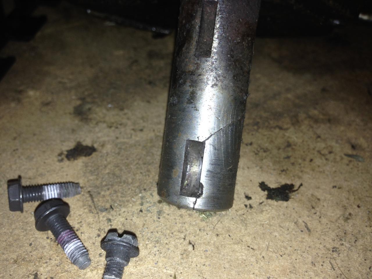

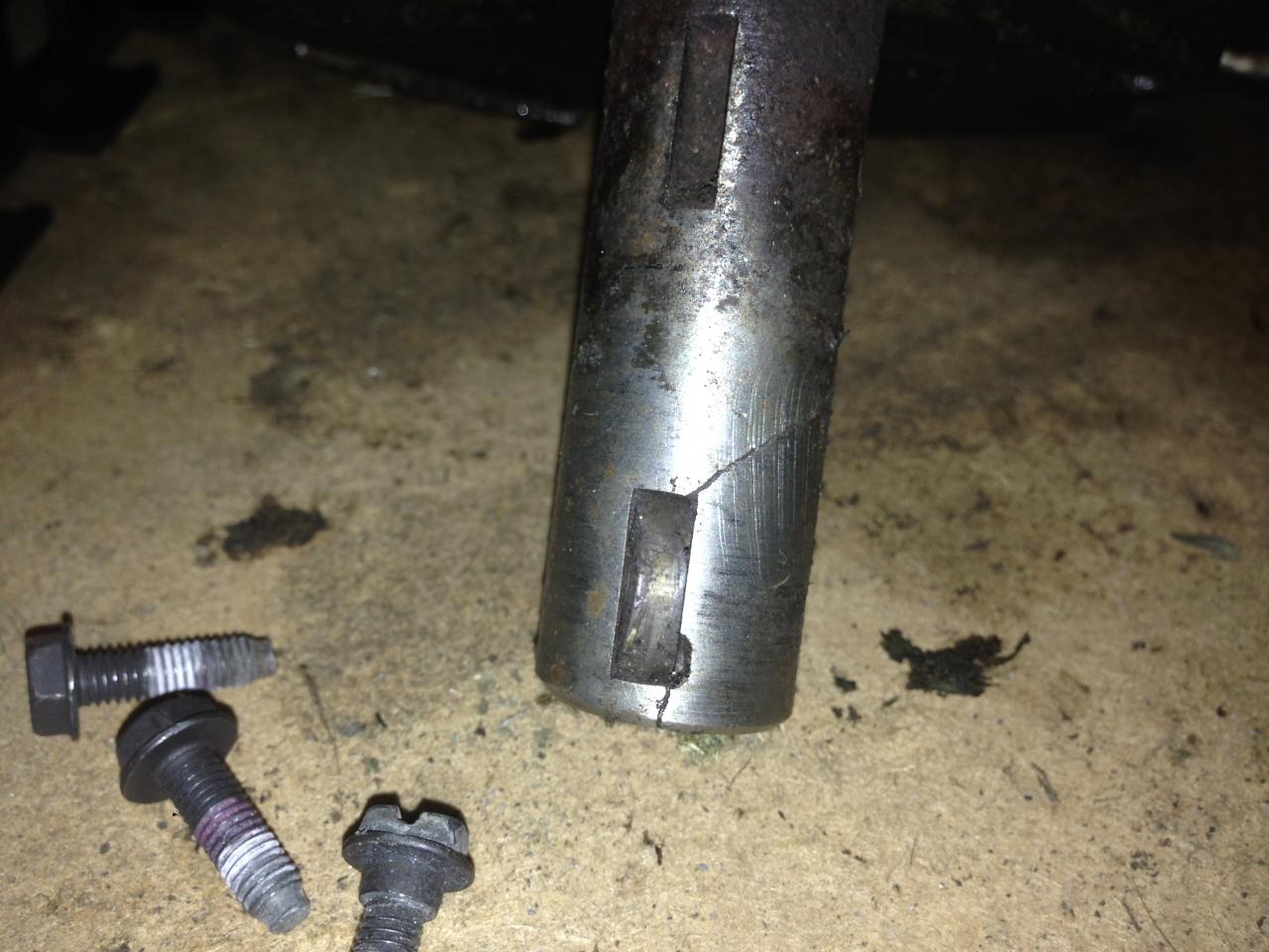

I thought I should add some photos of the problems encountered to add some depth to the topic. This example cracked quite low but others have cracked well above the blade boss.
Any thoughts would be appreciated.

I'm only an amateur here, but even I'd say it looks like very poor quality metal that has resulted in catastrophic fracturing. This would be VERY dangerous to use. I have seen this happen before with bosses and even cranks, but usually after hitting something very hard. I cannot remember the brands.

I still have only seen this issue happen on 4 blade Masport mowers. This one snapped/cracked low and the other which I didn't get a photo of snapped higher.
My thinking is it might be related to the design off the boss and blade plate. I have never seen this happen on a Victa or a Rover.

Posts: 445
The fact the shaft in this instance cracked around the key makes me think the fault is in relation to the design of the boss. Gadge will no doubt chime in with his comments on the photo.
Good pics there, Jaffa J.
I don't really think that's due to a design fault in the boss. The only way the boss could contribute to that sort of cracking, is if the keyway in the boss is oversize in width, thus allowing/forcing the Woodruff key to tilt in the recess in the crank, and thus overstress the top edge of the recess, when an object strike occurs.
Those corners of the recess are obviously the points where the cracks started, and propagated from.

Gadge you are correct but the reason it fractures is as you pointed out earlier it is a hardening issue to begin with. This cracking is a direct result of that.
NormK, agreed. Typical brittle fracturing! Too much hard, not enough tough.

Gadge, Thanks for the clarification. It makes perfect sense.
I should note the other Masport's I have encountered (3 in total) have snapped well above the boss. Unfortunately I don't have any photo's of these.
This one was a little unique.
I will remember to take a photo of a completely snapped crank when I find another one. I just find it interesting that I have only seen this type of issue with Masport's.
