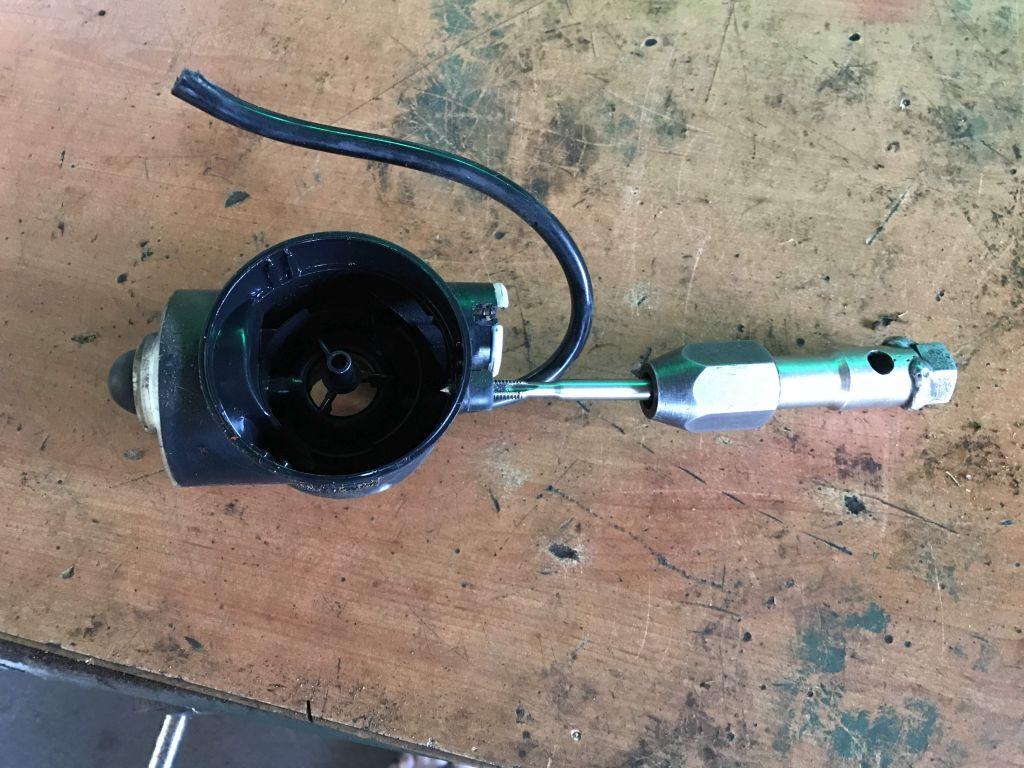

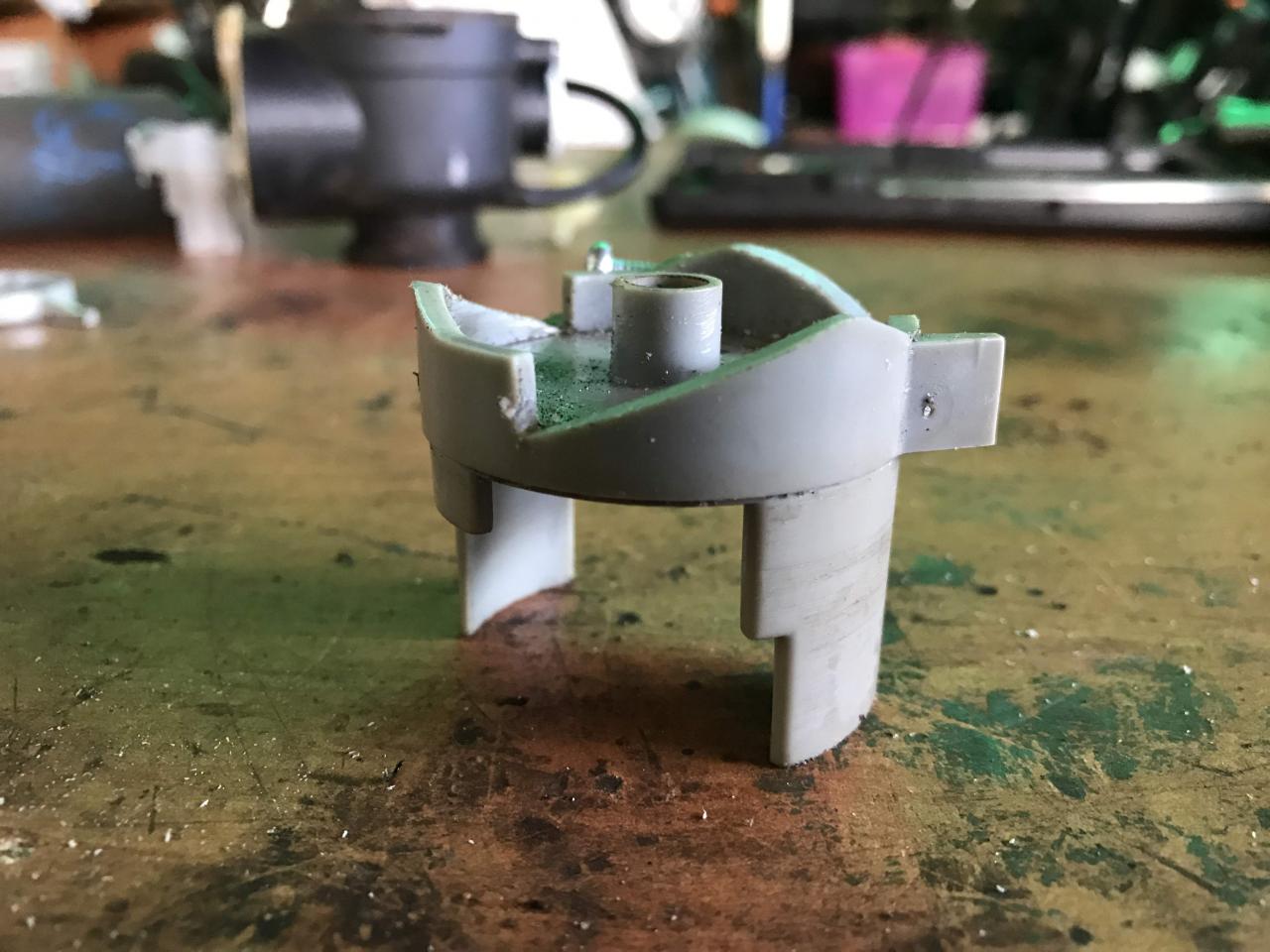

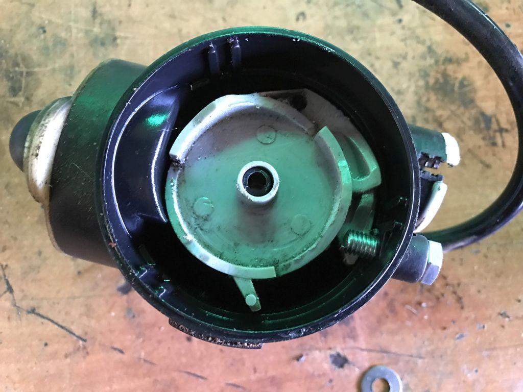

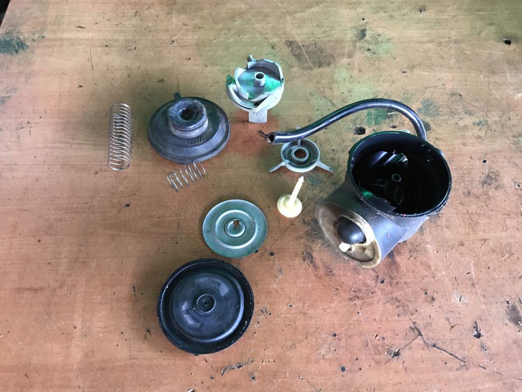

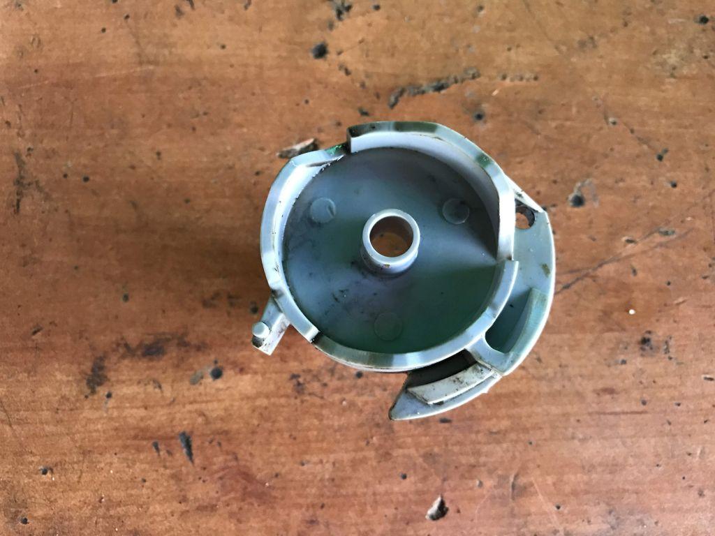

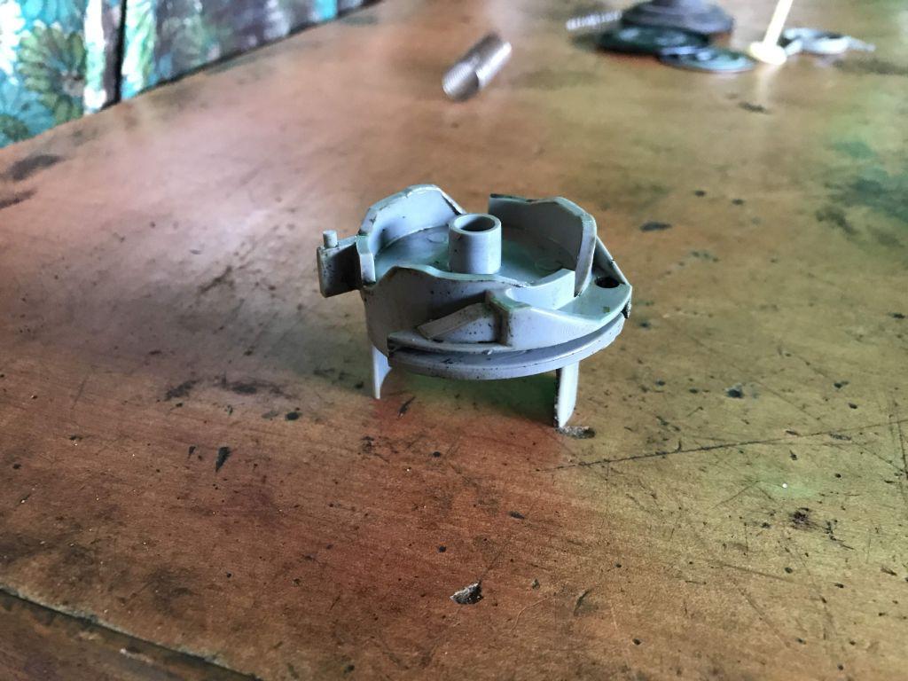

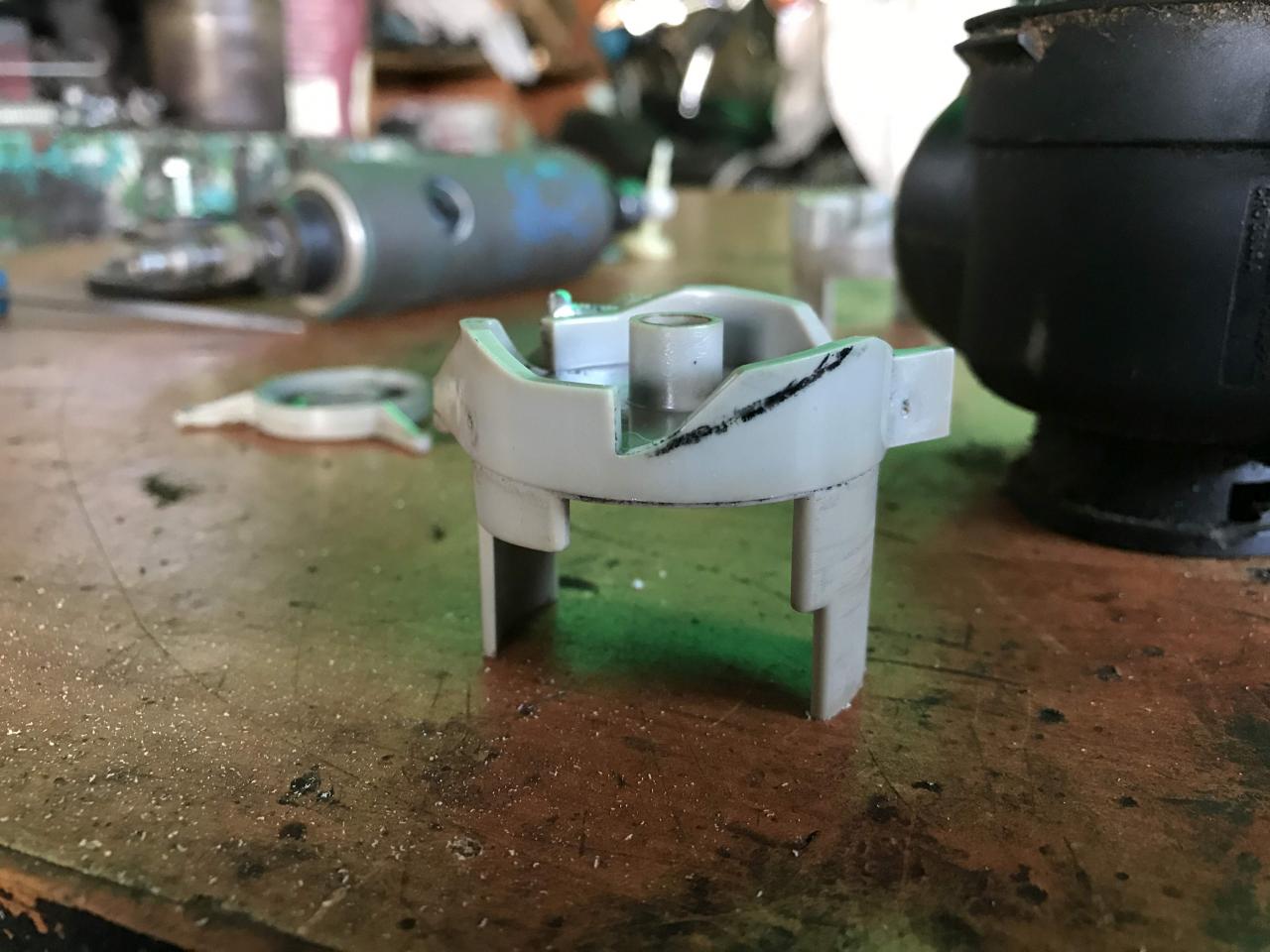

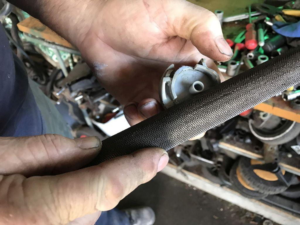

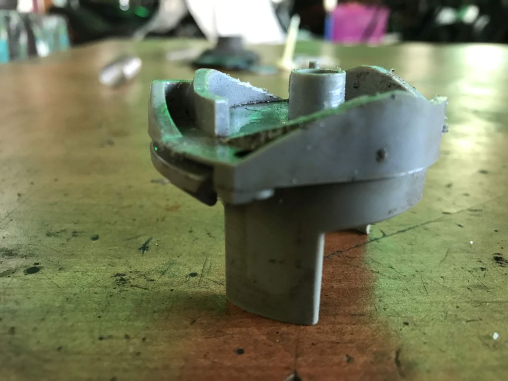

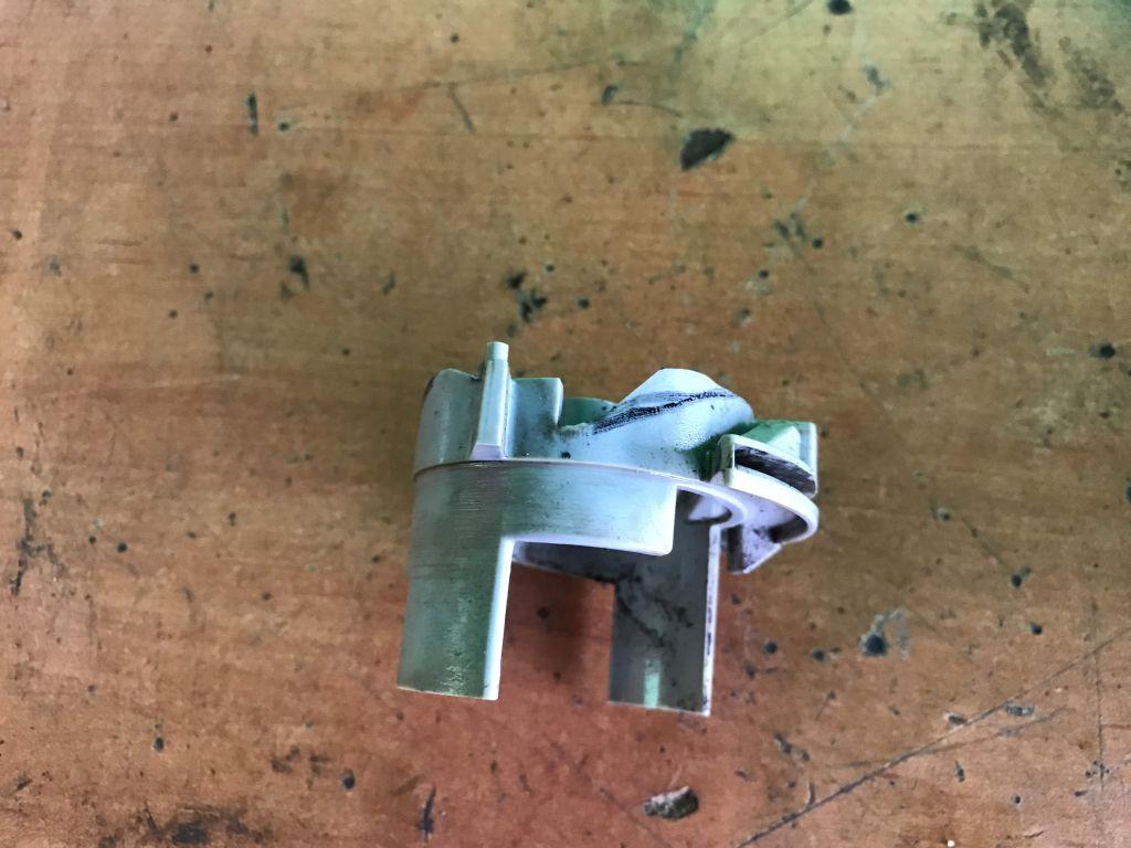

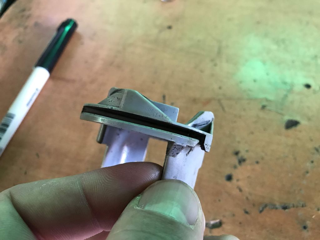

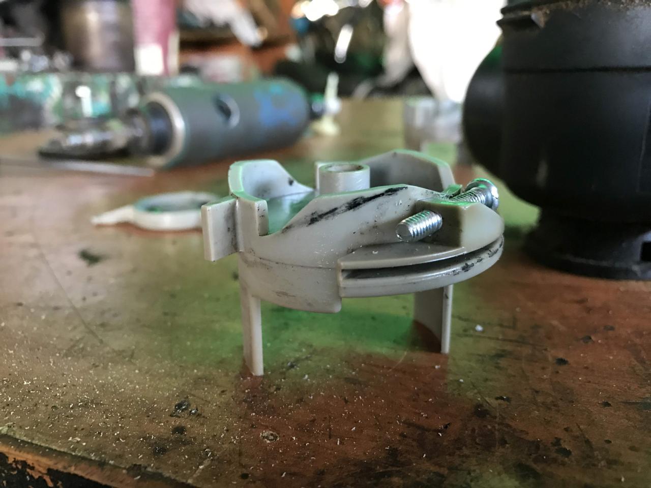

Here is a step by step detail of how to get a LM carby to work properly, G4 is at the end of this post, only difference is the cam modification, all other steps are the same
You will require a 6mm or 1/4 tap and two 25mm bolts (cut both of these to 18mm), 1 nut of whatever thread gauge you choose.
You also need a kill switch, this can be either a momentory contact switch or toggle switch, a little bit of electrical wire, lug and a connector

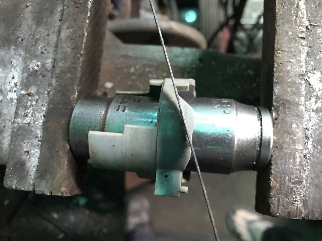

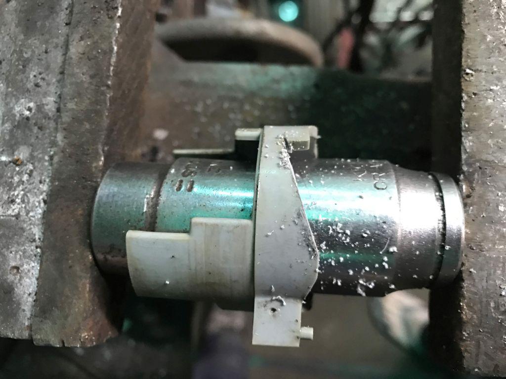

It requires a marker, hacksaw and 2 sockets to act as spacers to hold the cam steady in a vice, do not over tighten the vice as this will damage the cam
Thread this with a 6mm or 1/4 thread (whatever matches the bolt you have), cut this bolt to 17/18mm long
1 member likes this: Seanoss

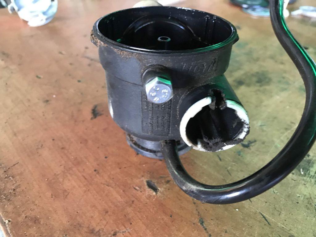

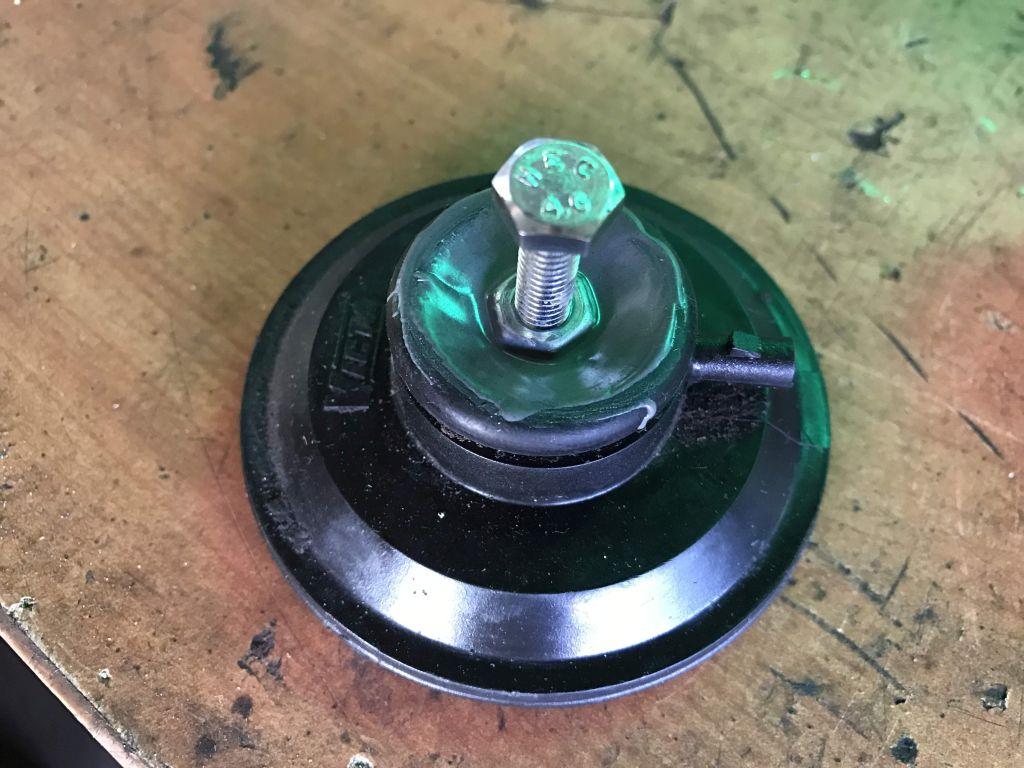

Posts: 8,215

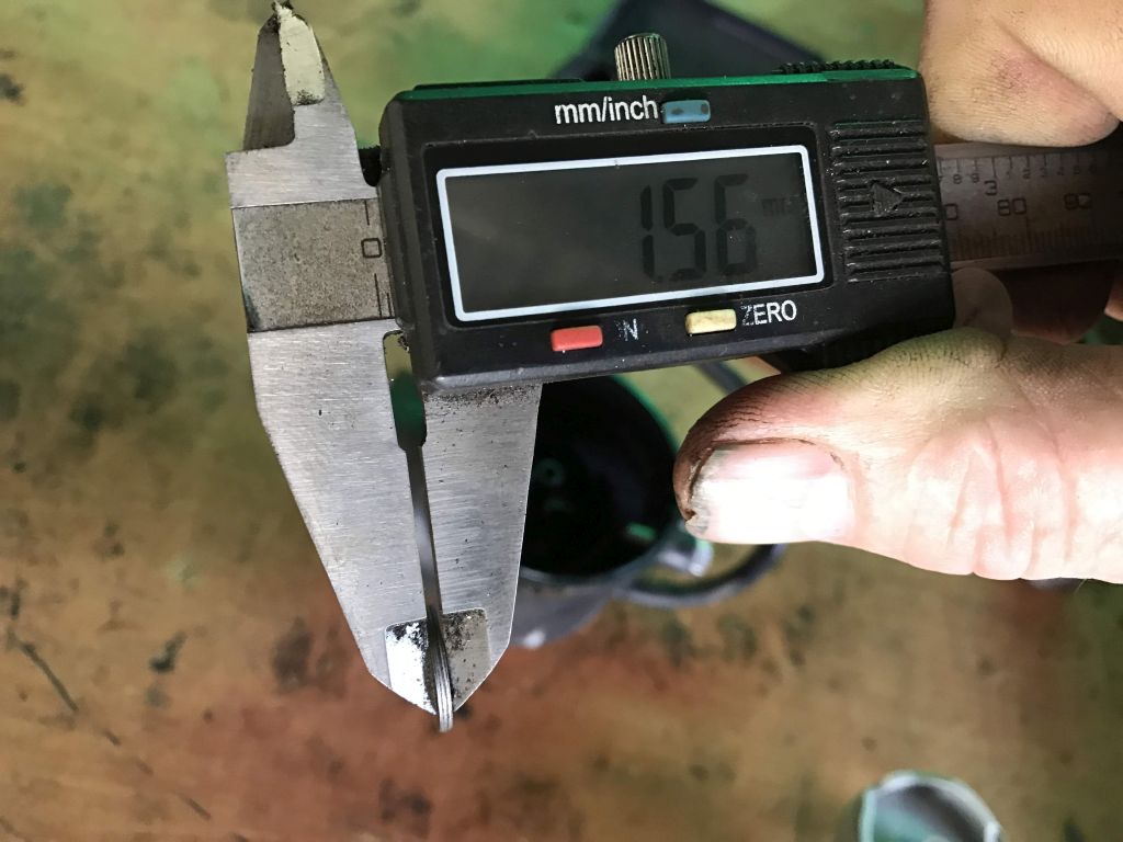

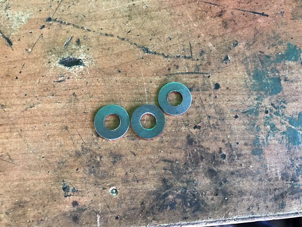

Total thickness of washers is approx 1.6mm
Thread this the same size as the kill switch hole

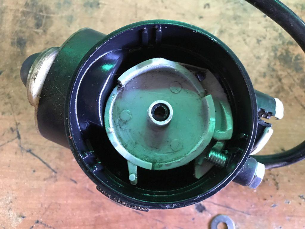

This is your new idle adjuster screw, this is the 2nd bolt you cut earlier to 18mm
Posts: 8,215
[Linked Image][Linked Image]

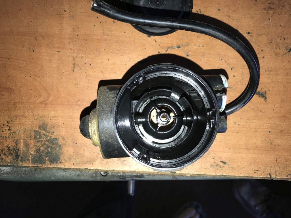

You no longer use the factory kill switch, use the momentary contact switch as shown, just fit one lead to the frame and the other wire to the wire that comes through the side of the original kill switch, the other wire is just cut off.
Once you have everything re installed and the motor running, you then adjust the idle screw as shown above, to set the engine rpm start the engine, pull the throttle back to stop position and then adjust the idle screw to get the idle revs you require.
1 member likes this: Colrose

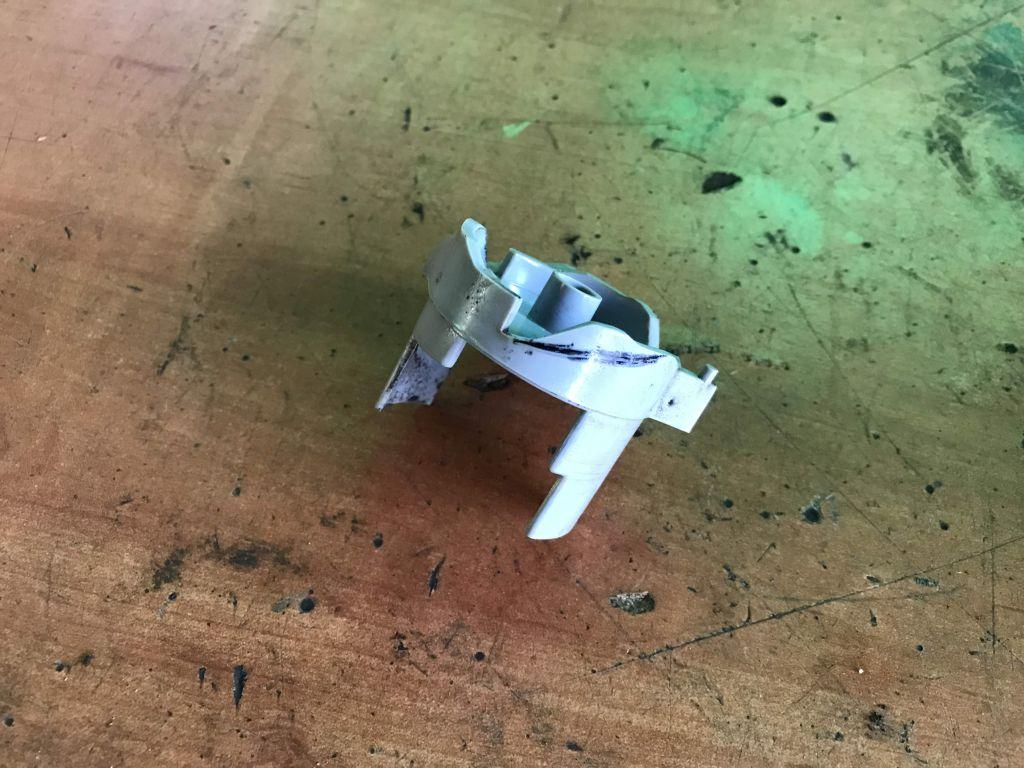

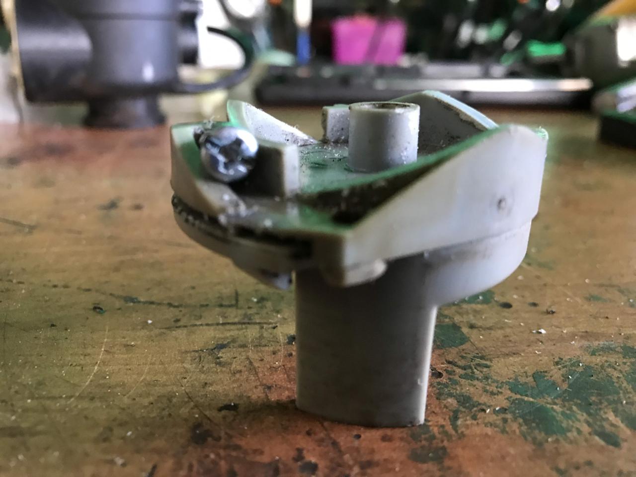

Posts: 8,215

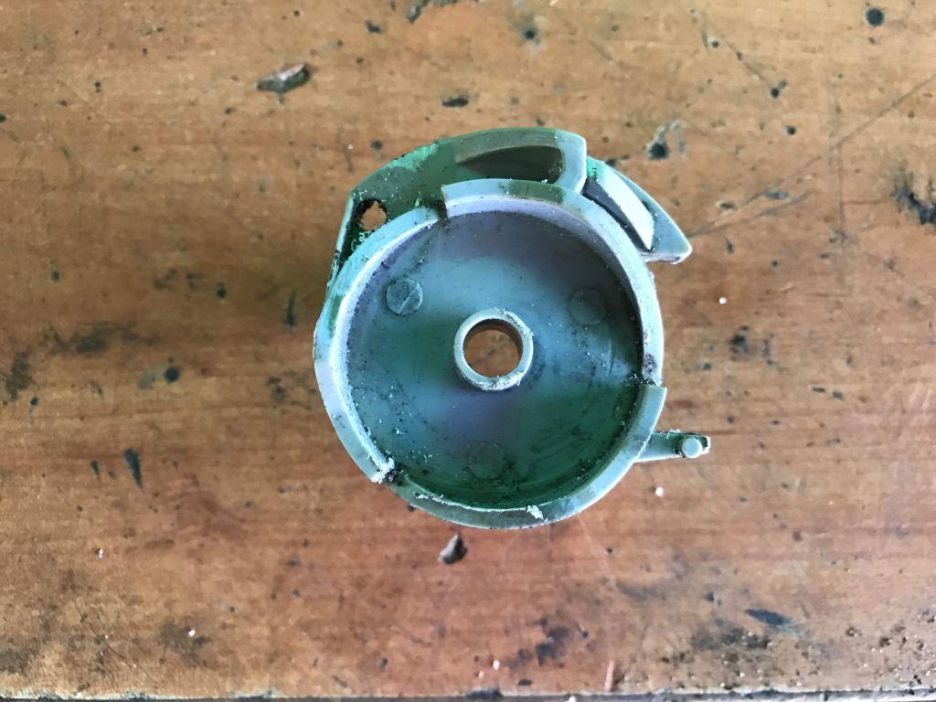

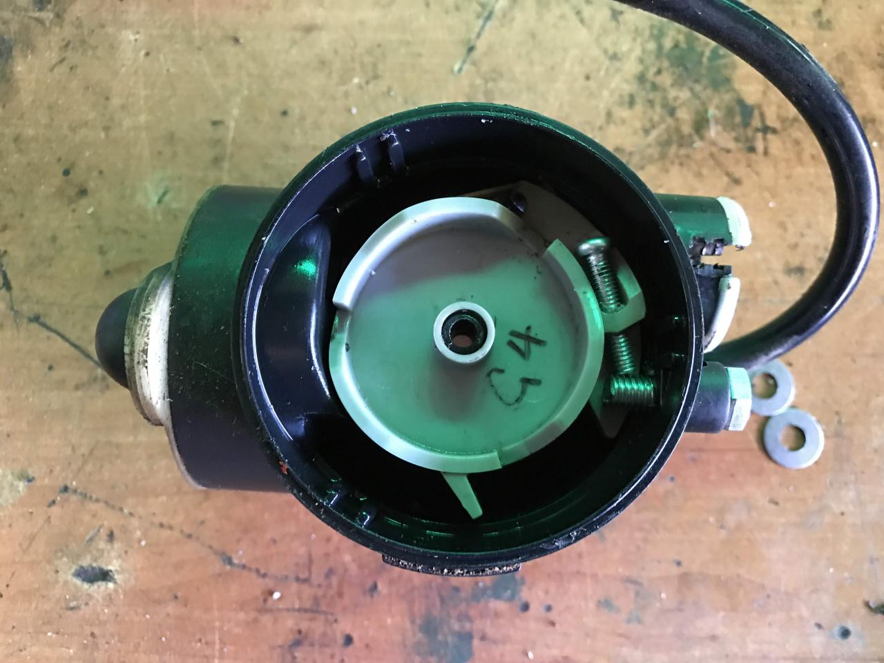

This is how to modify the G4 cam, all other steps from the LM carby modification are required
You will require 1 x 4mm or 5/32 screw and tap
Lifter / Spider height adjustment to the highest point on the cam and no further
1 member likes this: RedCurls

Another mod I did on an LM today, because the owner wanted to retain the kill switch was to drill and tap through the kill switch ramp on the cam in the same manner as I did with the G4 cam and this then allowed me to adjust the kill switch position and prevent it from running up to the flat on the top of the ramp and becoming stuck which results in having to pull the carb apart to free it up again. So far it is working well

Hi John, I usually start them on full throttle then back it off but I find they will usually start pretty much anywhere, but full throttle is the spot I prefer as it makes sure there is fuel going straight in. I usually give 2/3 primes. You don't have to do the idle screw, just means that if you pull the throttle back fully the motor will usually stop because it will idle down too low. The idle screw just means you can just crack open the poppet to allow it to idle. This can be played with by only fitting 2 washers under the cam, but this usually keeps the revs too high for my liking, when you are emptying the catcher etc. You can use the existing kill switch but I found them too problematic and this is probably because all the aftermarket kill switch rubbers are not fit for purpose, I was spending way too much time trying to get them to work only to have them play up. The most annoying thing with the whole setup is the lump on the cam that once the lifter goes over the top into the stop position it often becomes impossible for the throttle cable to fight the spring tension and get the lifter to rise back up over the hump. Cutting the hump off gets rid of this problem but then you need to put the washers under the cam to lift it up to the same height as to what was the top of the hump. If Victa had just kept the hump height all the way, none of this would be a problem and the kill switch setup would have probably worked fine. The big problem is the cable has to fight going back up over the hump, fighting the spring and break away from the kill switch rubber which can often jamb all at once.
