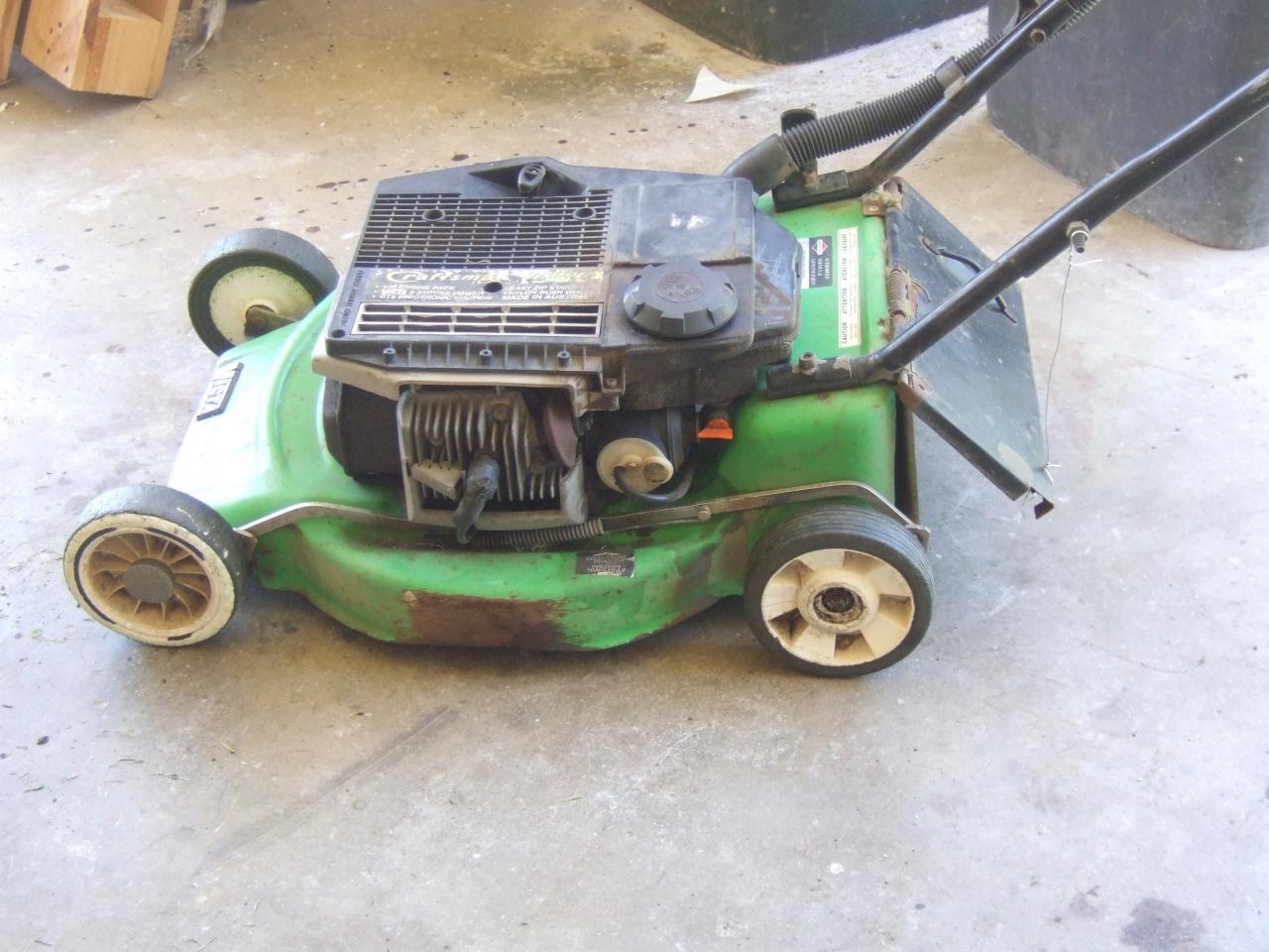

I did up my Orange Power torque and mowed some oarsome lawns..........
Anyway sunday she made a big bang and smoke came out under head.......I cleaned it off prior to pulling it apart and found a 3cm piece of head gasket.
Thought I would check the head with some 400 wet and dry sandpaper , on a piece of glass, kitchen window. It ground down very quickly so there was not any big warp.
Put it together and mowed the front lawn, then it seemed tp loose power, but I could get it back by riggling throttle, so it's the carby.
Changed the carby with 2 new o rings on manifold. . It kicked a bit bt now it's a pain in the A frame.......
I have ordered a few of those carby primer bulbs , and i will fit new ones....
I should have used a proper socket handle to tighten head bolts.....
It needed o rings as they were stuffed, so it's progress.
You just need heaps of spares to try out.................

I am not sure if this is the right place for this. This is my first attempt attempt at putting a question on this site. But I have a Victa Power Torque and I cannot get it to start at all. I have replaced all the 'O' rings as per the manuals and videos I van find. there are no leaks in the carby. The mower ran before I did the 'O' ring replacement but now it will just not start! There is spark(new plug). I am wondering what else I might try yo get this thing to go.

I had another go at trying to get this thing started and with a new needle (orange) from the local mower shop, it actually started!!! It even responded on a hot start attempt after it had been running for awhile. I did this ages more times and it did not miss a beat so hopefully I have got it to where I want it, it's going!!
