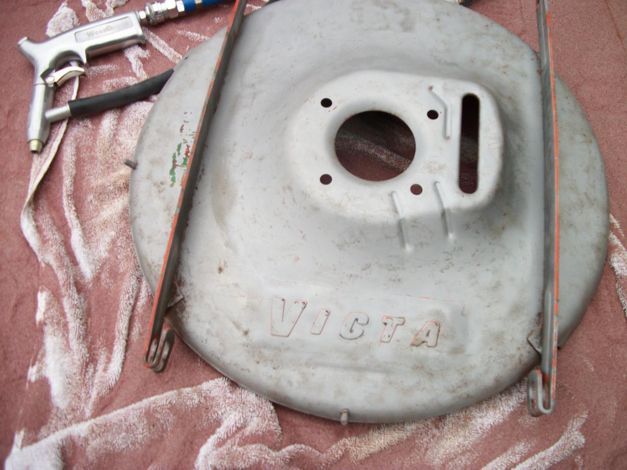

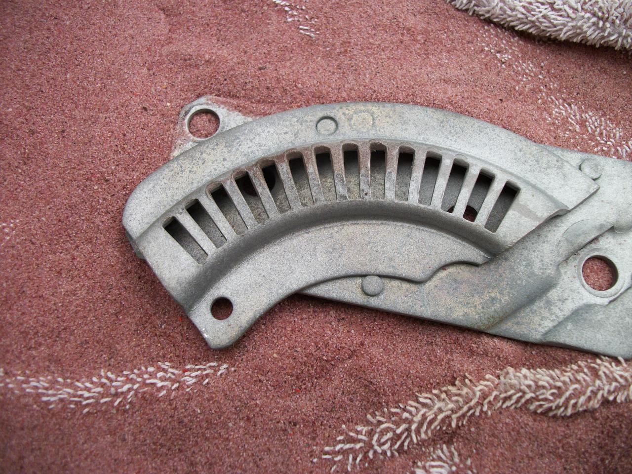

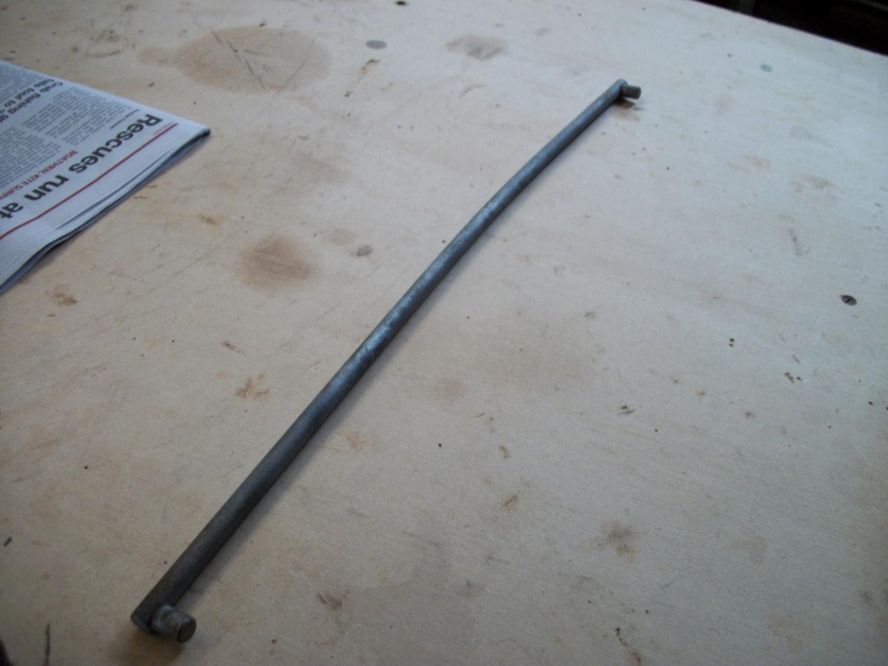

Started restoration on a Victa Utility today. Started sandblasting old paint off base and other components. Still a bit to go yet with the sandblasting. Was wondering the best way to straighten the axle rod which has a slight bend in it (see photo)? Will keep regular updates of progress. Thanks in advance for any help. ![[Linked Image]](https://www.outdoorking-forum.com.au/forum/uploads/usergals/2015/12/full-9226-25674-100_6007.jpg) ![[Linked Image]](https://www.outdoorking-forum.com.au/forum/uploads/usergals/2015/12/full-9226-25675-100_6013.jpg) ![[Linked Image]](https://www.outdoorking-forum.com.au/forum/uploads/usergals/2015/12/full-9226-25676-100_6015.jpg)

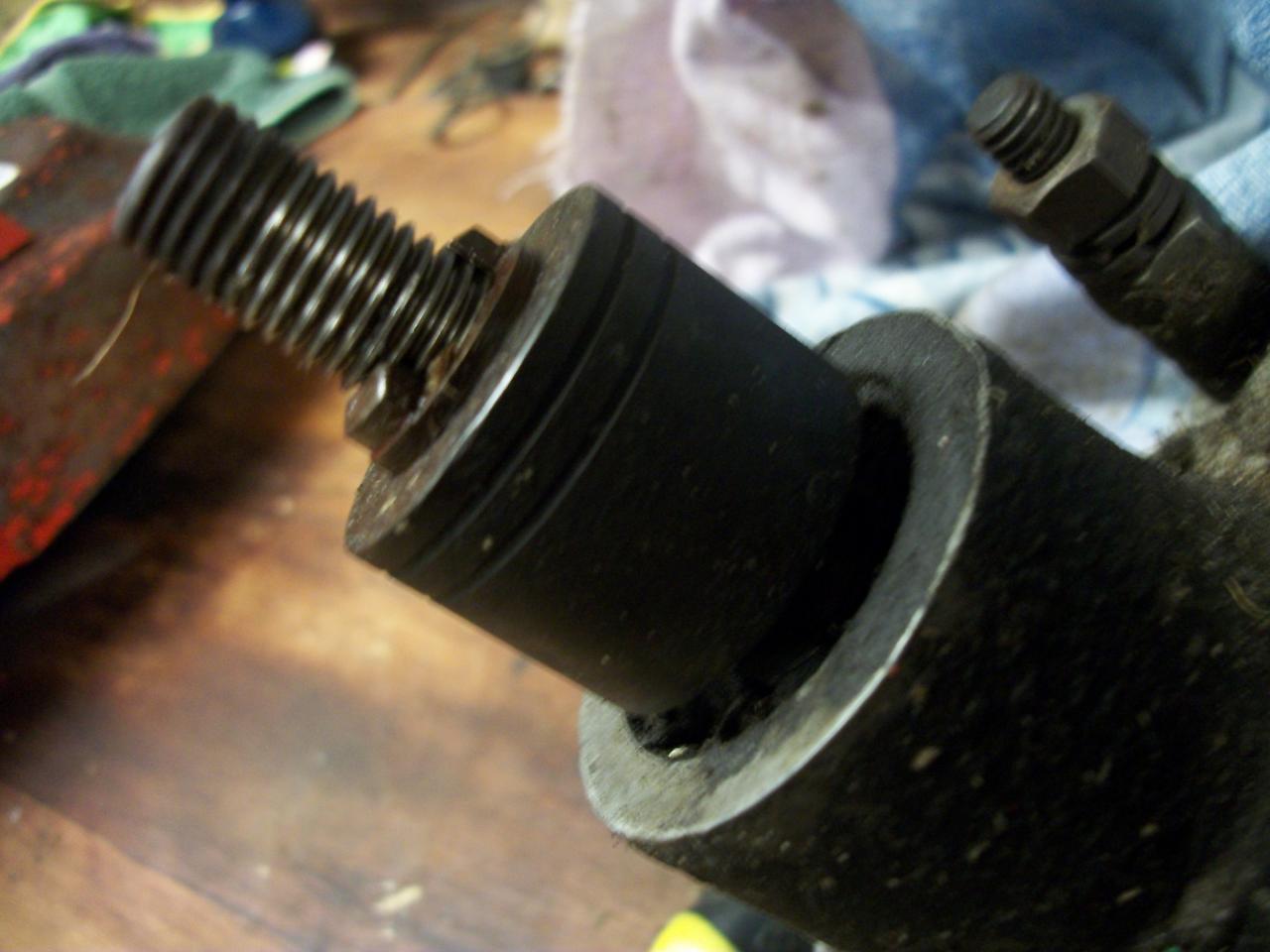

Would any one know the easiest way to remove the blade boss without causing any damage to the engine? One other question, would any one know the original paint colours for this mower (handle bars, base, etc) and what type of paint to use (original paint name and/or paint code)? Thanks in advance for any help. ![[Linked Image]](https://www.outdoorking-forum.com.au/forum/uploads/usergals/2015/12/full-9226-25756-100_6021.jpg)
Posts: 1,842 Likes: 14
To remove the boss, lay it on a hard, solid surface [an anvil is ideal, or the side of a club hammer head will do], and give the upper side a smack or two with a steel hammer. That will pop it off the shaft taper. We really need some pics of the engine, cowling and starter to date the mower accurately, but it looks like a mid-late 1970's Ute, as it has the modified crankcase half for the bottom seal protector disc. Have a look through the Victa catalogues of that era HERE for an idea of colours - the Utes stayed with red base and cowling and cream handles for the later 70 Series mowers, once the Zip Start system came in, in 1972.

Great, thanks for your help/info. came off real easy. In the process of getting the remainder of the engine apart. Cheers!
Good show; that's the only easy way to get those Victa bosses off.
Now, as regards that height adjuster link, that bend may be intentional.
On some Victas, the [upward] bend is needed so that the link is still clear of the deck at one extreme of the height range. The low end, in this case, if I recall correctly.
Easy enough to check, with the axles and link assembled up to the deck.

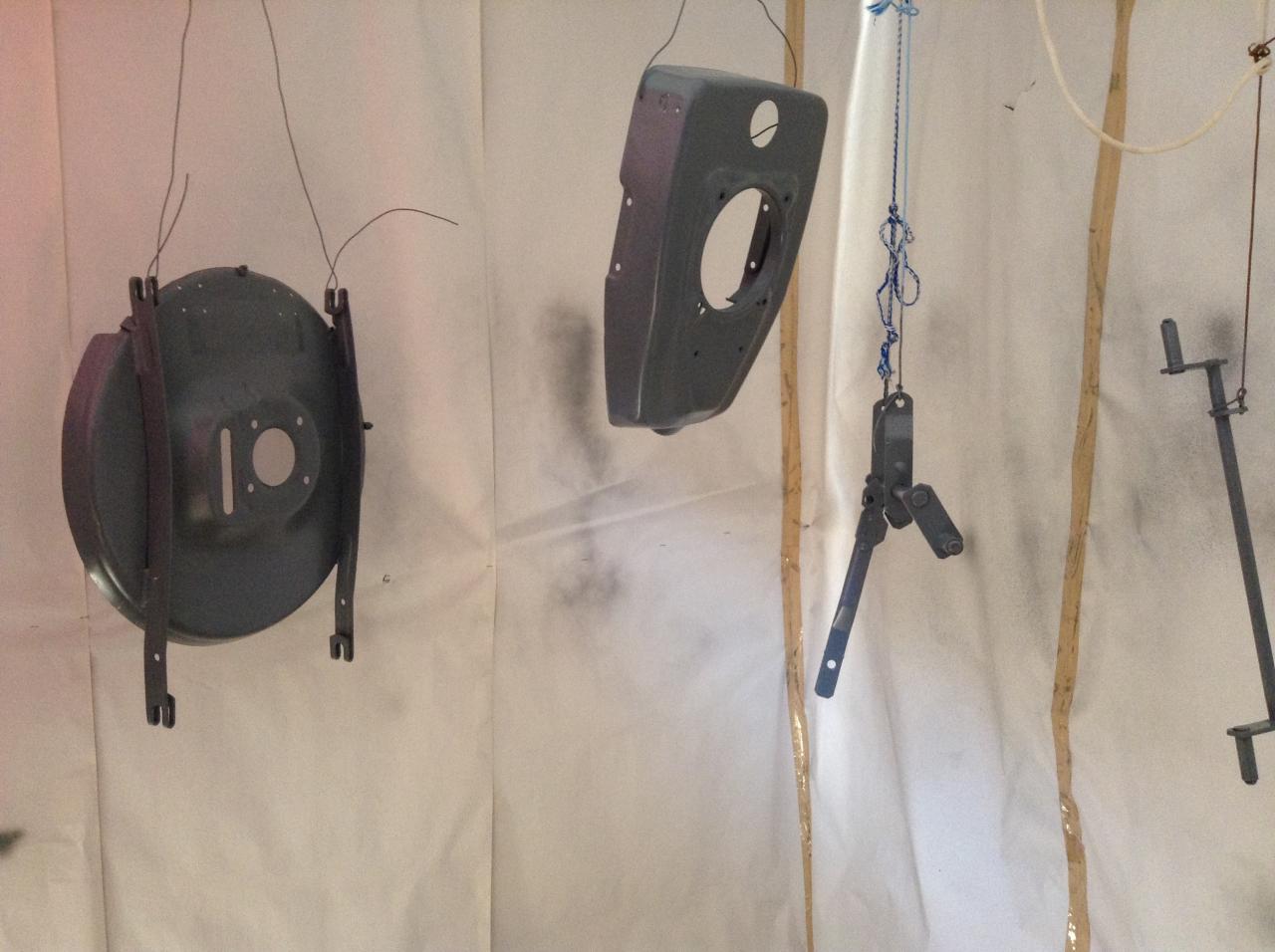

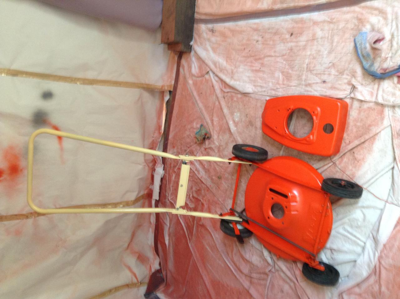

I am in the process of redoing my 125 as well. Good Facebook site for parts is vintage lawn mowers buy swap and sell. For coulor victa didn't actually keep records of specific couloirs but I got a close orange, Duplicoulour Chevy orange as an engine enamel at supercheep auto. I also got their Australian export classic cream for the handle. To do the lettering I just hand painted it with a very fine brush and some black rusk kill. For the bent rod some gentle pressure in a vice should fix it. ![[Linked Image]](https://www.outdoorking-forum.com.au/forum/uploads/usergals/2017/02/full-10921-32672-img_9442.jpg) ![[Linked Image]](https://www.outdoorking-forum.com.au/forum/uploads/usergals/2017/02/full-10921-32673-img_6653.jpg) ![[Linked Image]](https://www.outdoorking-forum.com.au/forum/uploads/usergals/2017/02/full-10921-32674-img_6647.jpg)
