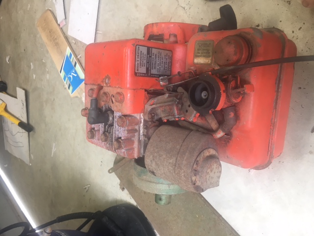

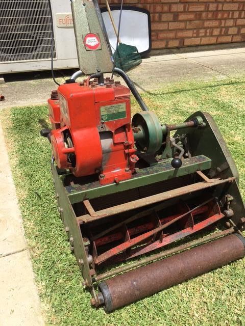

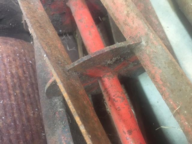

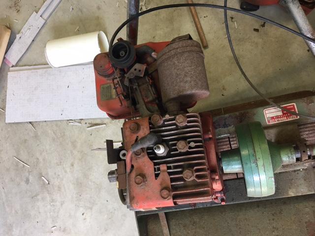

This beauty has been in my Dads shed for the last 16 years since I pulled the motor off it as I was inquisitive. Looks as though most parts are there, just missing the air cleaner screw & the ones for the deflector plate (there was just nails sitting in these). The screws that hold the pull starter on are rusted but should be easy to replace.
The plan of attack is to ensure the engine still runs before getting too carried away but will then look to get it sharpened (any tips for Adelaide would be good)
Plan for the engine is to replace the air filter, spark plug & oil. Will then give the fuel tank a rinse and put fresh fuel in. Will give the Carby a clean with degreaser. Anything else I should be doing before starting? When it last ran, I had to tip a bit of fuel into the Carby and then it would run fine, not sure what needs to be done to fix this.

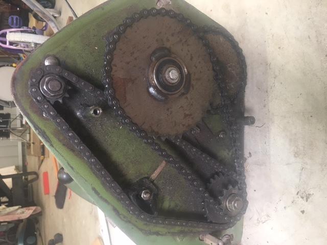

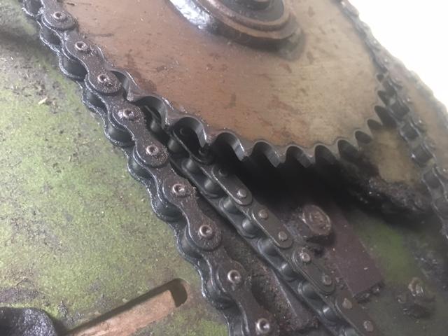

Once I can confirm the engine runs, I will then look at what else needs to be done. Does it look like the chains are all ok or am I best to degrease/pressure wash them and re-lubricate? If so what should be used.

Well anyway that's actually a pretty good one with not a lot of issues from what I can see.
I really like the can of "Start ya Bast%#d" there in the background !! but we here at the ODK can't endorse this method of discipline to mowers.
Sadly its suffered a dose of the rusty's, but that's not that much of an issue at this point in time.
You are absolutely spot on in attaining the engines current state before continuing on any further.

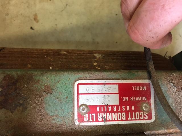

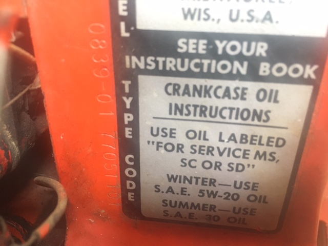

Your engine was manufactured on the 11th of May 1977 so your mower would probably have been assembled around August / September of that year.
I'd say that as your engine starts when petrol is tipped directly down the throat of the carburettor tells me it doesn't have the ability to pick fuel up from the tank, thus the carby and tank will have to be separated and all the old fuel gum cleaned out through the pick up tubes.
Your drive train all looks good from what I can see.

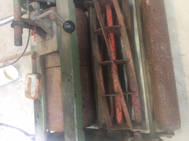

As far as reel grinding and bed knife replacement / grinding, there's only one place I would use here in Adelaide and that is Steve Rose at "Australian Saws and Blades" which is located on Research Road Pooraka. Steve does all the major bowling clubs around South Australia and also plenty of interstate reel work. There's nothing he doesn't know.
BTW many of the Lawnmower shops around Adelaide send their Reel Mower work to him but have the customer believe that they are actually doing the work themselves.
You will have to purchase new reel bearings as that's the secret to having an accurate grinding job done (Steve would tell you this anyway before he does the work) as the bearings that are used on the mower are the ones that are used for spinning during the grinding process, thus replicating what's going to happen in the mower itself and perfect mating to the bed knife.
BTW plenty of meat left on your reel as it looks as if it's probably only ever been done once before.

Thanks BB for the reply. All going well, I will take the Carby & fuel tank off this weekend and give them a good clean up before reassembling and crossing my fingers.

It starts and runs (not all by the book)
Went out and bought new fuel, oil, spark plug and air filter. Drained the old oil and refilled, pulled the carby off and gave it a clean with degreaser, rinsed the fuel tank a few times with clean fuel and then put it all back together for the big moment.
Tried starting it for 5 minutes with no luck. Tried the old trick of taking the air filter off and tipping a bit of petrol in and it fires first go. Once it started it ran no worries. Ran over the lawn but unfortunately I had already cut it this morning pretty low so couldn't take much more off.

Any tips for not having to tip fuel down the air filter hole?
Hello Robbo
Assuming the engine is in good condition, the first point of
call would be the diaphragm that pumps fuel from the tank.
This is a pulsa-jet carby.
