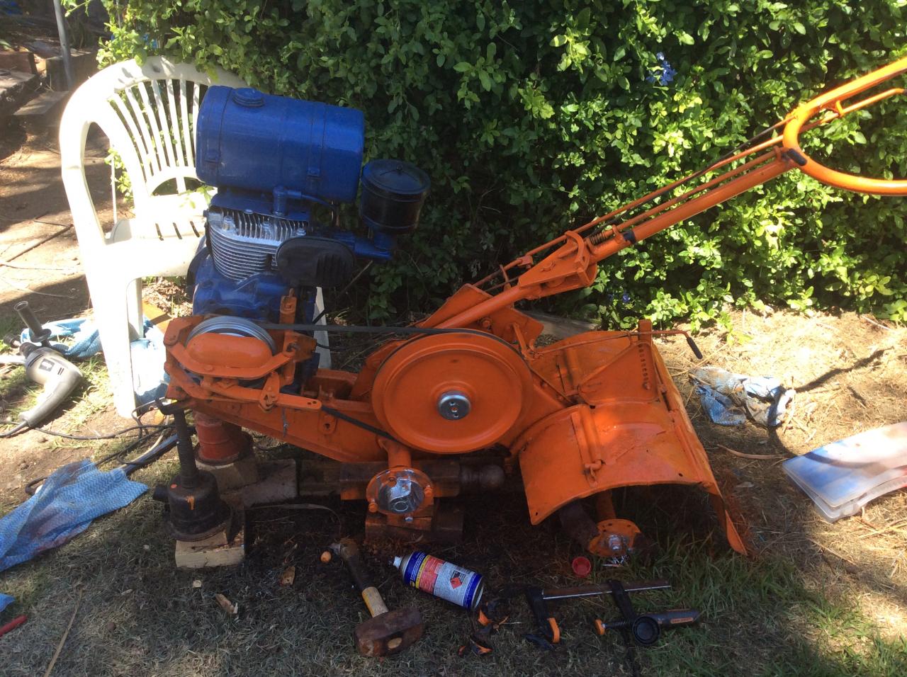

Hello all. Here are some pictures of my current project a howard 350 rotary hoe that has been sitting around for about 4 years with a seized clutch and cable waiting to be restored. The tyres are also completly shot so I have to source them from somwhere. The clutch I have fixed (hopefully) and the cable is currently soaking in kero to loosen it up. The good thing is that the motor still runs quite well. [Linked Image]

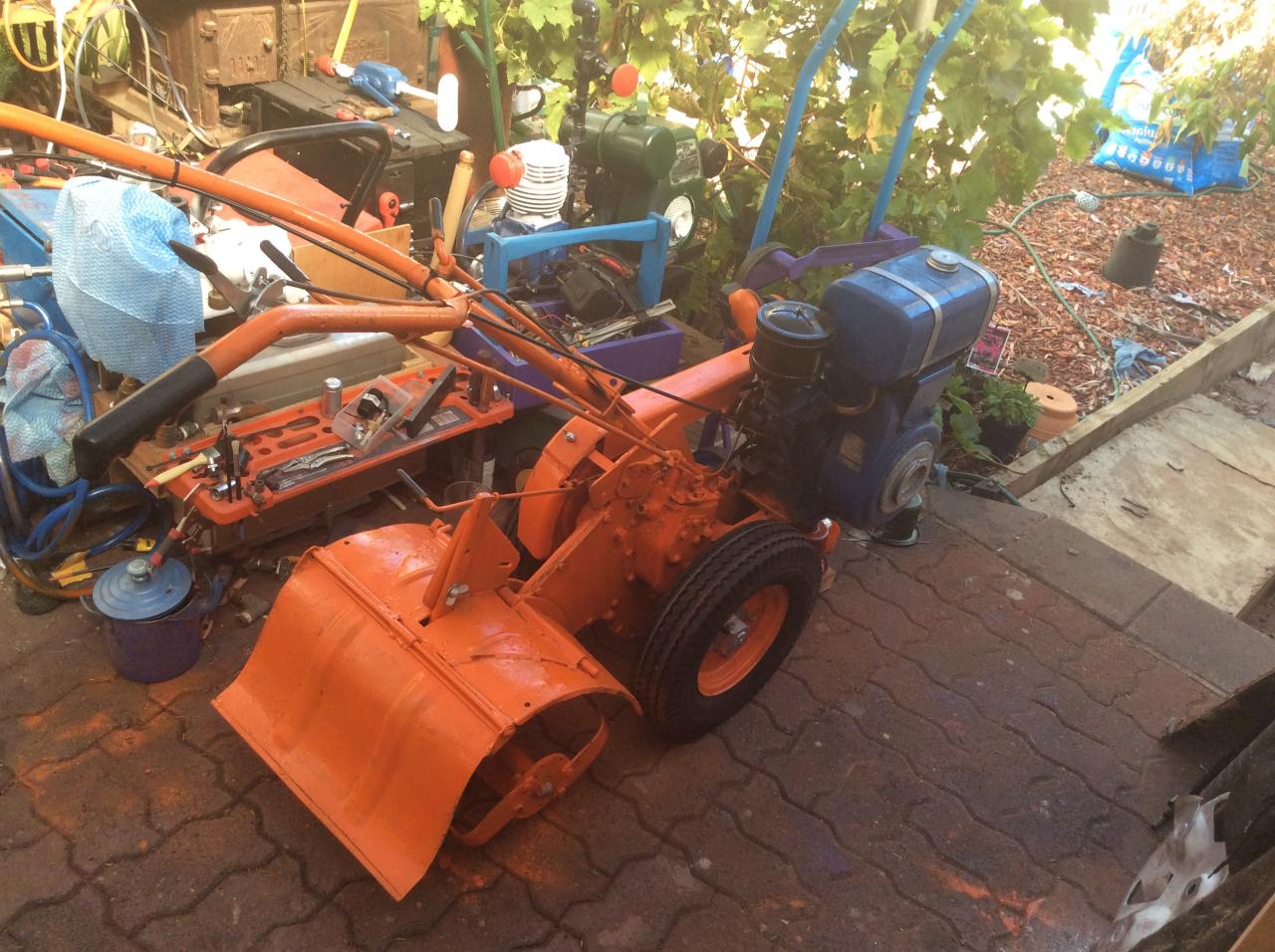

Some more info. I thought I'd take another look at the spark plug and guess what no spark mad So I found another plug that had good spark. Put that one in and fired it up and away it went smile So that problem solved . Still leaves the clutch cable issue. I have got the cable to work but it looks like the clutch has seized up again , so whe I can find some spare time I will strip it down again. It feels like one is going 1 step forward and two steps backwards with this machine. Oh well it keeps one occupied . Here are some more pictures of it

Pulled clutch apart and loosened the 2 cones that were stuck together , reassembled and greased the splines and put it back on. Adjusted the cable and it worked!!! Took it down to the garden and hoed up some grass. Looks like it is going to work now with some adjustments here and there. The manual advises. Putting Lotctite on the clutch screws as they were lose when I stopped it.

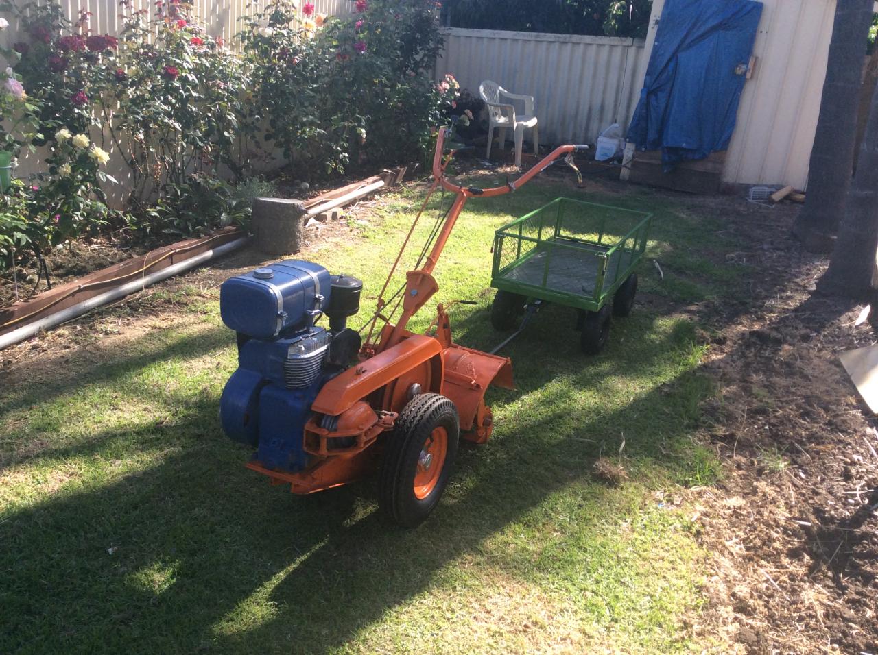

Hello all a small update I have a trailer for it now. [Linked Image]

Looking good, Hermosil.yay
Now maybe for some traction chains for those wheels... https://www.amazon.com/Stens-180-112-Cadena-4-00-x-4-80-x/dp/B001OKBCU2
In all seriousness, a set of ladder type chains will be cheaper than a set of AG tread tyres, even when purchased locally.
