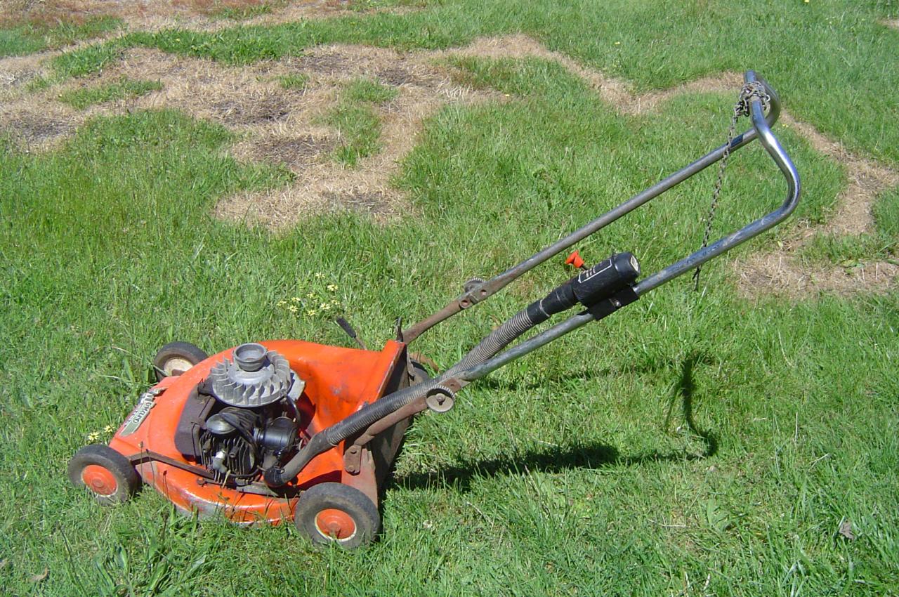

Thanks aussietrev, got it. To other responders, what do you make of this? Looks like a bodgy assembly as the priming bulb is on the inside. I like NormK's idea, not quite sure about the wires, there are two at the front of the carby, one incoming and one to earth. If not this Mowerfreak's idea looks promising.
G'day itforsenior,
As a 1974 season model, that one was of the first model year to have the plastic G4 carby fitted.
These didn't have a primer bulb fitted ex-factory at all, so the one that's on it is a retrofit. The later versions on this chassis used a 'remote primer' setup, so that it could be used!
When a mower fitted with this carby suddenly loses spark, the crude cutout switch is always the first suspect.

Hi Gadge, when I first came across this setup I couldn't believe what I was looking at, I was sure somebody had had a complete brain fade and they had put the carb on back the front, what delusional person could do that, but then I realized the snorkel had been made that way. Not one of the better ways of displaying of Australian ingenuity. Easy fix is turn the carb around the way it should be and run the later snorkel out the other side as all the later ones did.
Back to the kill switch wires itforsenior, with the throttle in the run position, pull the wire that runs through the carby housing at right angles first, then see if you have spark, if not you will have to investigate under the flywheel

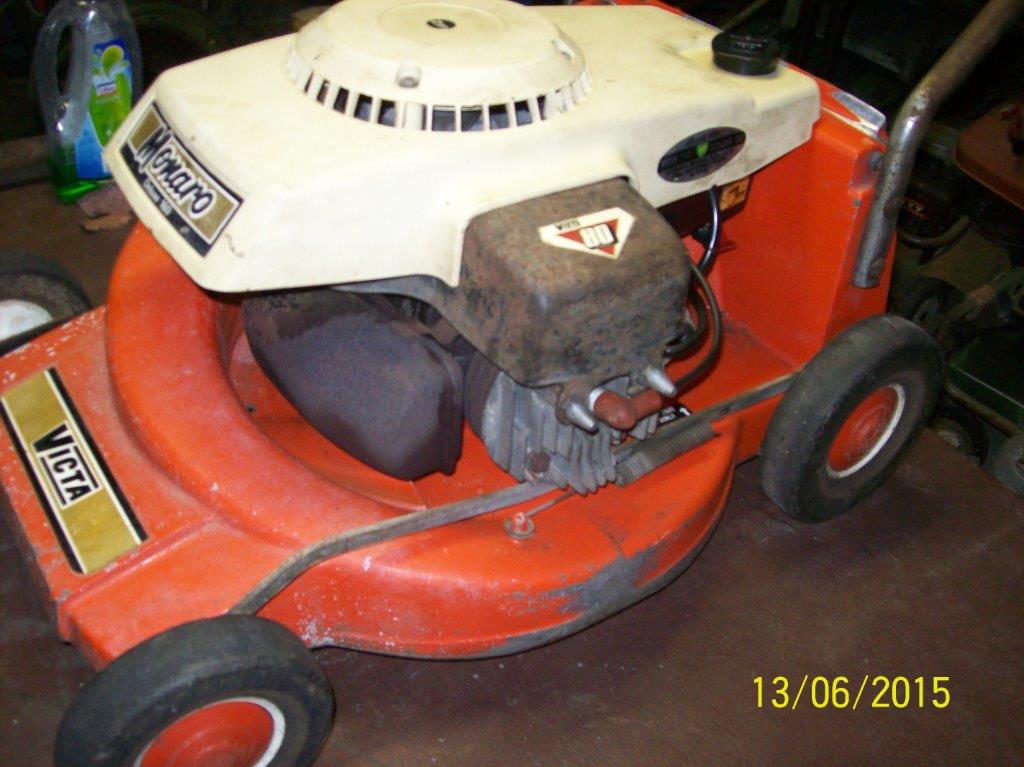

I'm very cursors as to how we came up with a 1974 model as that looks more like the series 80 model Monaro to me.
Like this one of mine.
I'd like to know what the engine number is to get the date of it.That would be good to know.
Quote from OP:
Engine is Series 70, 2 stroke, Mk4.
Agreed, but the carby/snorkel setup is consistent with a Series 70 too.

It has a series "late 80s" red throttle t -bar!!
Nice Monaro Blumbly. I never would have guessed a series 80 version came out. They really strike me as a 70s mower through and through.
I sold one on Ebay over a decade ago. Now wish I had held onto it.
That's true, but its LHS mounting is obviously original - there would be a tell-tale punched hole in the RHS of the handle if it had been mounted there. As it is with the 80 series.

Hello Blumbly, here is a number for you. A sticker on the throttle control shows Model SH267*5---cannot read 4th digit. Can you nail it from that?
4th character would be A - 'SH 267 A5' corresponds to a 1985-86 'Tiger High Arch' model.
Which isn't consistent with the LHS snorkel fitment.
For a definitive answer, we need the actual engine number. Which is stamped on the side of the crankcase, on the carby side. So you'll likely need to squirt a bit of degreaser around to see it.

Does 04854 ring a bell as engine number? 1985-86 sounds like the right vintage. If my machine does not match any standard model it may have been cobbled together from parts by the repair shop I bought it from obviously second hand. I cannot believe the priming bulb on the inside on a production model!
Yep, it begins to look like you have a bitsa there.
Anyway, unless it has been retrofitted with a solid state module, it will have points and condenser under the flywheel. If disconnecting the cutout switch doesn't restore the spark, the points are the next thing to look at.
Service info download for this is here, section 1: https://www.outdoorking-forum.com.au/forum/ubbthreads.php/topics/54967
The points gap should be set to 0.020" though, for your engine.

This one was the same with the primer bulb on the inside and the snorkel out the left hand side. I just turned the carby over and ran a later snorkel out the right hand side as they should have been done in the first place. I'm tipping these snorkels must have been left over stock from a previous model that Victa wanted to get rid of so they used them up on these. I had to cut out the cowl to put the snorkel through
