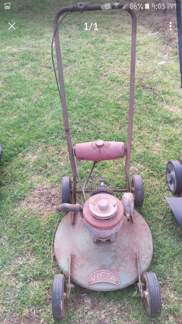

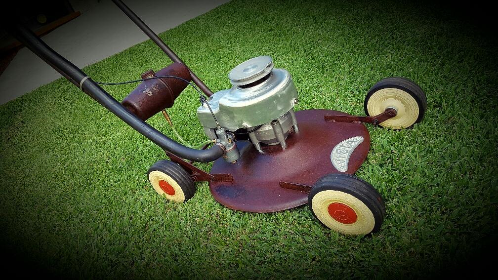

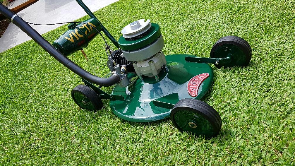

This is my newly finished mid run (47000) model 2 Rotomo
Ive been working on it over the last few months and Im realy happy how its turned out.
I found it on Gumtree. Ive seen mufflers sell for more than they were asking so without much info or hesitation I snapped it up.
Once it arrived, I gave it a good clean and did some research on here about the serial number. Every thing was original and only bits missing were the wheels, snorkel and choke. A quick clean of the carby and points and she was going again.
I found a correct set of tin wheels a few weeks later, which when they turned up had no rust and only a few small dents which was great. I also brought a sad face choke I saw on fleebay. The rest was in good condition, the base had no flat sides or cracks and the tank wasn't rusty inside. At work we have a cabinet blaster and paint booth so Im lucky in that reguard. Many lunches were spent blasting, priming and finally painting in 2pack Deep Brundswick. I also made a new set of axles and brackets.
Most at work thought I was mad for high filling the underside, but it had to be right.
Over the weekend I finally got the chance to finish her off.
I think it came out great and runs like a dream.
The engine was also fully rebuild. Light hone, new rings, bearings, seals, carby stripped, cleaned and resealed, new Bosch spark plug, ht lead and the ignition was given a good clean up.
Im still on the lookout for the correct throttle and straight snorkel but for now it looks great and starts 1st time evey time.

The 'classic' side view image(above) is sensational.

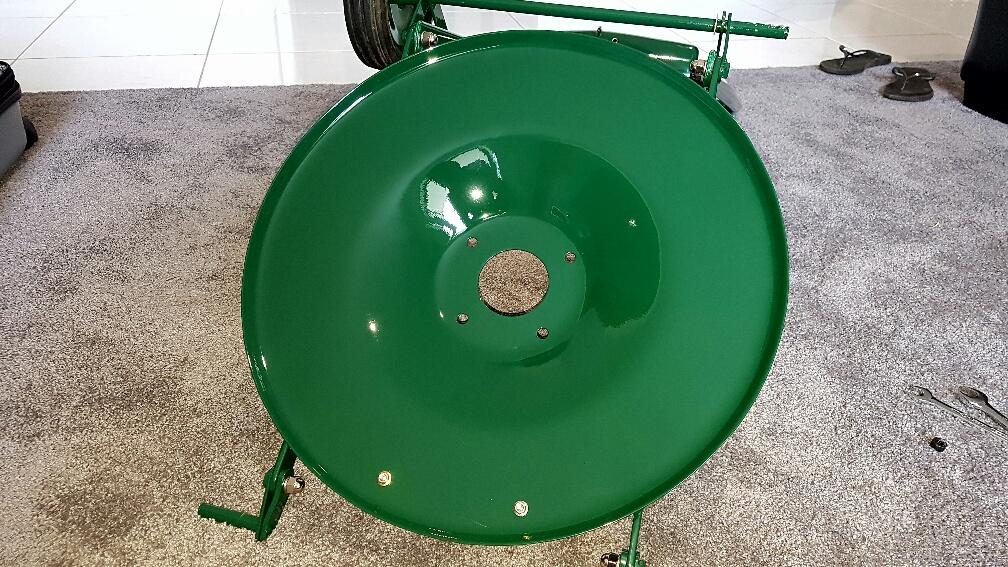

Any chance we could see the blade disc?

It was built in the lounge room, however the mrs wasn't as keen as I was to leave it there (funny that), so its in the shed with my other 2. I haven't done the cutter disc yet. I do have a couple of the 2 holed ones though. I just cleaned one for the test run
Could anyone tell me the colour of the disc? I was thinking either the same green or a satin black. Id prefer it to be right though.

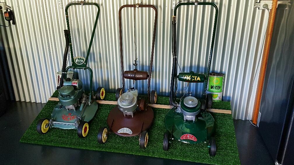

These are a couple of shots of my other two.

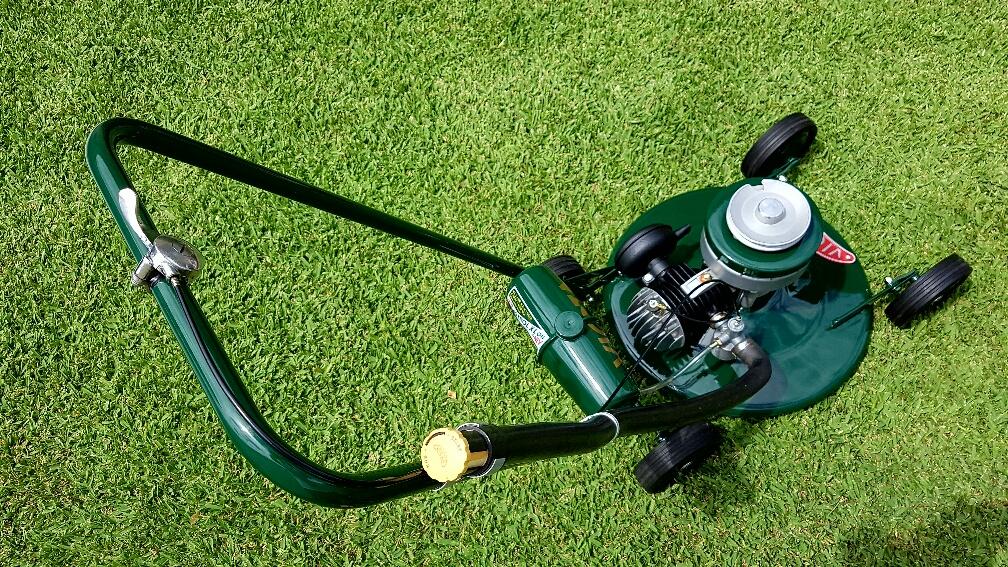

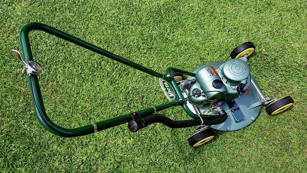

This is my mid model 5 series 1. Full restoration, new wheels and an original badge

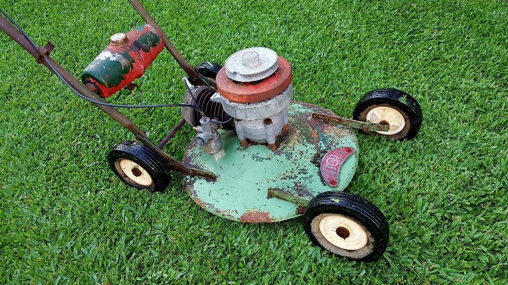

This is my model 2a replica. I brought the base and handle off a guy at work for $10. I wasn't sure what I would do with it but who cared for the price. Its been acid dipped, rubbed with penetrol and that's it. The engine is a model 3 which was rebuild but only acid cleaned, not blasted to keep it looking untouched. The rest of the bits Ive picked up along the way.
My little stand I built for them along with fuel tins
Here they sit in my shed with my vintage Tonka collection.
My wife says I have OCD, but Im not convinced.

You know how to decorate a shed with such taste. Your wife should be proud.
Gees, I could never understand the popularity of these primitive looking machines, being obsessed with the modern looking hi arch mowers from the 70s and 80s, but your post has me wanting one as my own.
I have some evidence the production bladeholders were painted the same colour as the base: HERE.
However service spare parts may have been a different colour.

I'm no expert but can tell you that the remaining paint on the underside of my model 2 blade holder was pretty much the same as the colour of your deck in the second photo (avocado green ?).
