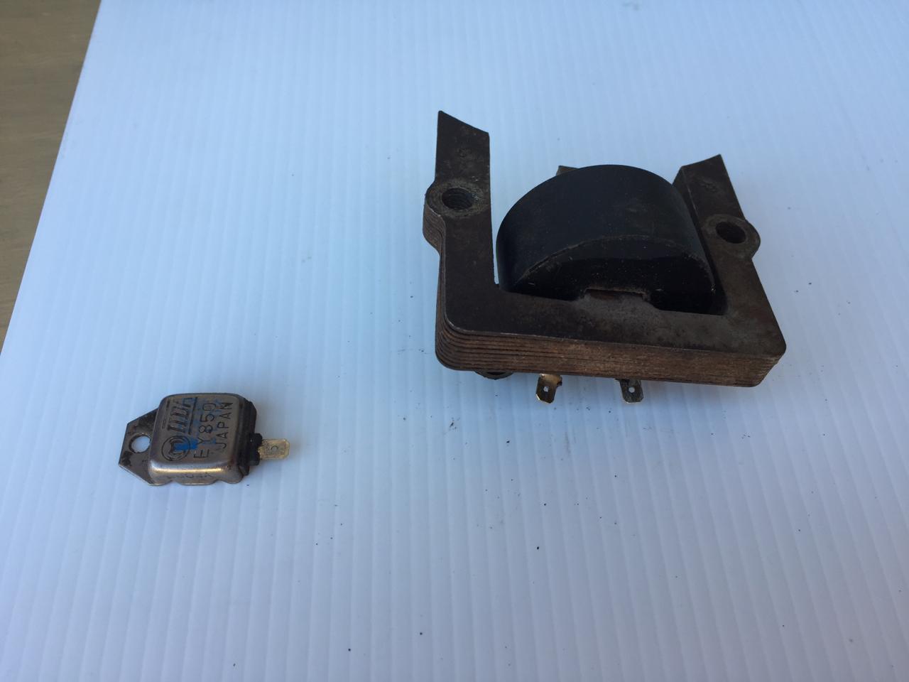

Engine now professionally re-built and installed, but still cant get it to fire. Carburettor has also been professionally rebuilt and have new decompressor valve.
There is still no spark when plug placed against engine.
I have attached a photo of my coil on mower, and ignition module. Could someone please advise exactly how to wire correctly as if looking at it, together with relevant earth points. I am certain I have wired it incorrectly. [Linked Image]

Perhaps, someone could draw the correct wiring on photo and re-post it?
Posts: 8,086
Likes: 220
Did you try it with the module wire on the right hand side coil terminal, that is where it has to be, the way you had it the wires were back the front

HI Norm-
good news- I have a strong blue spark! thanks
