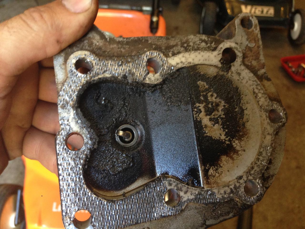

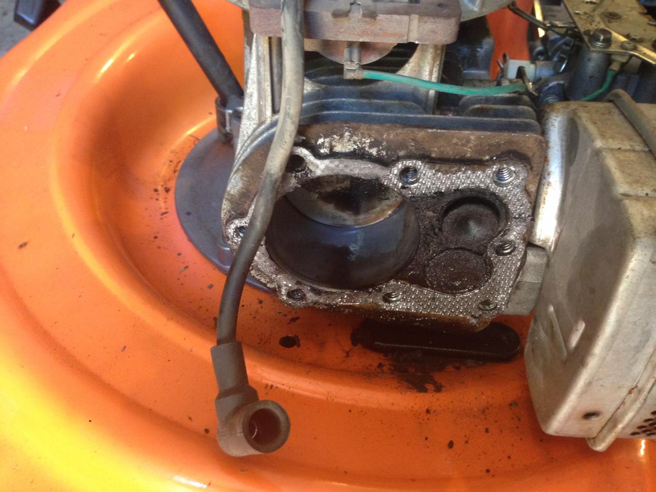

Posts: 445
I was hoping you guys might tell me I missed something.
I ended up stripping the engine back and taking off all necessary parts because of a heavily scored bore. The bore had deep grooves. Before I dismantled the mower I pushed it through some long grass and it started to knock so it was well and truly dead.
