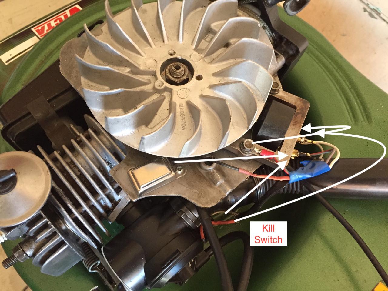

here is a photo of my wiring- did I do it correctly?
Posts: 8,086
Likes: 220
Have you tested the decomp valve to make sure it works and was it connected when you were attempting to start it?. I will need to check the wiring on one here to see if it is correct, but I think it is

is the wiring correct please?
Posts: 8,086
Likes: 220
I think your wires are back the front on the coil
