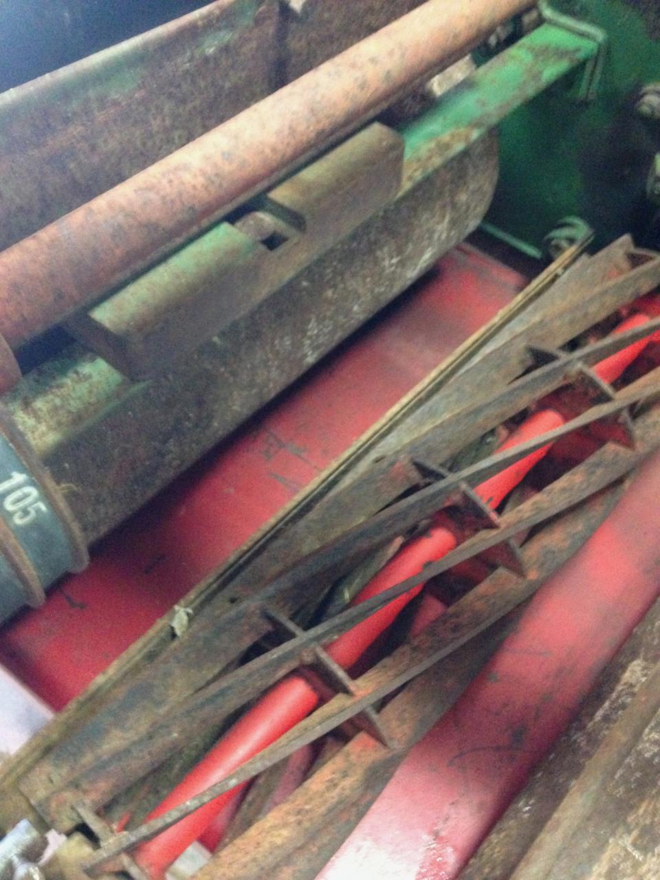

Thank you for your support. I have made contact with Grant at silensmessor and he has kindly supplied me with drawings. Crickey! That drum looks complicated. I have made a start and cosmetics are underway. A new catcher will have to be fabricated as rust has taken its toll on the original. I'm pretty certain that I can panel beat the engine cover. The blades look to be in okay condition and the sole plate etc should be salvageable I believe (I'm happy to take advice on these matters but it would appear that spares are pretty thin on the ground so I shall have to go with what I have unless I can stumble across an Aladin's cave.

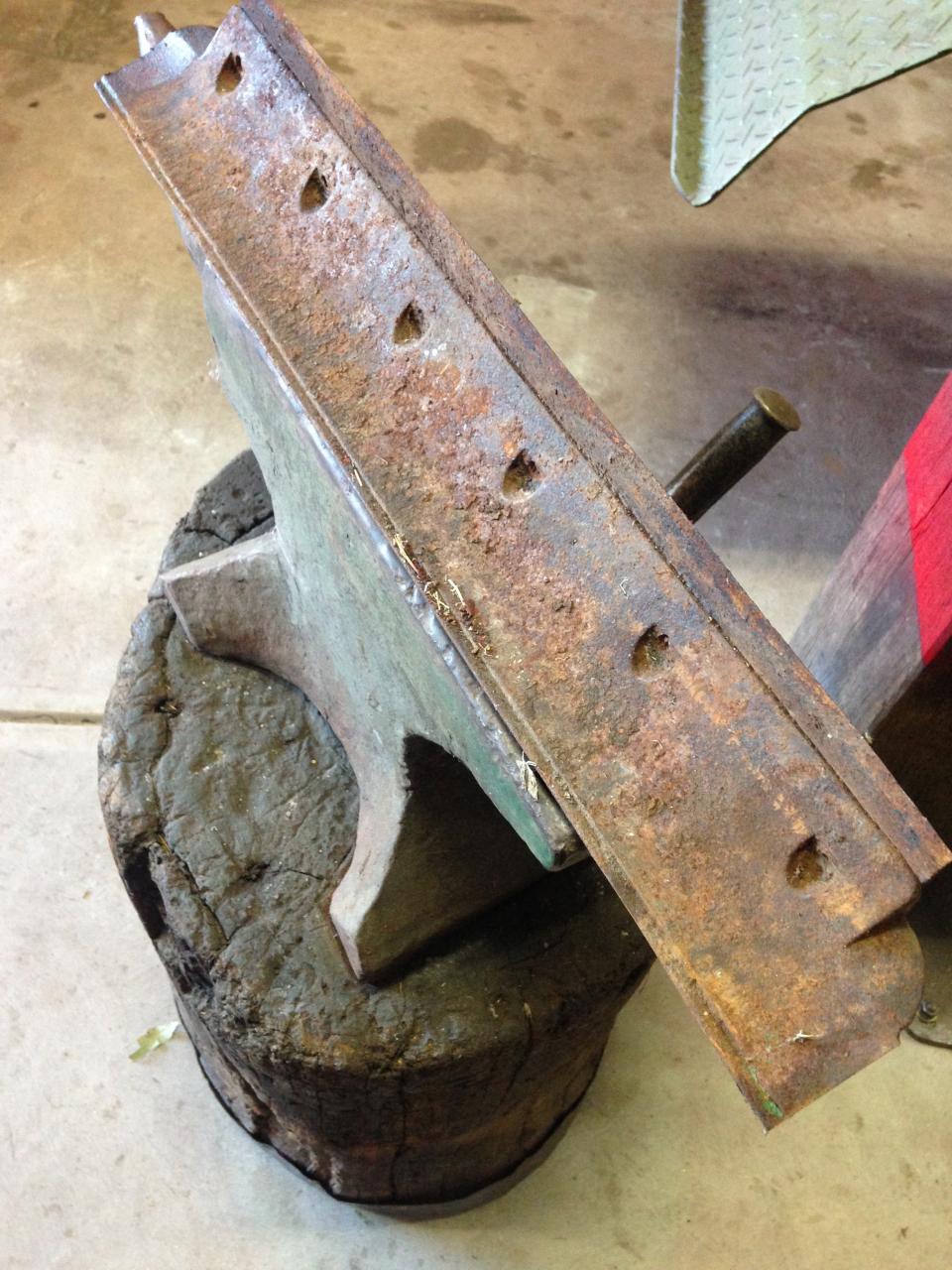

I appreciate the photos, particularly the bottom block assembly
(sole plate and bedknife) and the motor maker's plate. Brilliant!
I'm sure Mod BB will comment here.
The reel is perfect, and a great example of reel-making craft.
Plenty of life there.
For domestic use. the replacement bedknife should not be a shaver type,
but the thicker type, and it should be ground before use to match the
reground reel (fitted with new sealed bearings).

Thanks for your comments, Jack. I spent some time up in the shed today, pondering my next move and spreading even more RP7 around. The last few bolts & nuts are quite stubborn. Is there any particular engineering place (in South Aus) to entrust the bedknife and reel to? Or should I send it interstate? Any ideas? The drum, by the way, appears to be quite free & undamaged so hopefully will present few problems this coming weekend.

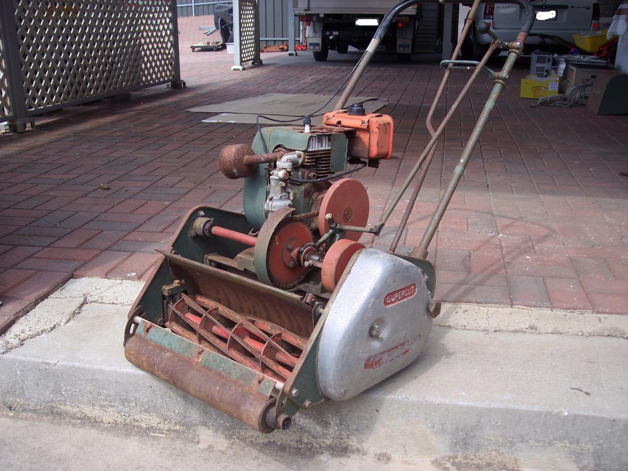

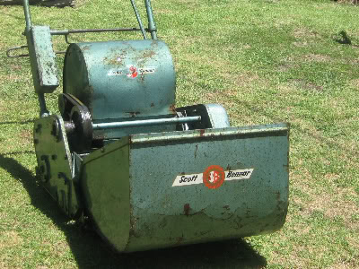

Here's a photo of my Model 17 SC
It has an "A" Grade catcher with it which is the original and I also have the optional Tool Box that attaches halfway down the Left hand side handlebar as can be seen by the witness marks.
This photo shows it with a Kirby HK25 Petrol tank fitted but it's since been retro fitted back to the original Villiers Barrel tank.
Must admit I haven't even removed my reel to date from the SC as I've been so busy with model 45's at the moment, but I'd say you'll require a bearing puller set. They are quite cheap on eBay and will be with you for life as once you start doing this sort of thing you'll wonder how you would've ever done without a set.

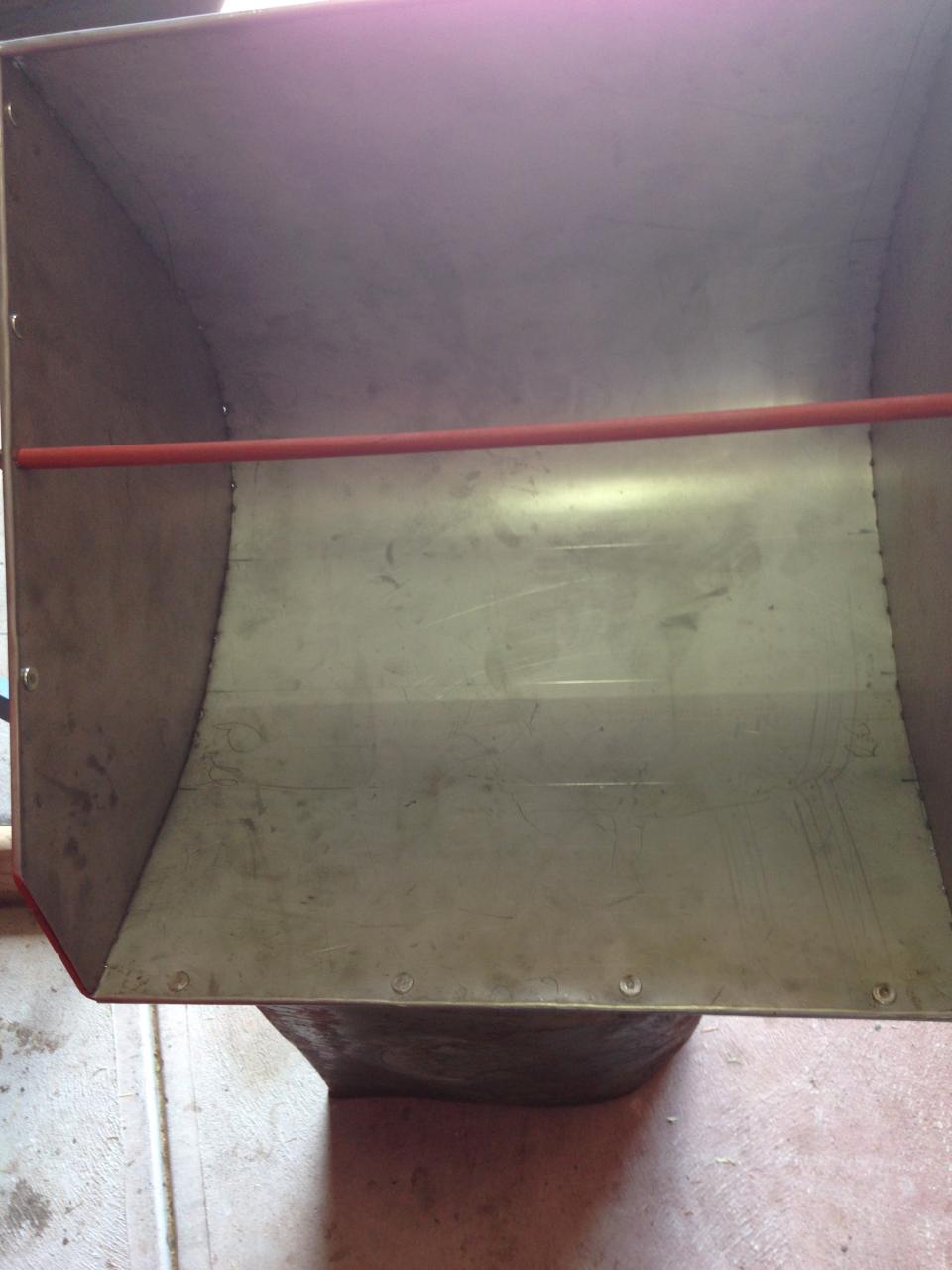

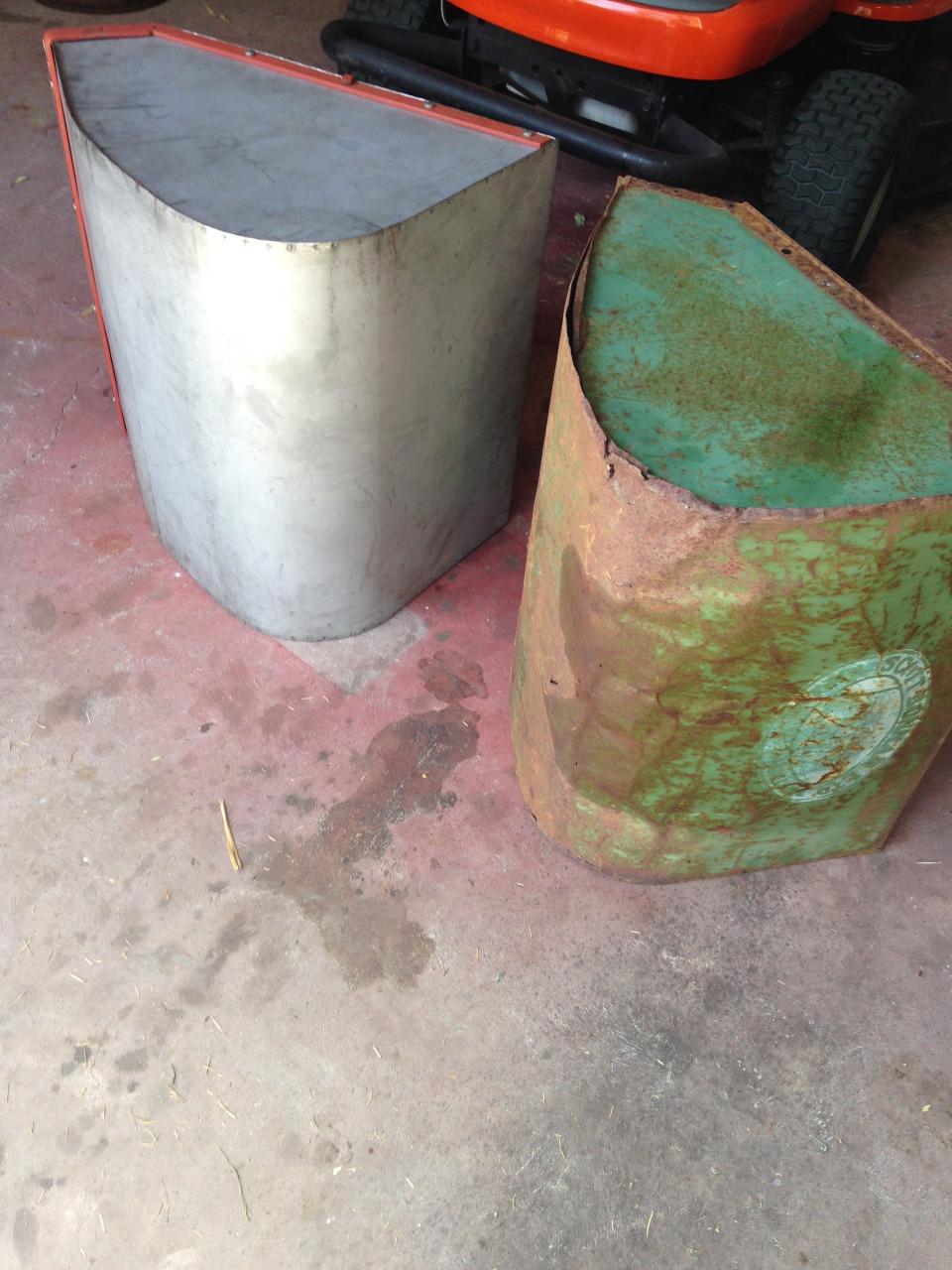

while the majority of bits are in the pickle, the catcher has been replicated (almost finished)
The brass hook attachments are still to be taken back to metal but the body is now finished (pictures below)
the first image tells the main reason for the requirement of a new body
The original cross brace and side braces have been reused
Spot welds and blind rivets used
I have a few brass rivets which will have to cut down but will be used to secure the brass catches where it attaches to the actual mower
aussie

I am compelled to comment on the careful restoration of the catcher.
For me, it is one of the most handsome catchers ever made.

I am very pleased with the catcher & hope that my paint work will do it justice. I intend to take the engine cover with me to Lonsdale tomorrow to see if Lonsdale Paints can match the original colour still inside.

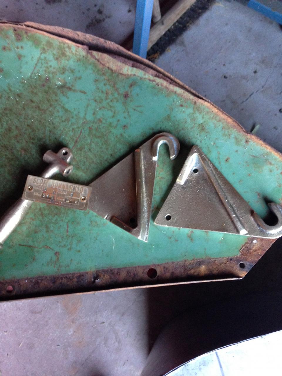

As far as the Pickle bath, BB, I shied away from using molasses as I worried about fine pitting to the finished metal surface, so went with citric acid to clean (while keeping a very close eye on the time in the bath) and then straight into an electrolysis bath using washing soda. The soap neutralises the acid remainder well enough and then its onto the wire brush with thorough rinsing in between. I worried too, about the citric acid which seems to lodge under painted surfaces so the drying and wire brush period is critical, I think, even after electrolysis. The citric cleans the rust & dirt
off pretty damned quick though, doesn't it?
I'm only going on my old car restoration experiences and maybe members have better ideas

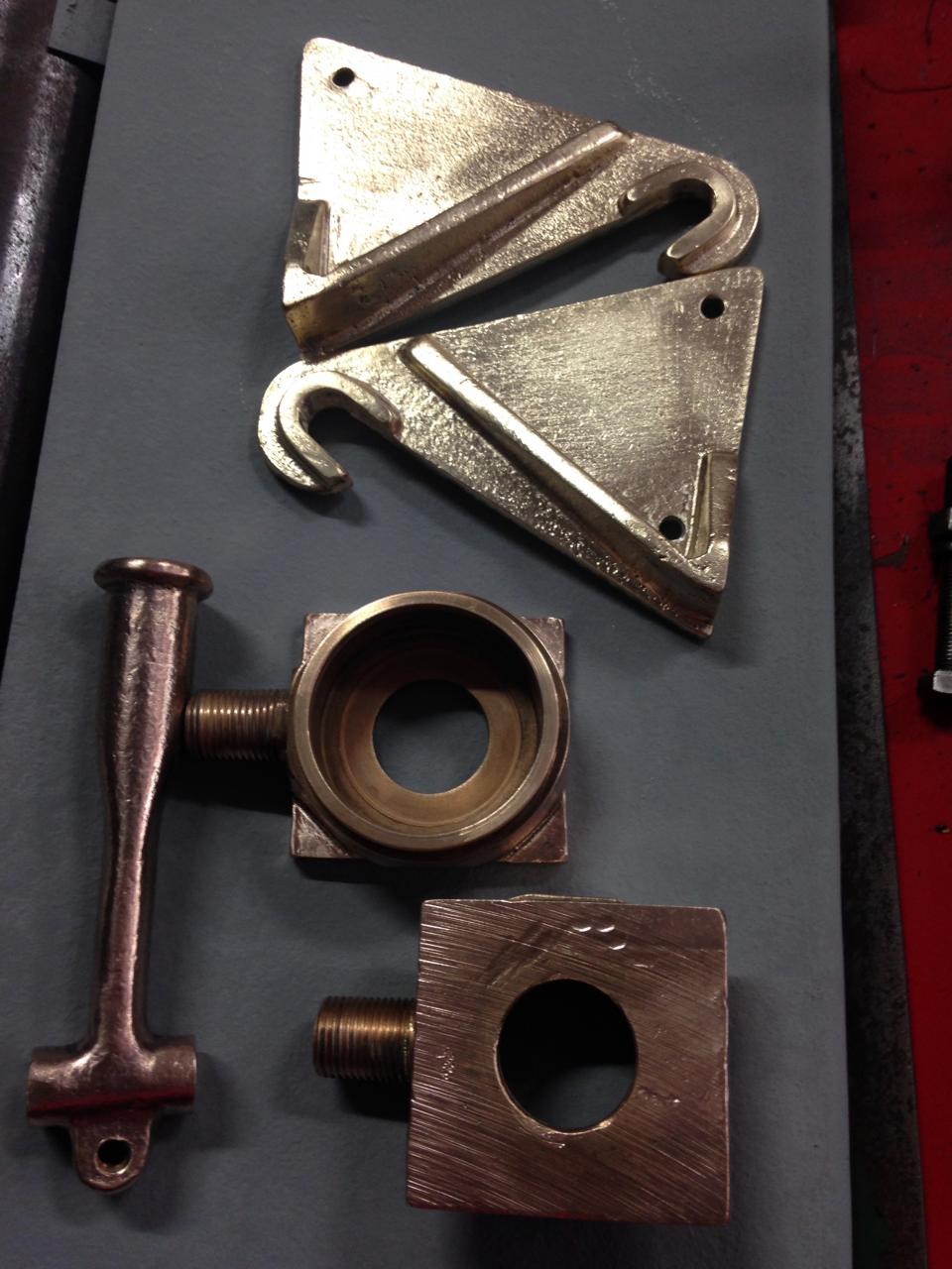

I haven't had a chance to go to Pooraka yet. The reel wont be ready till next week as its in the shed at the moment with current running through it (looking good though). I'll post photos ASAP as paying work now calls - here's one of the brass fittings for the catcher & clutch
thanks for your interest

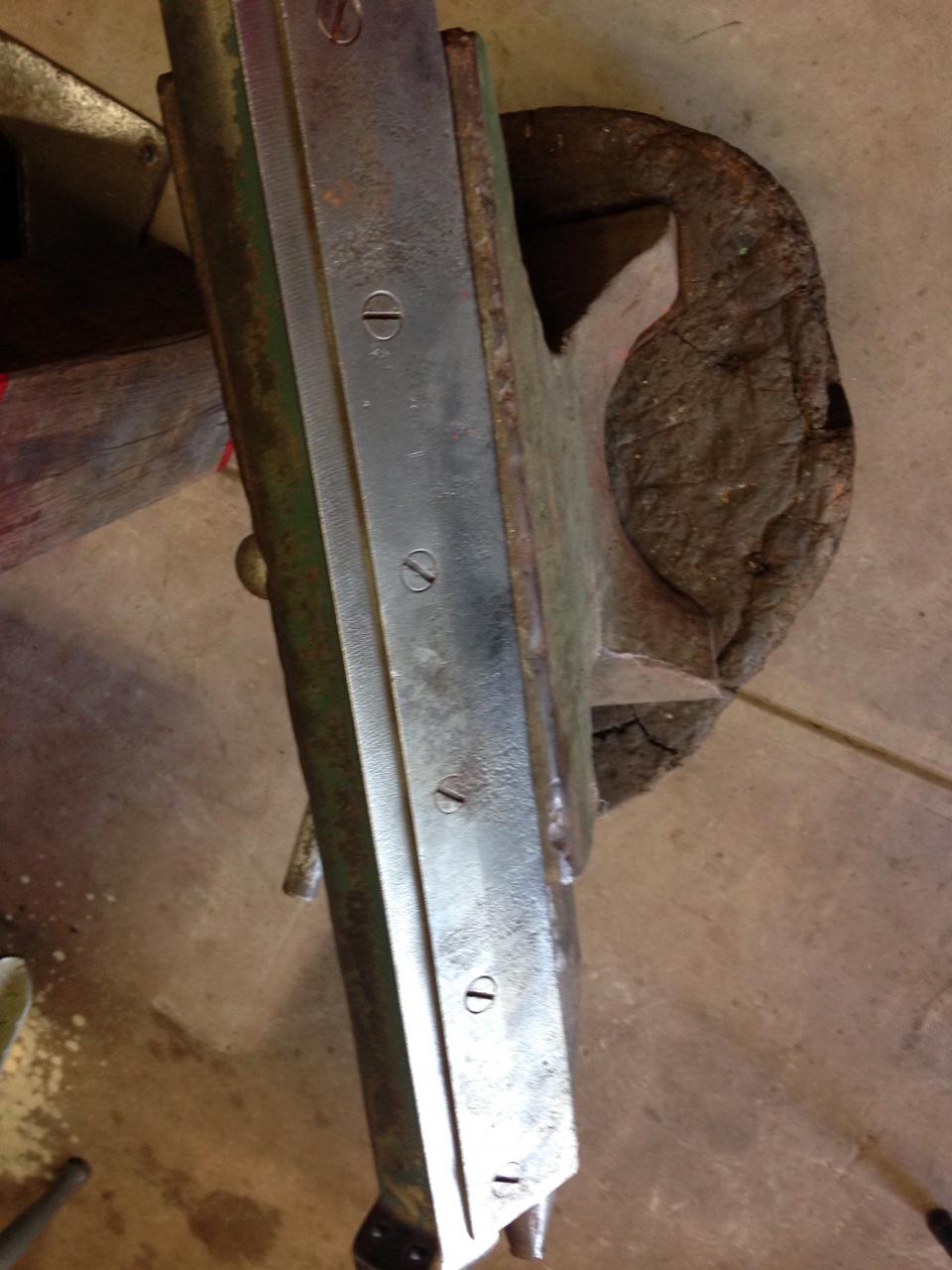

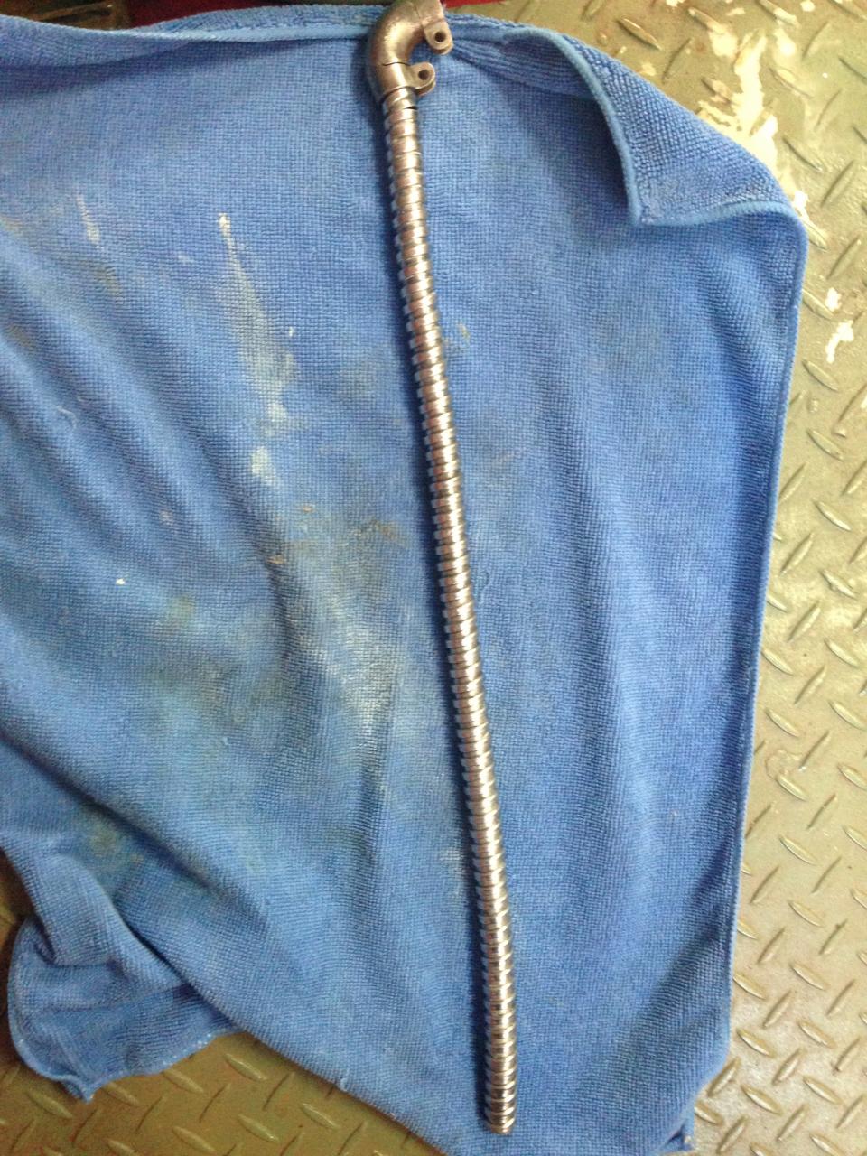

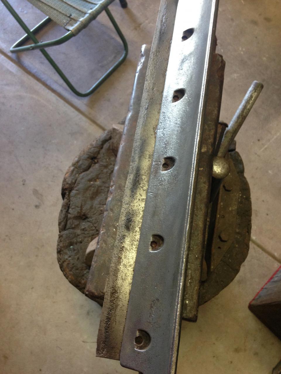

brass is now finished (or as good as I can get) and have added photo of the sole plate cleaned up. Pretty pleased with how the electric cabling has responded to treatment too.
