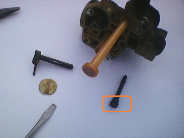

Thanks AVB I have the plastic carburetor. Is there an o-ring in the plastic carb, if so do you just flick out the black plastic cap in front of the main jet or does it unscrew ?

Yes. It is complete nozzle with jet. It is removed as follows: - Remove throttle vane and shaft.
- Press out nozzle carefully using a flat tip screwdriver or similar flat object.
- Noozle is held by snap fit so when pressing back in make it snaps in and is flush as previous seen.
- In following image the o-ring is circled.
Hope this makes sense.
