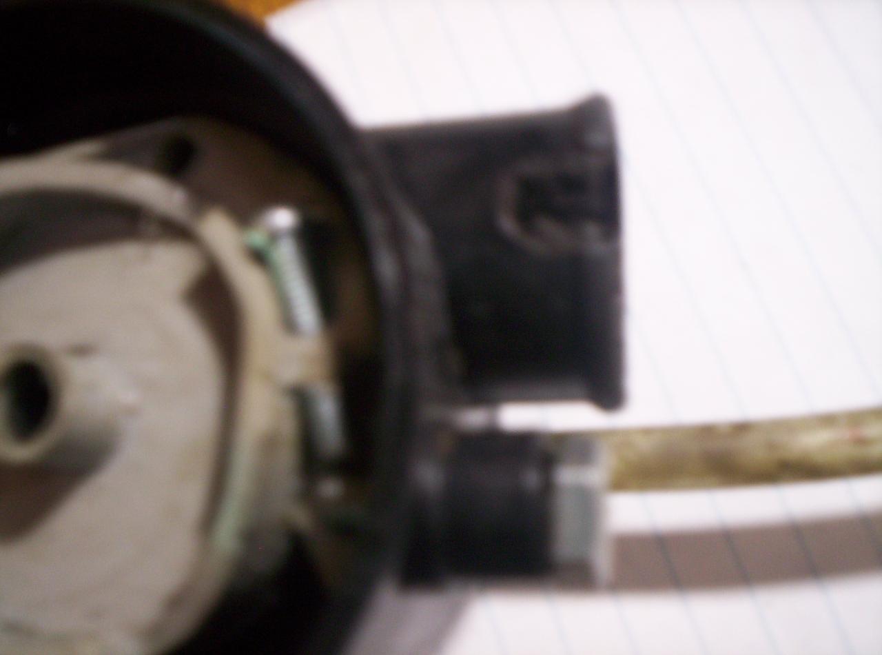

Ok this is just for Mowerfreak, because he showed some interest in a modification I did to bypass the dumb kill switch. This is one I have just done on a G4 on a full crank motor that after wasting a couple of hours with that insane kill switch setup. This is a G4 cam without the kill switch ramp. With this method I can adjust the cam to stop at the top so that the lifter does not drop off the top of the cam into the lower section when it goes to the stop position. This prevents any sticking/notchiness in the throttle control. My opinion of the designer of this bizare setup is not very high, fantastic motor let down by stupid carby design faults.

NormK, Could back off from the carburetor a little so the picture would be in focus and re-post it.

Thoroughly agree. It's hurtng my eyes to look at it.
Does your camera have macro mode? Most digital cameras do.

Sorry, too late again, it is fitted and now working on a mower as it should. All it is is a 6mm screw through the kill switch hole to use as the stop and a 4mm screw through the stop to prevent the lifter from going over the top of the cam when it comes up against the stop, this way I can adjust the screw to suit the top of the cam. With the LM cam I just grind out the ramp with the die grinder till I get the lifter in the right spot, this is a bit more fiddly. I will do another one and see if I can get a better pic, not sure I can though

This pic shows the adjuster screw fitted in the can so that it can be adjusted so the lifter can stop at the highest point and not drop down. Sorry about the pic they look fine on the camera, but once they are blown up here they get a bit fuzzy and I wanted close ups so you could see what I was doing. They work perfectly and will never jamb up again, with smooth cable operation

Thanks , that looks clever. Pity you can't put up a video, showing first hand how it operates. Maybe if I pull one apart myself, I will fully grasp the concept.
