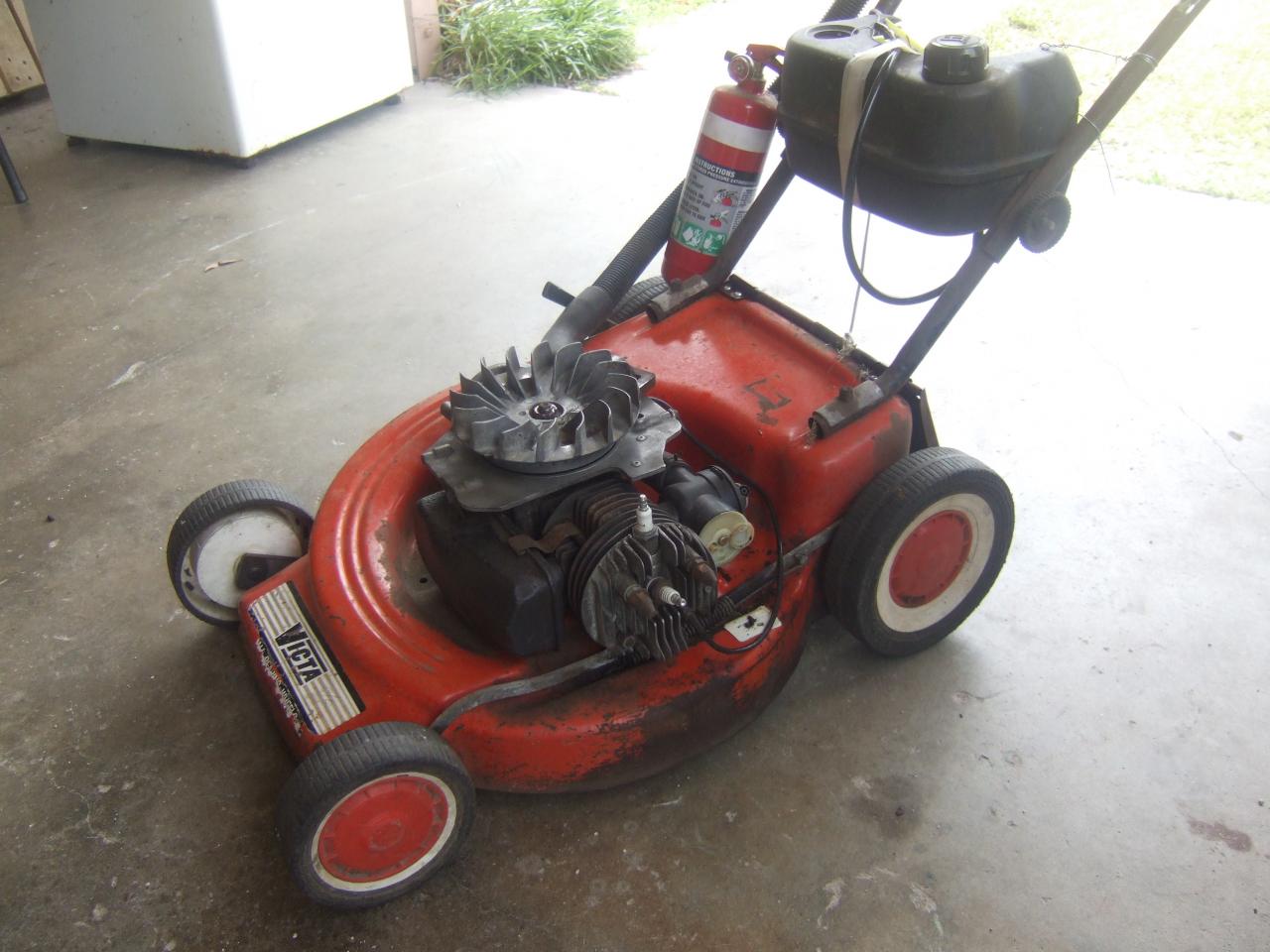

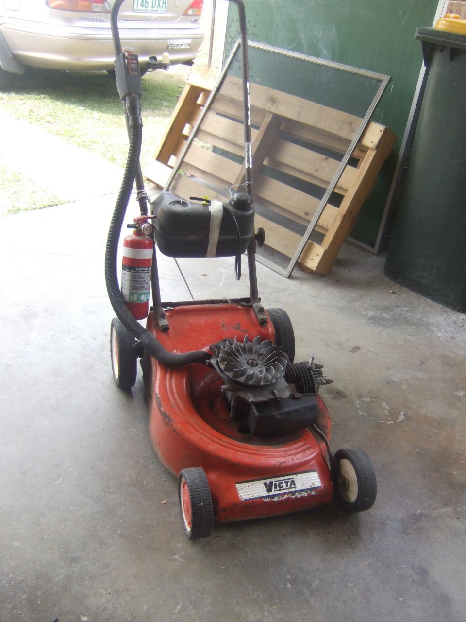

I was given this one in parts with a few missing. I had to put another coil points capacitor plate on . I don't know which item is faulty but it works now.
The carb primer bulb was cracked and leaks fuel , that's why the fire extinguisher is there.I use a screwdriver to short out the spark plug and it didn't look good with a spark and leaking fuel. I have glued up the primer hole, hope it works.
Had to use another tank, but I will have to put a fuel tap inline as fuel as it drains through the catby.
I have to use the electric drill to start it but that's a whole lot easier than pulling a starter that I am missing.

Speedy, 2 stroke Victas are as tough as old boots, give then oil and they will go on forever

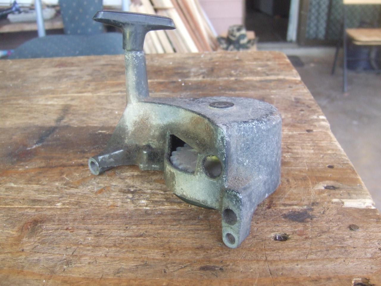

A friend gave a what he said was an old Victa starter, but mine needs the vertical one.
This looks a B and S starter??

Speedy that is a B&S vertical pull starter, what you need for the Victa is a side pull, it bolts on the side of the motor

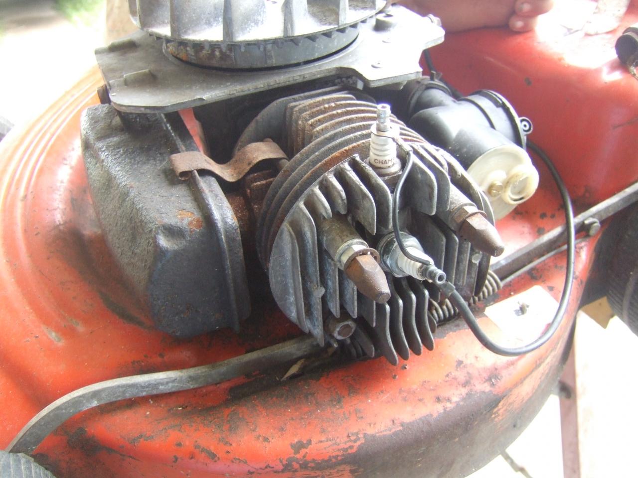

Does anyone think this will help, as the decompressor is faulty.....
More spark........... from 2 plugs [Linked Image]

Posts: 1,233
Likes: 32
That two spark plug idea didn't work, It revved with no control from throttle.

Speedy, the reason it had no throttle control had nothing to do with the 2 plugs, it is because of the stupid Carby design by Victa and that also is the reason it wont start with the other carby off the powertorque. Give the carby a tap on the top and that might make the needle drop, but it is still hard to know if it is priming
