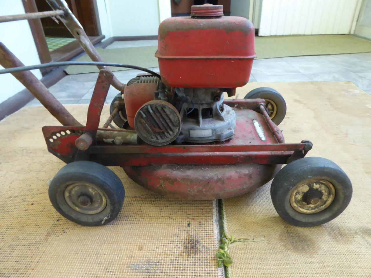

I managed to secure one of these little Walmac mowers, I noticed two things on the build. The height adjuster pull knob and handle bar mounts are identical to my HG Palmer Victa engined mower, possibly from the same manufacturer?
It did a pretty good job for a 37cc engine
G'day Paul,
Thanks for the observations and fantastic video!
Every ad I have show this machine sold by HG Palmer or Eric Anderson.
Eric Anderson bought some HG Palmer stores as Palmer collapsed.
I'm thinking both the Palmer and Walmac machines do originate from
the same Australian manufacturer. But who were they...!
All the best.

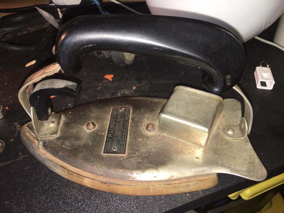

Something interesting I just found, a Walmac electric iron!
Apparently 1930s.
Thanks for reading!
Likes: 304
Hello Kye and Paul
Yes irons! ... but mainly stoves from the data I have.

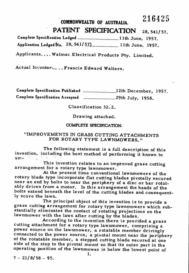

Nice work, love the patent but is "drivingly" even a word?

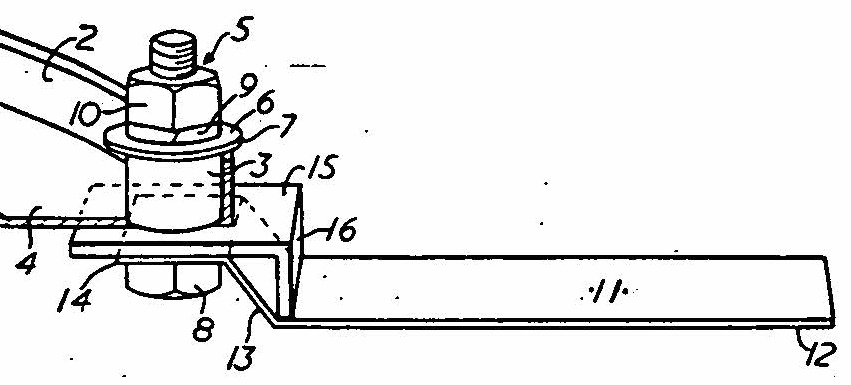

Hi Jack ,Kye,paul,the only other thing I found on Francis Edward Walters was one other Patent.
Likes: 304
Thanks again Max
The good thing about the edging patent is that it names
Walmac Electrical as the applicant.
It would be a fair assumption to say that the Walmac
lawnmower was made by Walmac Electric then.
I note that the edging attachment may have been the one Pace
offered for a while:-

I wonder how the edger worked, the patent didn't read to well.
Likes: 304
That would be an understatement.
The patent is 'drivingly' presenting obfuscation to readers grin
Perhaps Max or other members can make sense of it.
To me it reads as a simple knife cutter.

The Walmac "Improvements in Grass Cutting Attachments" is just saying they have made a blade with a step so the blade bolt head does not rub on the ground,they say with a flat blade the bolt head will
scorch or otherwise score the cut lawn.Also it has a reinforcement bracket so the blade will
not straighten due to centrifugal force and operating shocks.That was how I read it,I was
more interested in the names and dates than the blade.The blade is on the rotating blade plate on the crankshaft.
After seeing the patent you would say the Walmac lawnmower was made by Walmac Electric.
Now we just need to find what the mac stand for .Drivingly: with driving force or energy.
The last picture in the patent can look confusing because of a sectioned view.

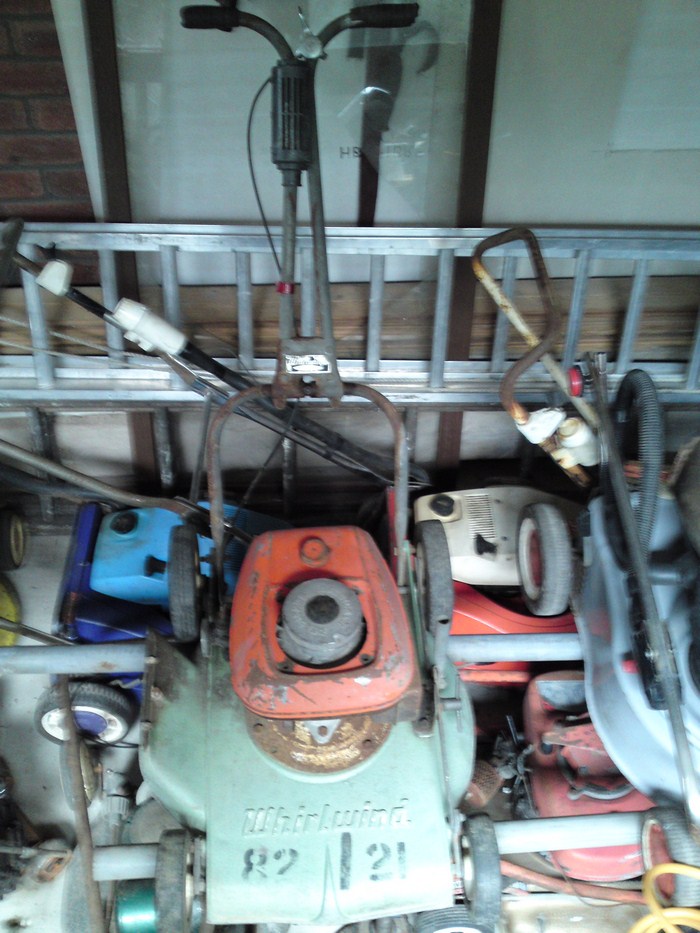

Hello Jack,
Here is a Supa-Swift with a different name showing the Supa-Swift blades,I measured a 1960 steel
Whirlwind base and compared it with a Villager base and all the mounting points for the height
adjustment were the same,the height adjustment controller is different and the center pressing
in the base has a slightly different curve radius .The Villager base has a patent so I would
think both bases were made at the same company.The pressings of the bases are the same except
one curve in the centre.Thought it was interesting that some mowers share the same base.
Thanks for the picture of the 1959 Supa-Swift,the blade plate looks different to later models.
